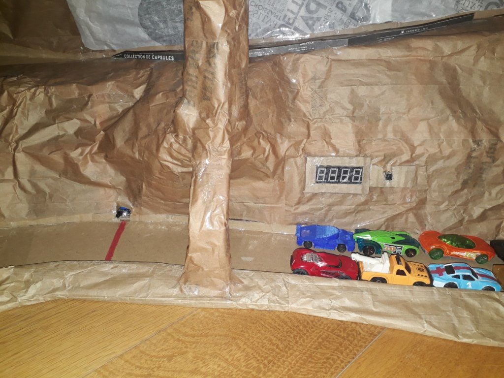

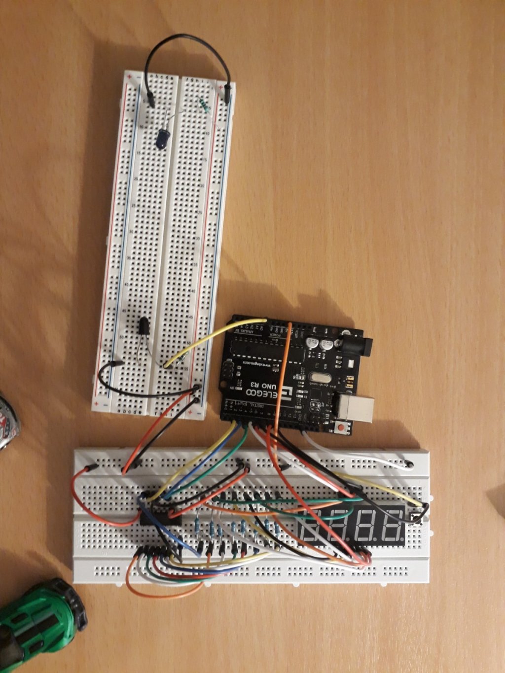

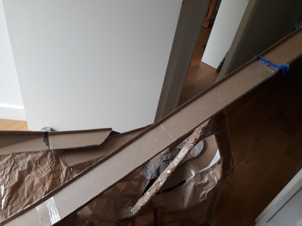

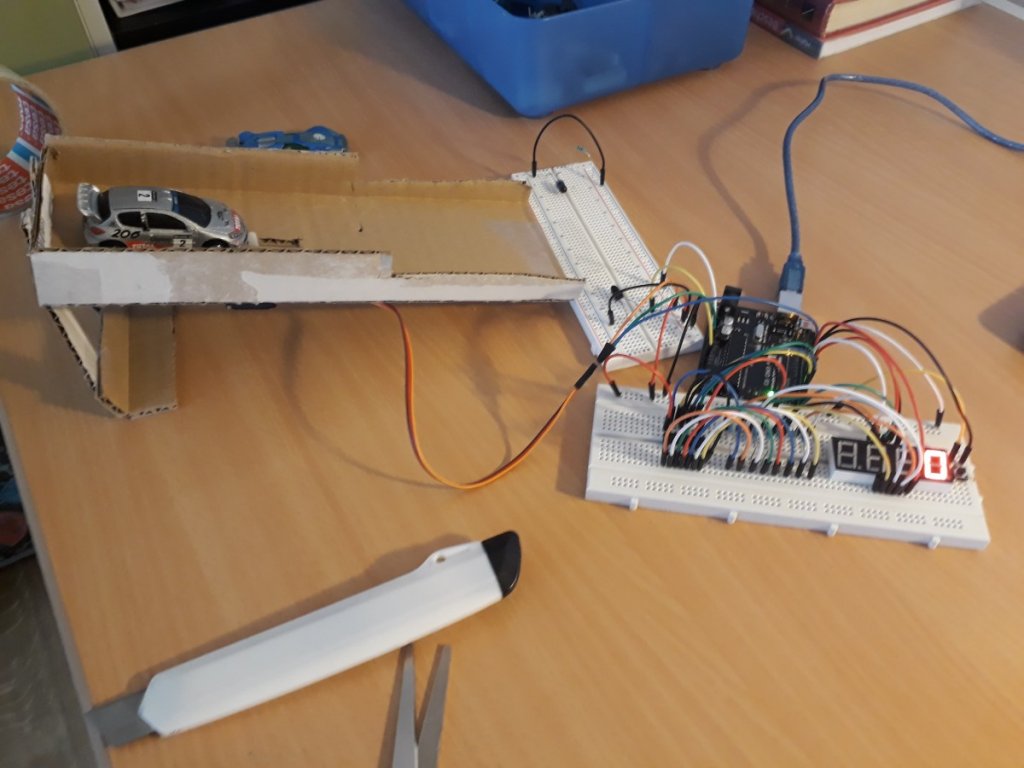

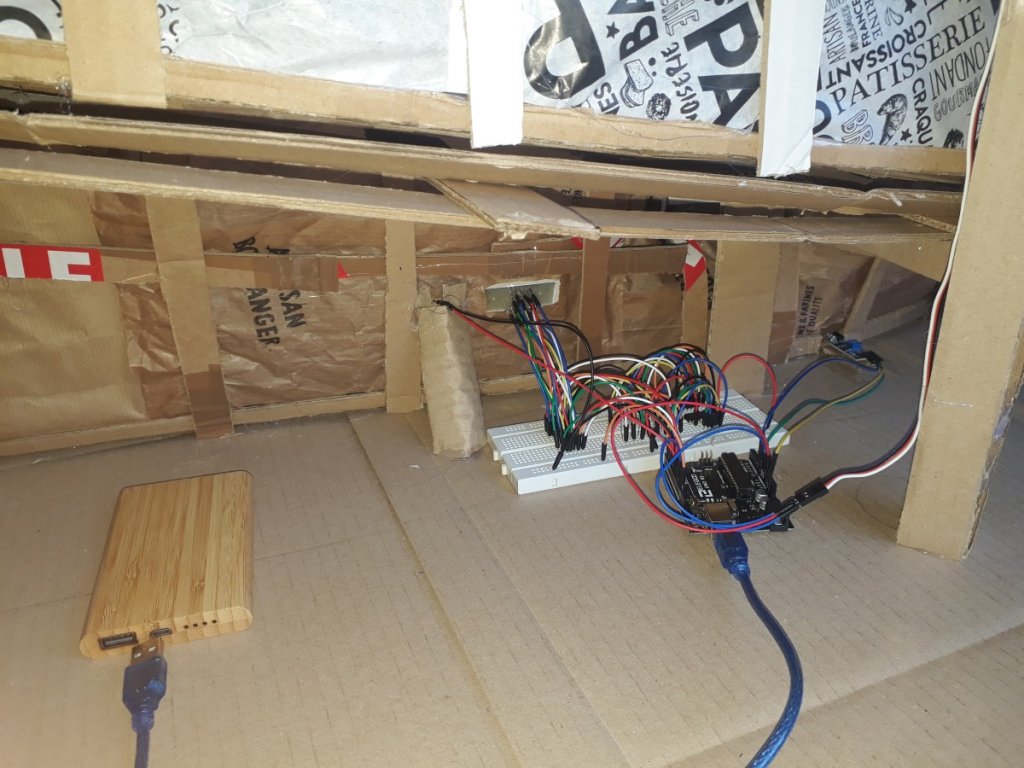

The timer prototype is done :Here is what it looks like fully assembled :

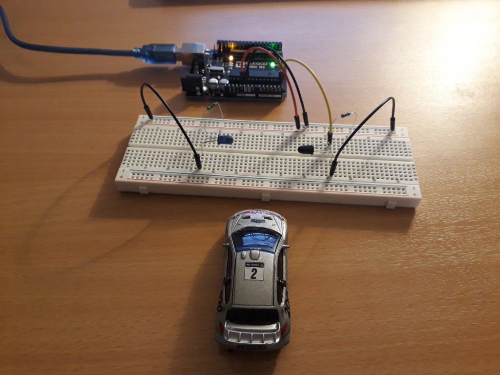

The car detection only works half the time ... There's still so much to do .
- Be careful with the distance between the beams. I've found there's a point where that diminishes and having over/under detector is needed. — redlinederby
I did everything I could with arduino , and everything is working properly exept for the IR sensor . It wasn't reliable at all . I suppose it's broken , because I got the sensor 2 years ago , and only try to use it now .

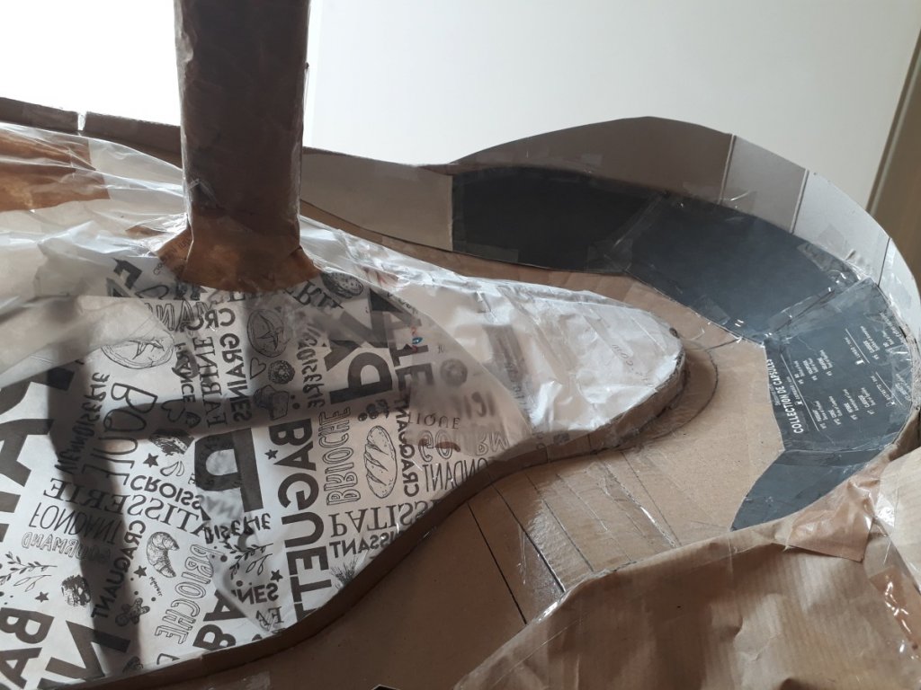

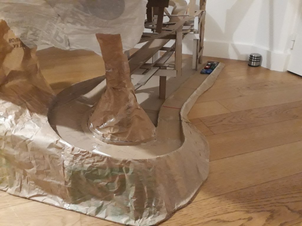

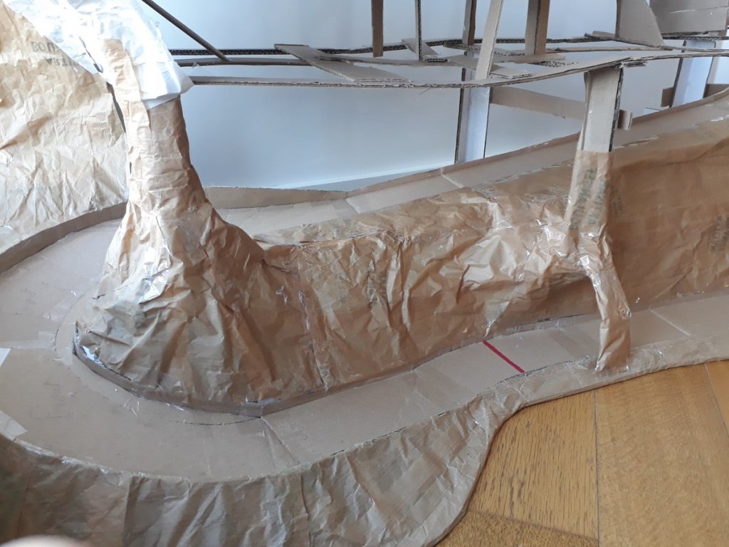

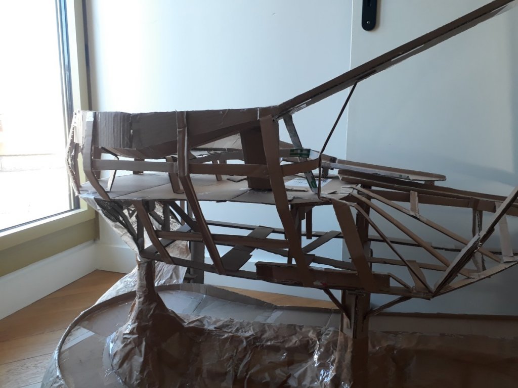

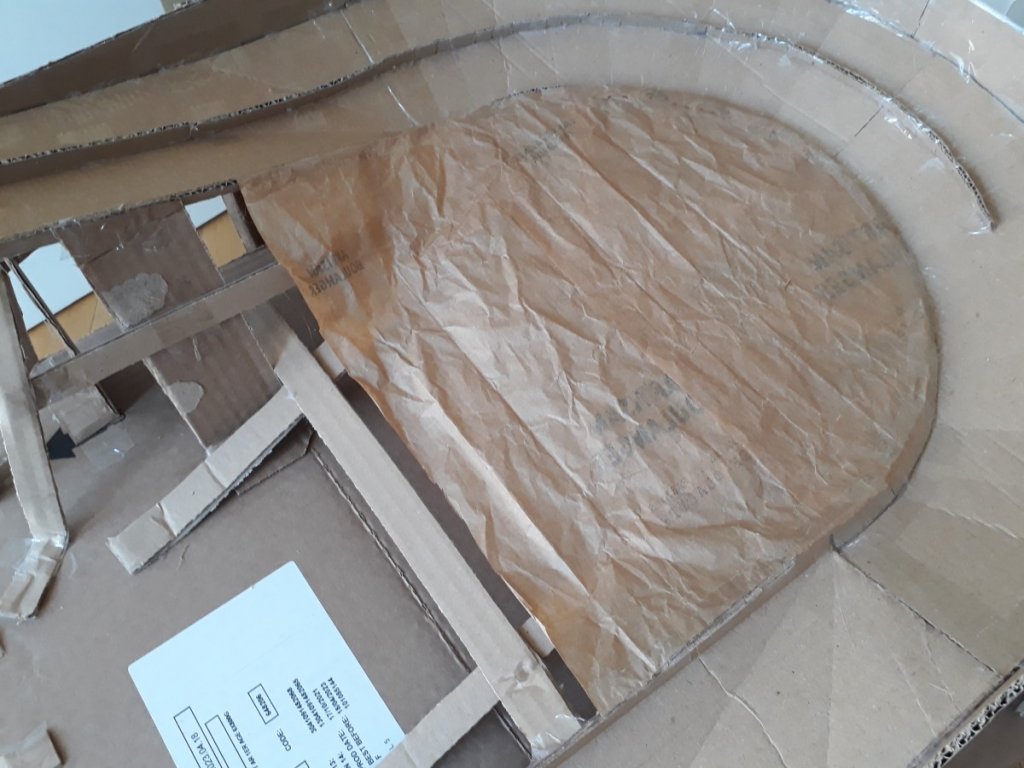

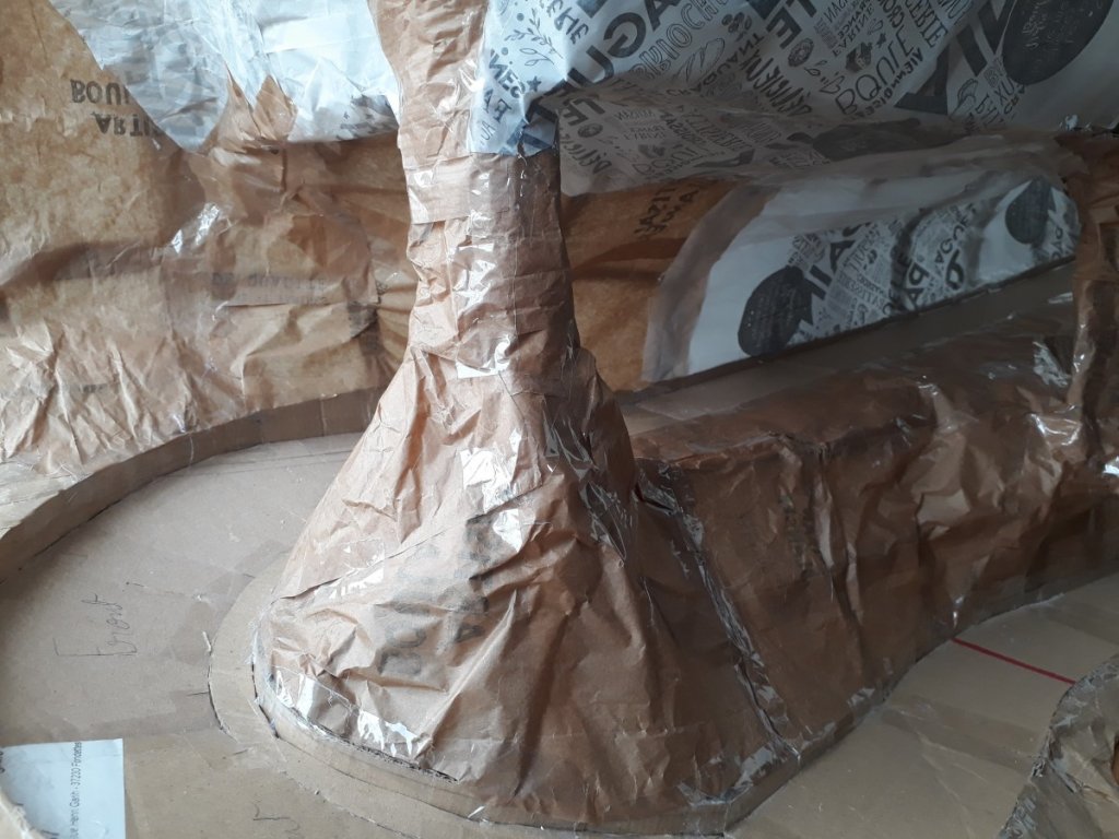

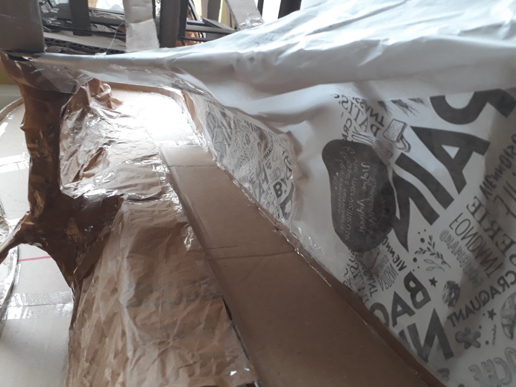

I'm taking a break from arduino to build the scenery of the track , starting with the slopes of the mountain :
More progress :

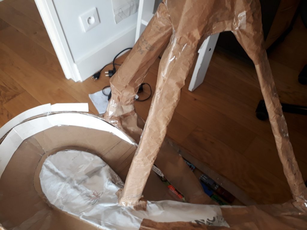

Please tell me how you build those 180 curves.
- Check out the Track Building link in the Archive, there are a couple topics about making curves — redlinederby
- Ok — Deedose
- I finished the tutorial , you can find it over there : https://www.redlinederby.com/topic/tutorial-how-to-build-180-curved-cardboard-turns/5103 — Deedose

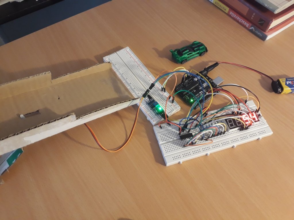

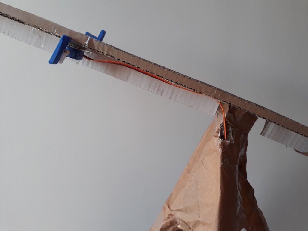

It's done !! The electronic gate finally works !!! It was so painful to make !The car took 540 ms to go down the slope .

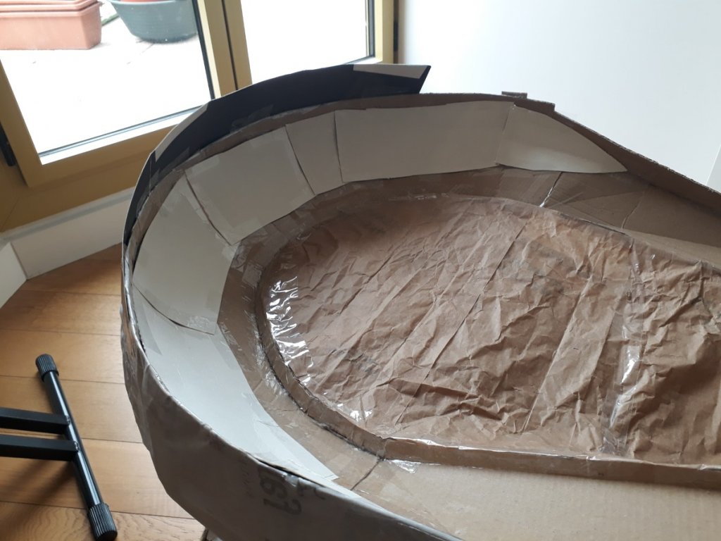

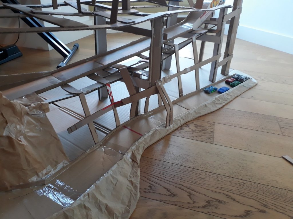

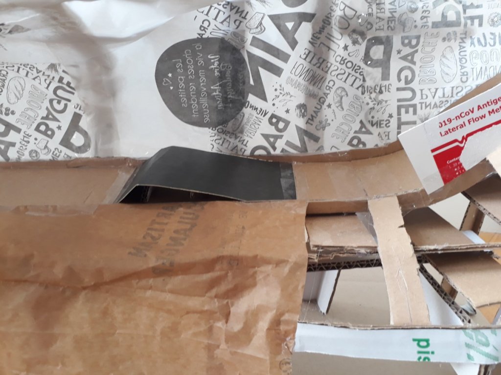

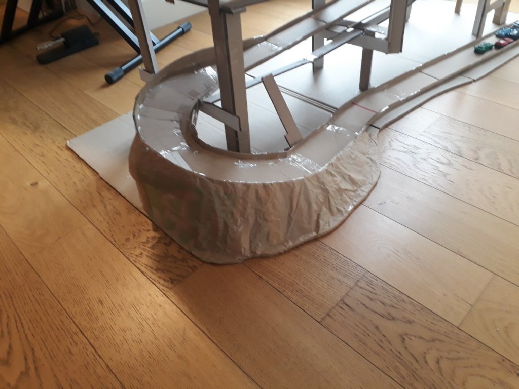

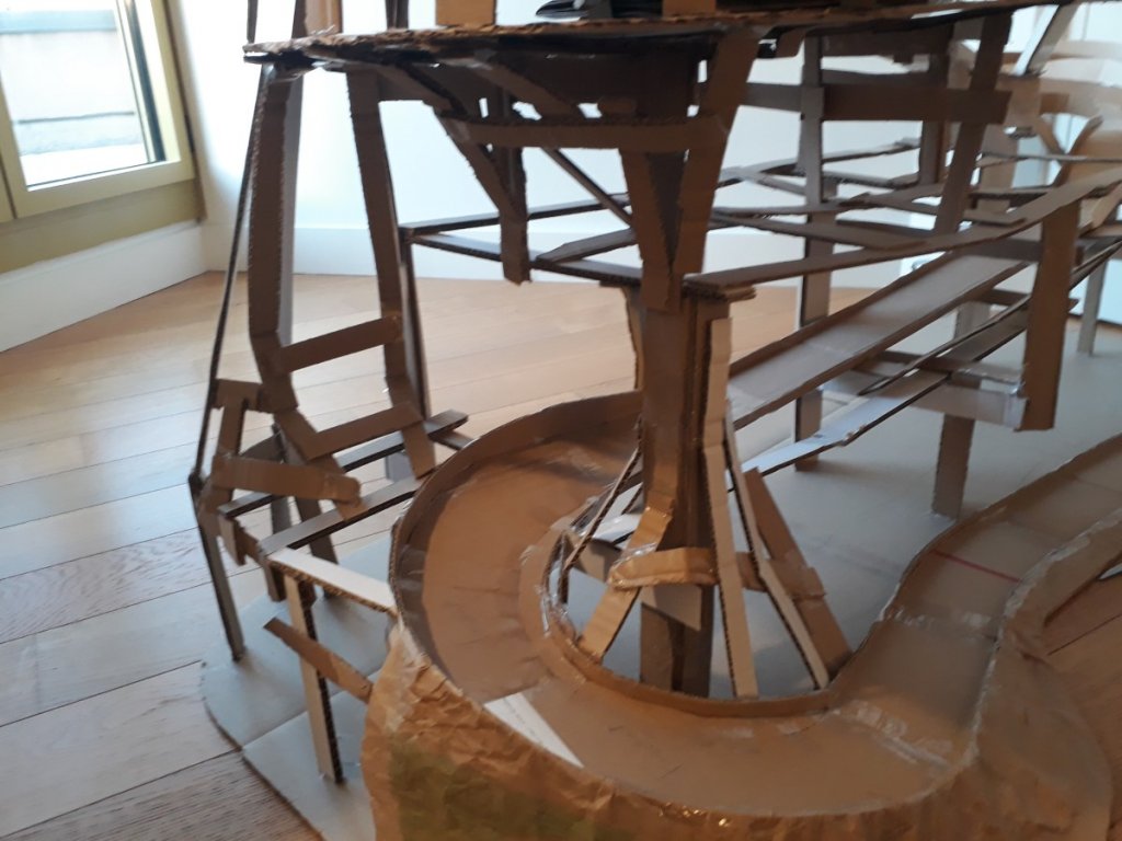

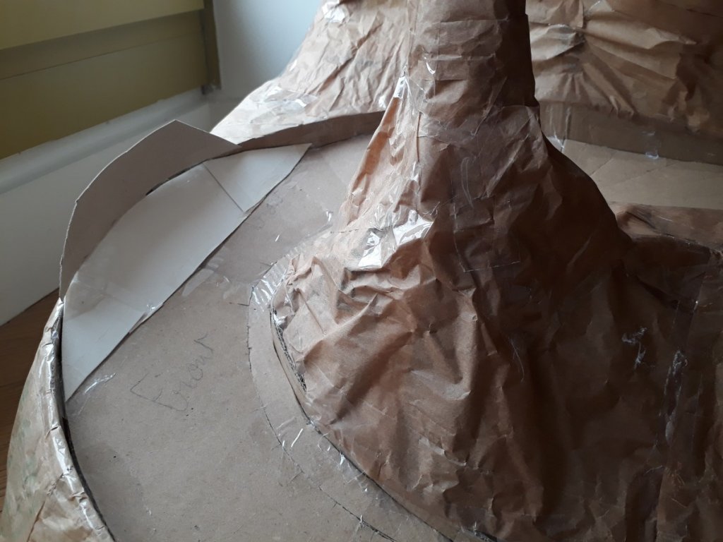

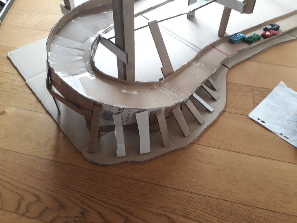

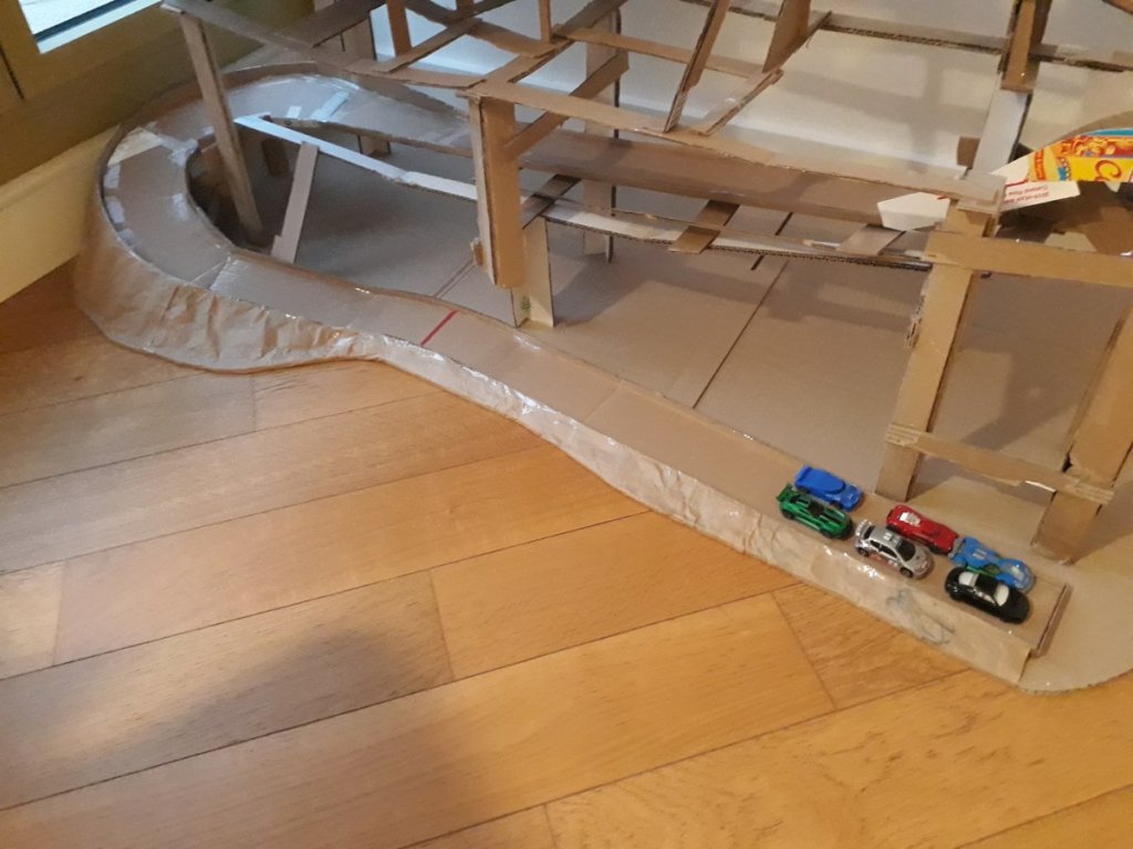

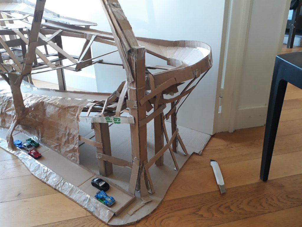

More mountain building :I wanted to make the turns more reliable , and accessible to a wider range of cars . The start drop and turn became open track pieces , because I had trouble with the separation walls .
Then I made the banking of the first 2 turns steeper , I don't think it made the turns more reliable , but definitely allows for better speed conservation , and for some crazy crashs :
I wanted to make the cars drift around the 3rd turn , but I ave no idea how I'm supposed to do it . Any suggestions ?

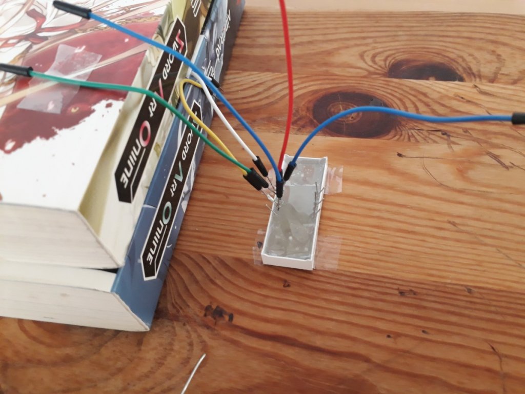

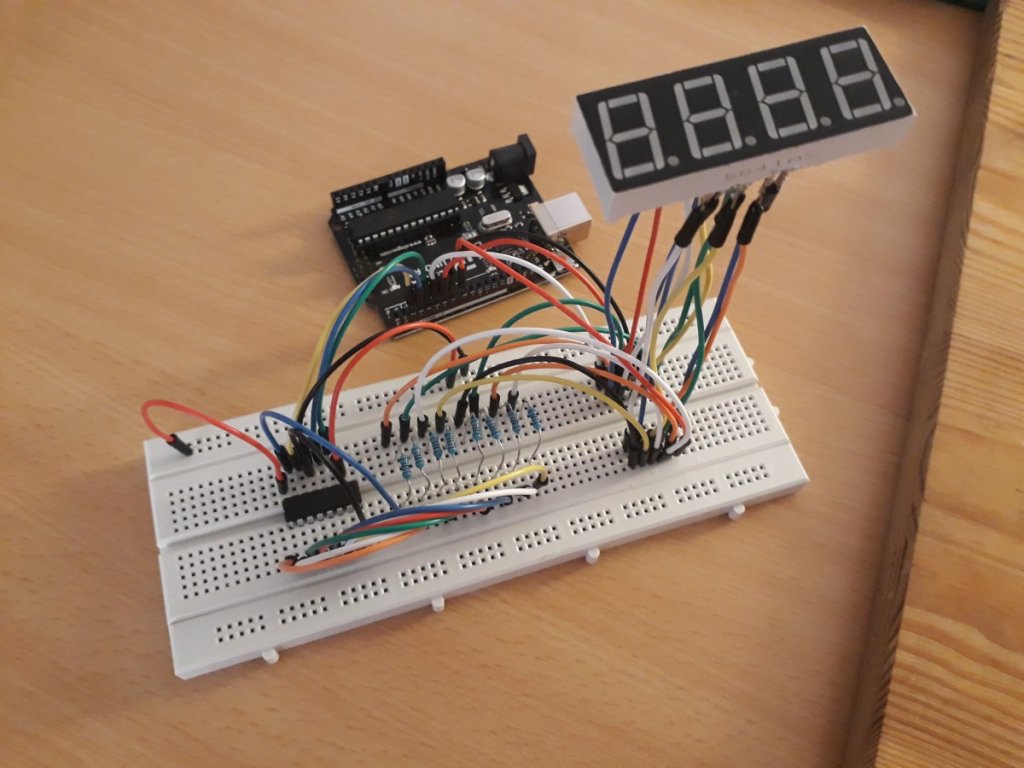

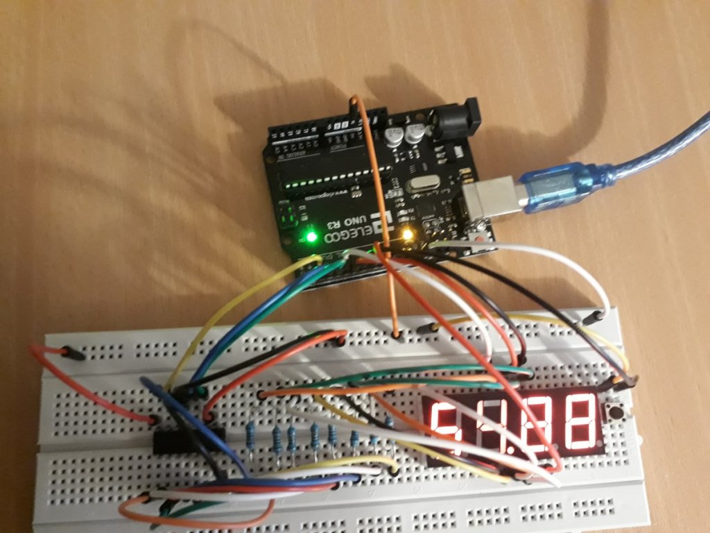

My first time soldering :Servo ready :

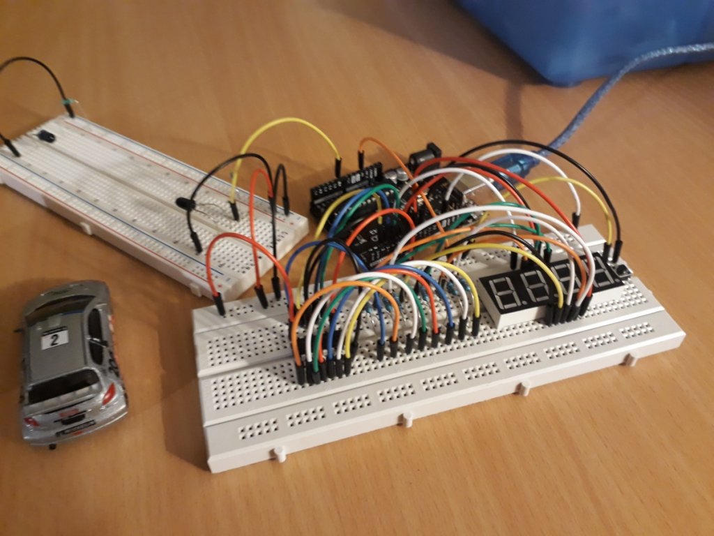

Electronic circuit being assembled :

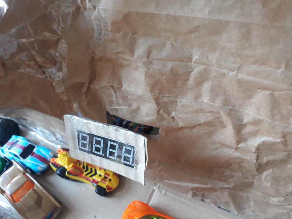

Display where it needs to be :
All the composants are ready to use :
Done !
It works ! the timer works !
- Wow, that's awesome! You finally did it! — GT_Diecast
- I can start optimising my diecast cars — Deedose
