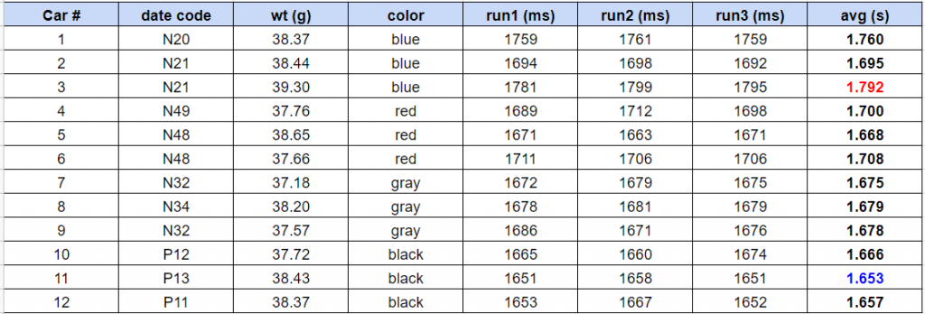

I ran these down my sixteen foot track with a timer. Each car makes three runs and the runs are averaged.

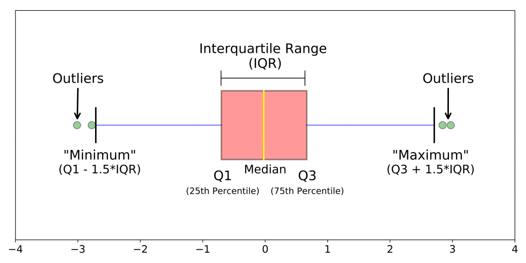

A majority of them were below 1.7 seconds, which is a good sign. The average speed of 1.694 seconds was significantly faster than that of the Mod Rod’s 1.724. But is that the full story? I noticed two of the three blue examples (the oldest), were significantly slower. Is that a coincidence? In statistics there is the concept of an “outlier”, a data element that is significantly different from the others. This is best shown using a “box plot”, which shows where the majority of the data falls, and if there are outliers. Here is an example from a great article by Michael Galarnyk:

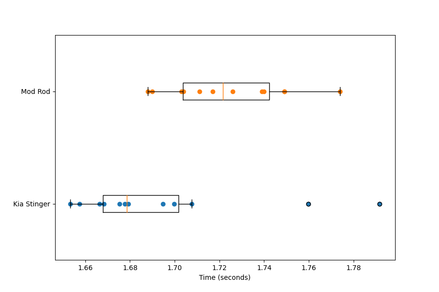

If we plot our data, along with the previous Mod Rod data as a Box Plot, a story emerges:
It shows that indeed, the two slower examples are outliers. The date code “N20” indicates the car was manufactured in May of 2020, almost 15 months previous. Does sitting on a store shelf make the car slower? Corrosion on the axles? The other clue that would support this theory is that the three fastest examples all came from the cars made in March 2021, which makes them only 5 months old. That bears further exploration if any of you are taking statistics or know someone who is, but I wanted to move on to another question. How would graphite affect the performance, and would the result vary based on the original performance?

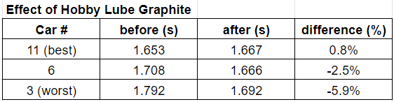

I picked three examples, the fastest (#11), the slowest of the non-outliers (#6), and the slowest (#3). They each received a single application of the Hobby Lube graphite using my normal method and ran again three times, with the average time being shown.

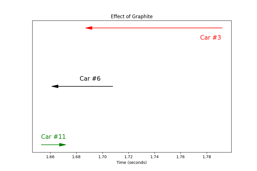

Wait, what? Graphite caused the fastest car to slow down a fraction, while significantly speeding up the other cars? Again, a chart is helpful in seeing the picture:
So, in summary, the 2019 Kia Stinger is a fast casting in comparison to the Mod Rod, but the data indicates that sitting on the shelf is detrimental to performance. The data also indicates that application of graphite has the greatest effect on the slower cars. So many questions in the quest for the Golden One!

Very cool. How in the world did graphite slow a car down? I'm still scratching my head.

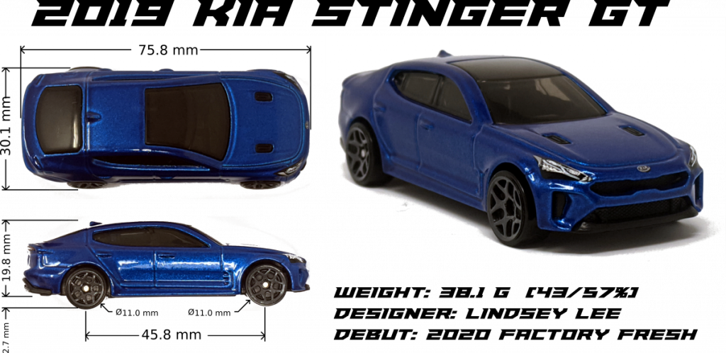

Interesting article, but I have to interject one important fact, concerning the KIA Stinger. The Stinger, along with about 5 current Hot Wheels, have a major design difference, compared to " normal " HW cars. That difference is the fact that the body rivet " connection " to the base, is in a premium location .... infront of the back axle. Almost all HW's have this point in back ... of the back axle. Just my opinion ... I think, on the Stinger, this point acts like a Roman arch ... transferring the body weight to a prime location .... infront of the back axle - not behind ...... but what do I know ???? Voxxer
- Hmmm very interesting. Good insight. Probably depends how much extra metal the rivet post brings. And maybe what impact the shape/orientation of that weight has on the car. — redlinederby
- It is worth writing these articles just to tease some gems out of Voxxer! That is a sharp observation! — TheMakersBox
