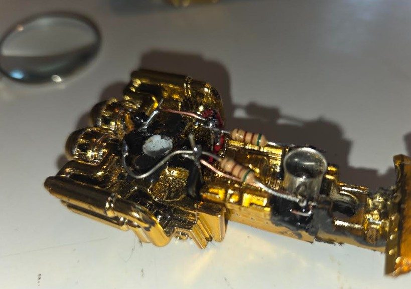

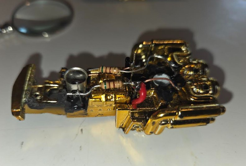

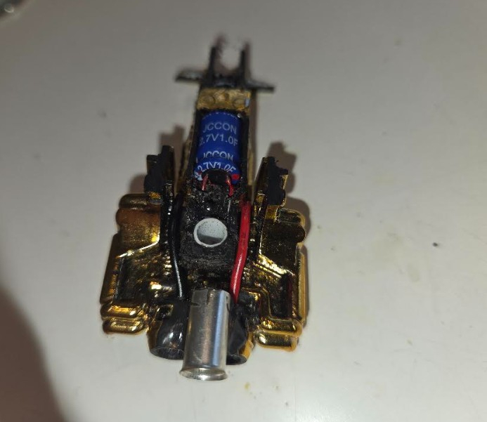

dr_dodge 9/21/26
so, since CC said I could light the Freezie car
the interior of c3po into a circuit board
the velocity stack and jet exhaust have 4 color flash leds in them
the futuristic power plant from moparnia
2.7v 1f supercap off amazon, $1 each if ya buy a bag
I'll do a build thread as soon as I wrap it up
runs for 15 minutes all colors, and still flashes red at 40minutes on a 2 second charge (2 x AA)
