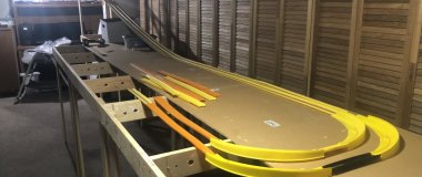

There are no curves on the Orange Monster, just a straight drag, but it's most of two 6 Lane Raceways put together, then the run-out. I use two (2) of the vintage two lane curves on my Bootleg Run track and the bank is 65 deg. Mopar Mafia asked me if I was following the 3D build thread for the 6 Lane finish line stand he might be making in the future.
My curves are on Bootleg Run, the track 3D based his track build on.
I'm going to use a 1x12 for the run-out, a 1x12 is 11 1/4" wide...I will duplicate the mounting slots on the board so the Finish Line will mount exactly like it does to the bottom of the 6 Lane Raceway...the run-out will be 12'.
