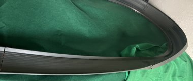

a ductworking buddy of mine made me [12] 6foot steel sections of track on his 8' metal brake, the ends are trimmed to slide into each other...BUT we left the siderails perpendicular to the base [bodies sides rubb] we should have put a little angle into the sides. like the drawing ; Diecast Cars, Hot Wheels, Matchbox
offset "lip" is on the uphill end, slides under the upper section. i made short sections that let orange hot wheels track connect to the steel and visa versa... sorry, no transfer, all flat.
anyone who wants my remaining [6] 90 degree sections of the track, and the adaptors, can have them, they need only pay the shipping
