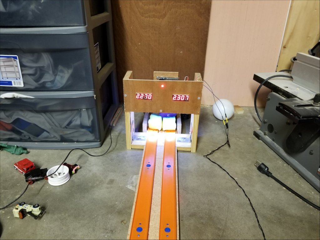

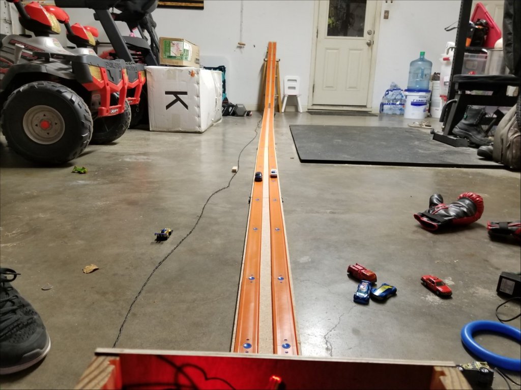

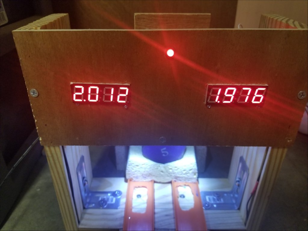

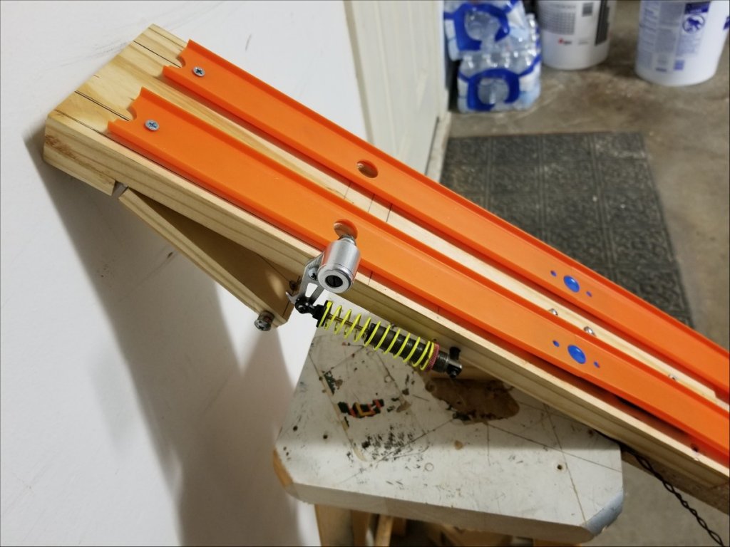

All, good points and info.  Thanks!  Sure 41-14 I'll share some pics, but please disregard the messy garage.  Its just a 2 lane arduino build, nothing crazy or super fancy.  I did get a little creative with the starting gate.  I used some old RC car parts to build gate drop mechanism.

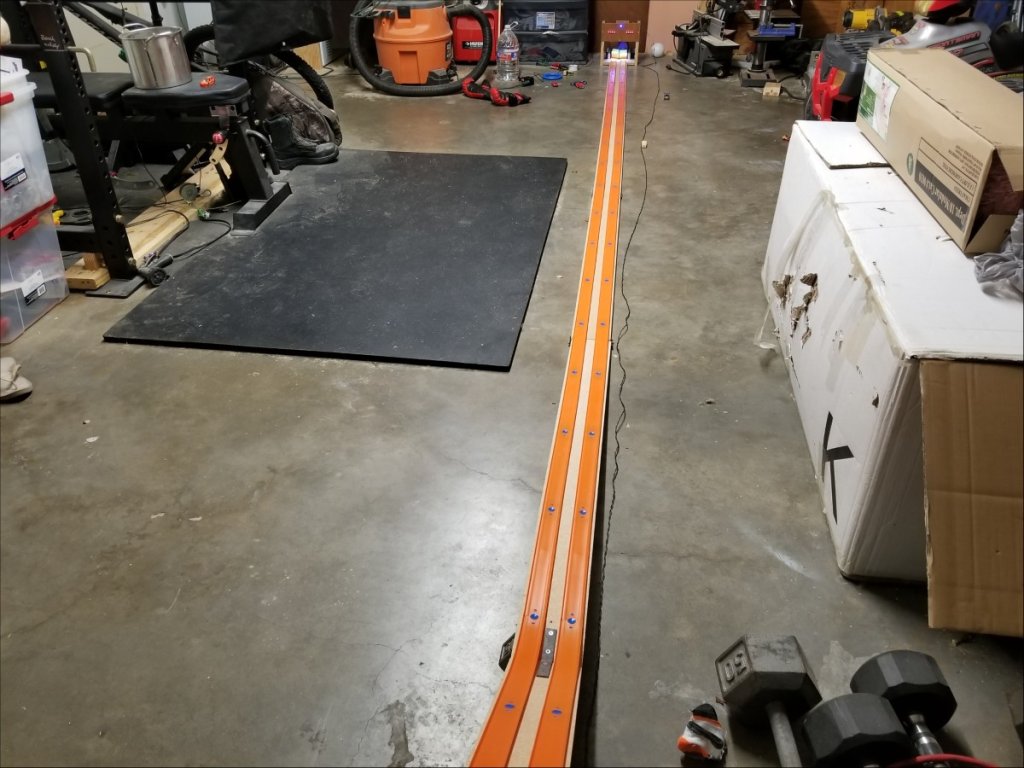

The last pic is the track record.  Its a little over 3ft drop with a little over 20ft total.  I needed the drop to be short so my kids could reach it.  Also, I have zero experience with Arduino and electronics, although my soldering skills are ok from my old RC racing days.

  • Nice job Go Time. I'm currently building something similar myself, although I'm only just starting. Oh, and for the record, that is NOT a messy garage! lol — PeteB

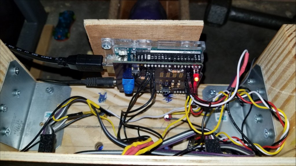

41-14, the 3d botmaker finish lines are awesome!  I almost bought one.  I had zero experience with arduino and electronics, but that was the beauty about the arduino/PDT setup its all done for you.  Code is written, all you have to do is build a box and wire it up.  There is quite a bit of soldering to do though.
It looks way more complicating in the pic than it actually is.

That’s an awesome setup! I’d be honored to have my arse dragged down it by one of our racing bros here at the redline derby.

No Sir, dont mind at all.  You will find everything you need at the website below, minus the arduino, which can be purchased for about $25 elsewhere.
www.dfgtec.com/pdt-construction

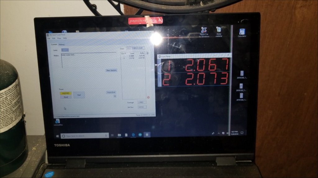

Everything you need is on the website, including detailed instructions, and arduino code.  By the way, I am in no way affiliated with this web page, its just a page i ran across and followed which worked out GREAT!!! On the website they also offer a free program to test cars, pic attached. Let me know if you need any additional info. Hope this helps.
