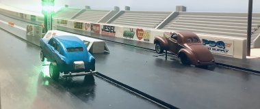

Many years ago, when we were kids, we raced toy cars just like most of us. And yes, now we're old(er) and a bit wiser... so I decided to pick it up again but now on a whole new level.
Our plan is/was to build a 4 lane seamless track with timer, and try to make it as consistent as possible. It's pretty expensive to get a seamless hotwheels track here, so we chose blu track. It's not ready yet, but we're getting there:
https://i.imgur.com/o9PWmaI.jpg
https://i.imgur.com/stEqaYM.png
https://i.imgur.com/VsIyefs.jpg
https://i.imgur.com/8GA0Wsh.jpg
It's my first post, so i hope the pictures come through. Comments/questions are more than welcome and more news and better photo's will follow soon!

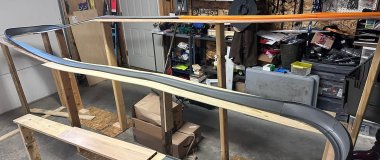

Thanks! The track base is made of MDF indeed. Cheap an sturdy.
There are some minor changes coming up though. This week I glued some aluminium strips on the sides of the ramp, because it started to bend a little.
Second problem comes with the blu track. Because the "walls" of the blutrack are 100% vertical, I got a few wrecks due to mirrors hitting the MDF walls. So the MDF guardrail will be replaced with lower ones.

- Can you bevel the mdf to match the height of the vertical wall on the blu track at a 45 degree angle. That way it should be enough clearance — 41-14
- For the cars to avoid bumping into the mdf. Just a thought. — 41-14
- Could have saved me some money on new barriers, but i don't have the tools to shape it at 45 degrees. Good idea though! — DDRacer
1/4" square dowel and lattice strip's may be helpful. ..the lattice strip is 1 1/2" wide and right in between 3/16 and 1/4" tall and could still be used with your wing nut system albeit shorter bolts, or you could possibly raise the track so the top of the track walls come close to flush with the MDF?

Hope this helps...Peace - League of Speed
- You would have to glue down the dowel of course, but lattice strip's on the sides and the middle might be a homerun. — LeagueofSpeed
Raising the track gives me another problem, because the edges (blu track has a small strip on the outside of the track) are underneath the MDF trackwall. That way, if I turn the wing nut, the track is 100% flat and not going anywhere.
https://i.imgur.com/ovm8bhH.png
But the strips are a perfect idea! I'll have a look for a place nearby where I can get them. They should be low enough and with some shorter bolts, will look okay too.

First things first: Got myself some new track barriers, so no more wrecks!
Now up for the transition. Because the BluTrack is being hold by the barriers, you can put tension on the track. That way you get a nice transition just at the angle you want. Just put more more less tension on the track.
The only thing that's really difficult, is to get the same transition for both tracks. BluTrack is so darn flexible... Anyone got a good idea for material to bend (or shape) and put underneath the track transition? Maybe try to bend some plexiglass? (i hope it's called the same in the US)

I believe Chevy used some aluminum sheeting under his transition. It was thin enough that it gave a natural bend to support the track. Although I wonder how sturdy that is...seems to me there would be a lot of give when cars roll over it. Some thin plywood might do the trick too. You could use some sort of rope/pulley system that provides the tension and creates the curve. I did something similar long ago with my track and it worked pretty well. I actually had the pulley system pulling the track rather than the support underneath but same principle.
I have metal guides under my track at the transition, the orange track just slides over them like a normal connector, but even then I feel the transition curve is not the same for each lane. It's really damn close, close enough for what we're doing...and that's the thing to remember.
