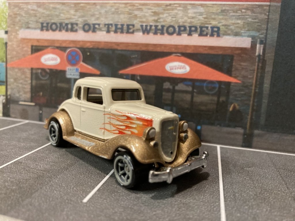

In tonight's work I took a plain MatchBox 34 Chevy coupe and hot rodded it. The old man had either a 34 Ford or Chevy when the US joined WWII.
- Ok that's a pretty fantastic looking job! — Dutch_Clutch_Racing
- Great work! Thats sweet. — Zamak_Speed_Shop
- I’m happy with it overall and those flames are from a decal sheet I created. But that’s the wrong photo as you can see a slight gap between the hood and fender. There is a small chunk of lead under the hood that needed a slight trim job. I’m happy though - thanks. — AbbyNormal
- You are your own worst critic. It looks great! — Dutch_Clutch_Racing
- very cool, great details! — jlane
