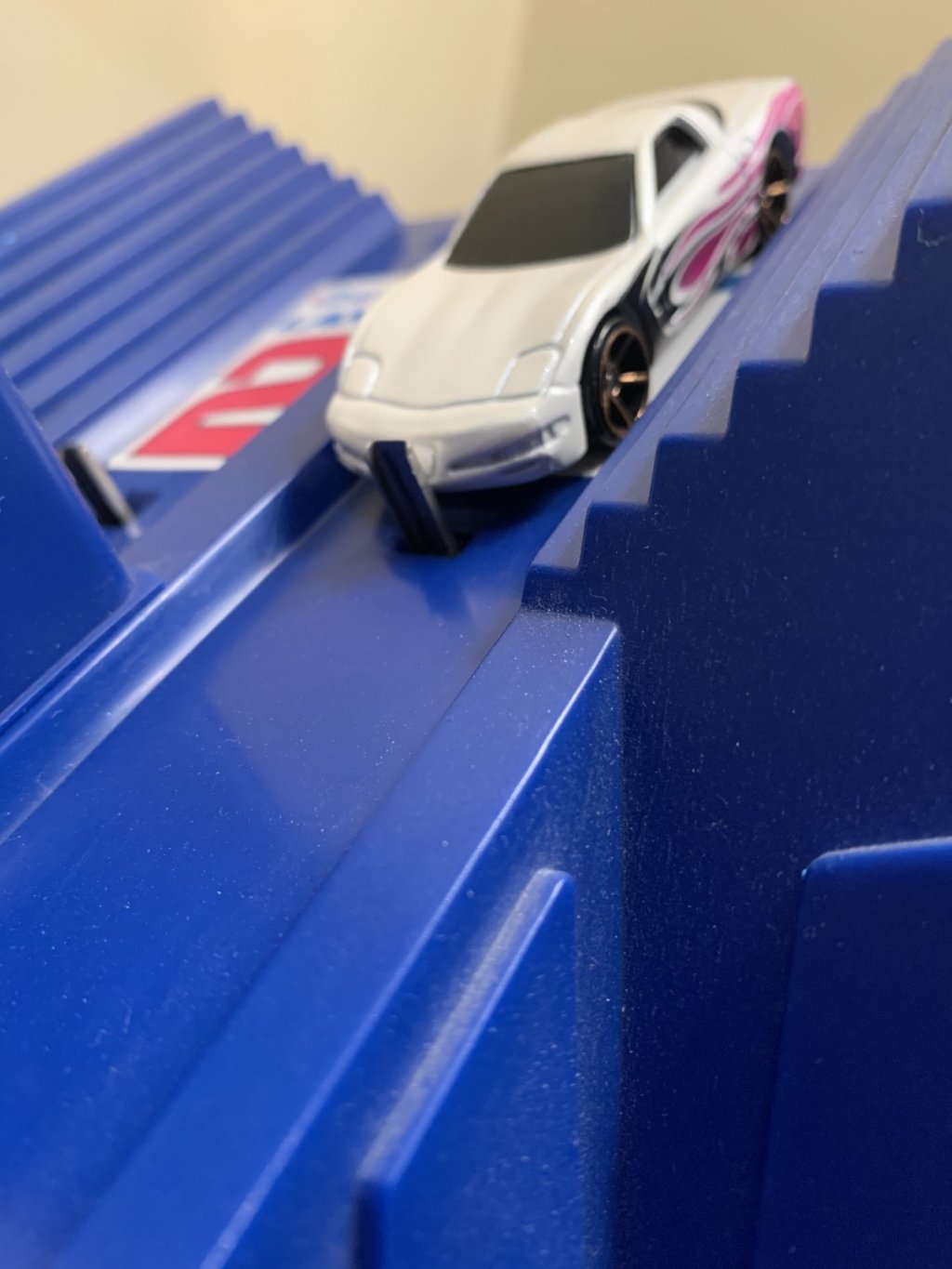

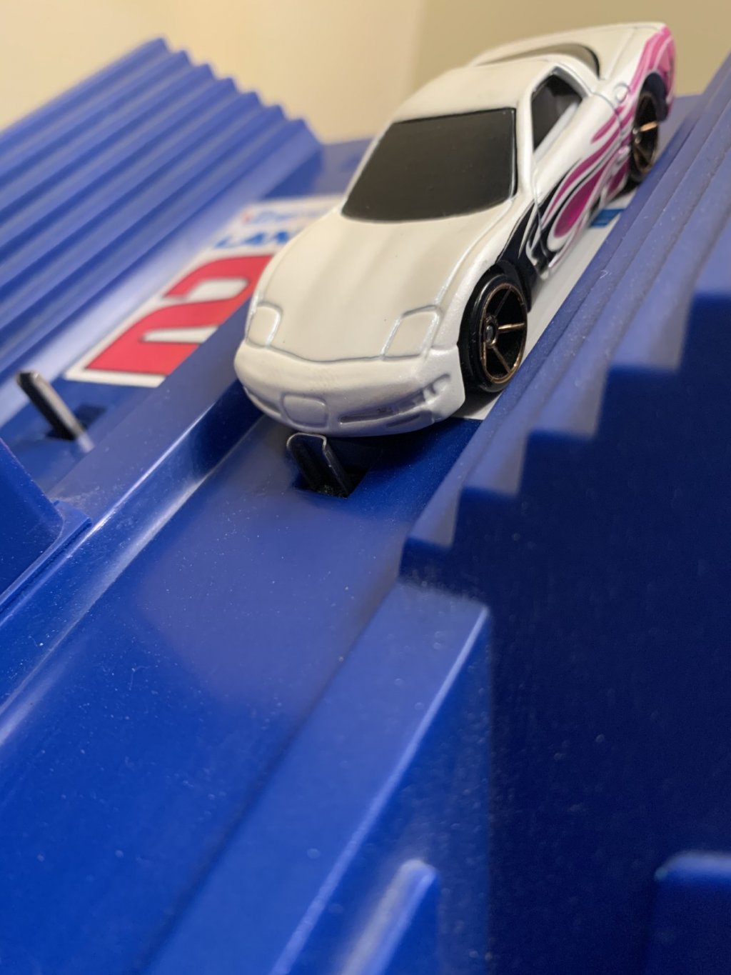

I found adding the power supply helped greatly with the pins dropping consistently. That being said depending on the height of the car being raced, I will stage the drop pins. The stock solenoids are weak, I never invested the time to upgrade. Once I staged the pins I could get consistent release on both sides
note height of drop pins in these two pics
stock height of pin
In this pic I set the car against the pin and then slid it down with the weight of the car keeping the pin lower. This reduces the amount that the pin has to slide on the body of the car.
