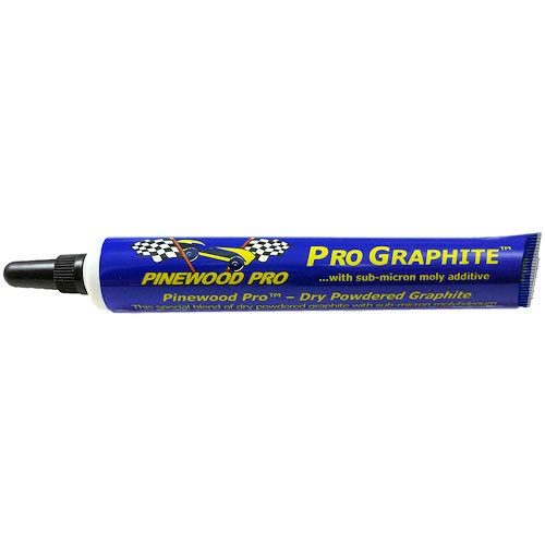

I use Pinewood Pro hobby grade graphite, but recently been experimenting with mixes.
Pinewood Pro is neat, it's in a blue bottle (shown below)
and the neat thing about it is the micro-plastic beads they put in it, which can help reduce friction...at least from what we've tested, anyways. This stuff works, it's a solid choice.
just be carful it doesn't always come with an accurate opening so it will get EVERYWHERE.
edit: "sub-micron molybdenum disulfide." That's apparently what it is called.
- I use this stuff too, I like it. — Numbskull
- It’s solid stuff, but the only issue is it’s inconsistency. Large chunks and small power both. Trying to see if there’s anything It can be mixed with to improve consistency. — 0utsiders_Street_Racing
