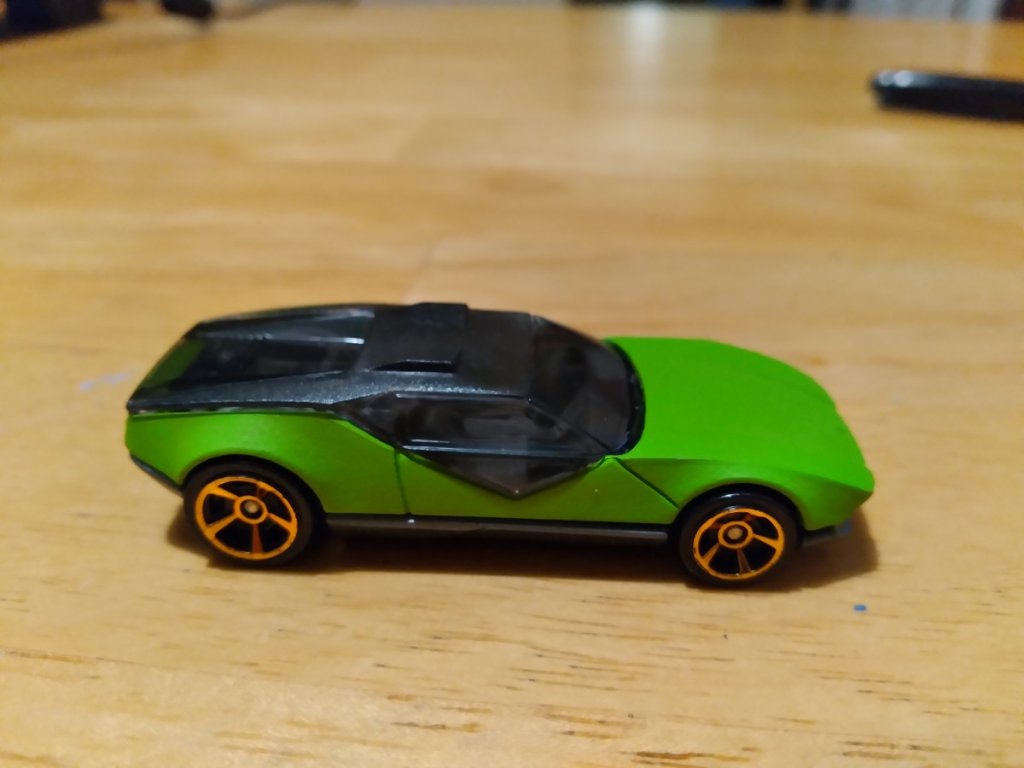

Guinea pig #1 la fasta

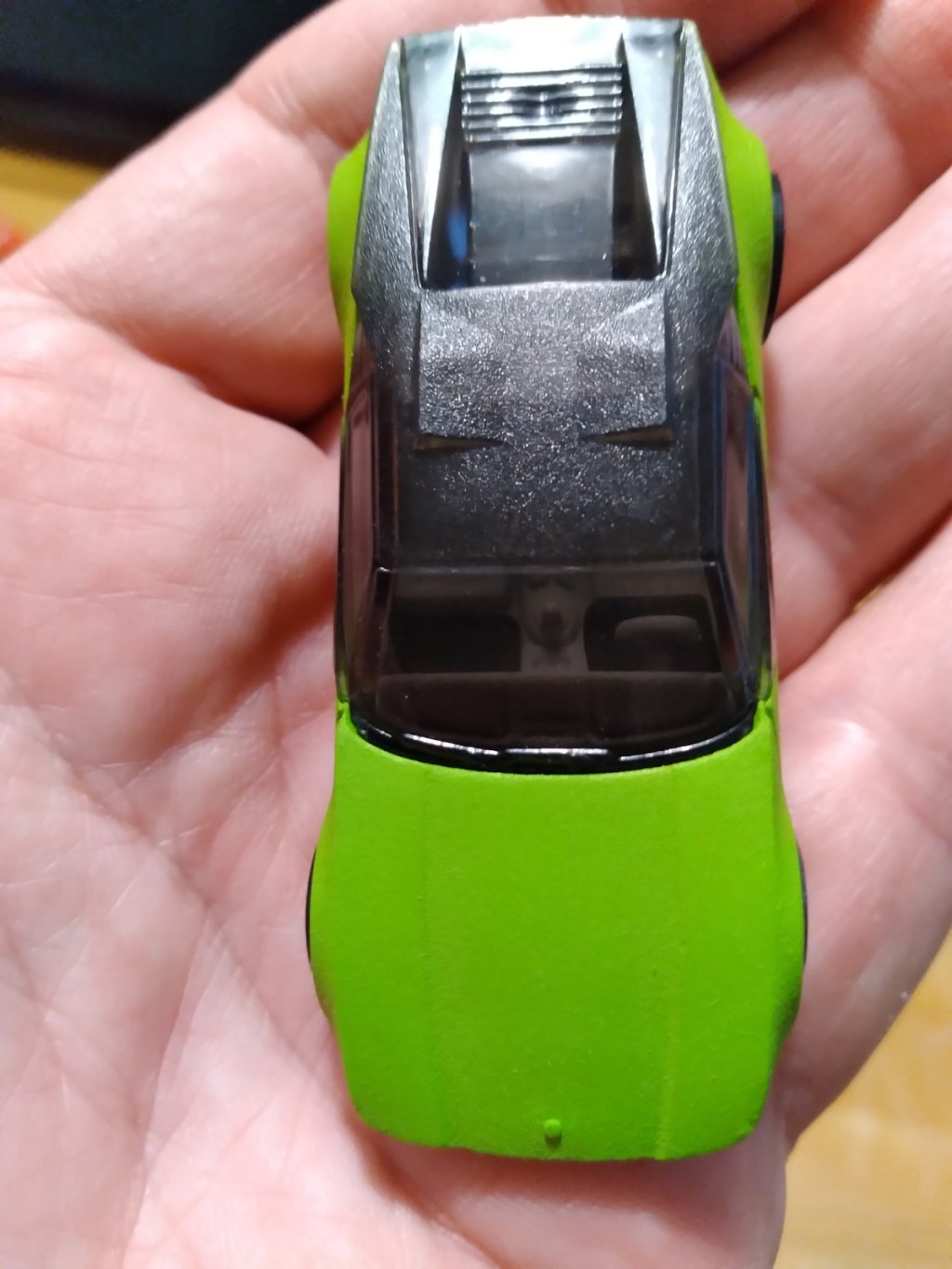

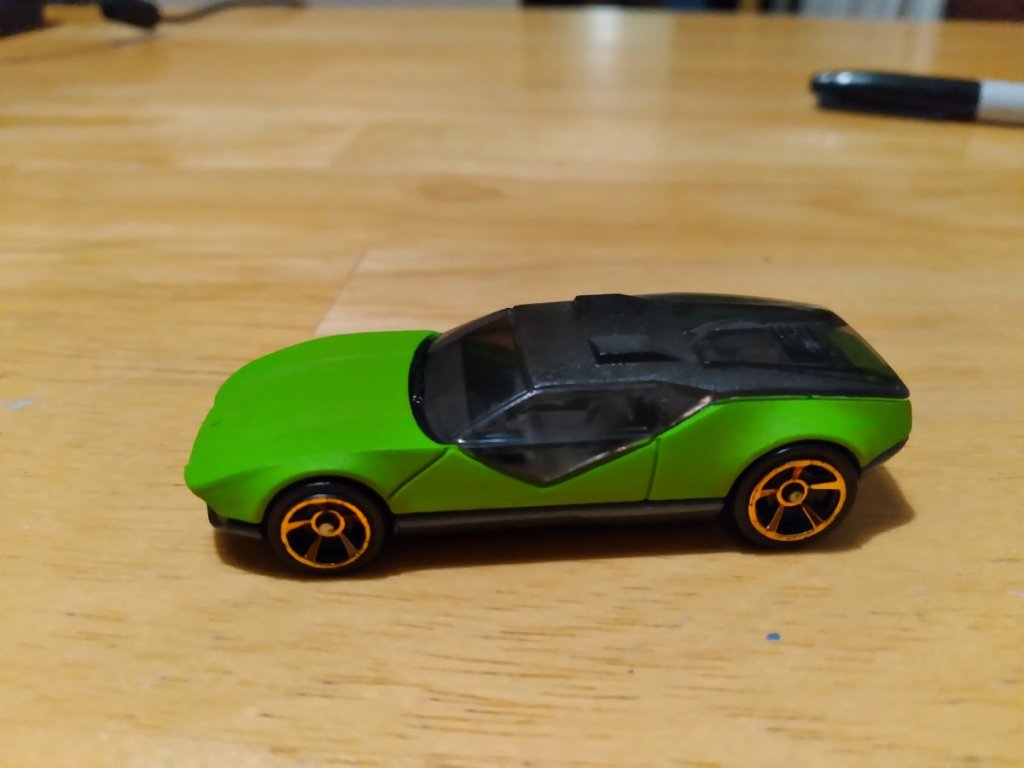

Guinea Pig #1 La Fasta Pro Acryl Bright yellow green acrylic paint applied with make up sponge.  This is just the paint, I haven't clear coated or glossed or anything.  I think this was a great success, it does look very nice, no brush strokes or even tide lines. This is after about 6 coats.  Application of coats is fast, applied with medium amount of paint and when applied to car kept blotting around until dispersed evenly.  Recommend a try.

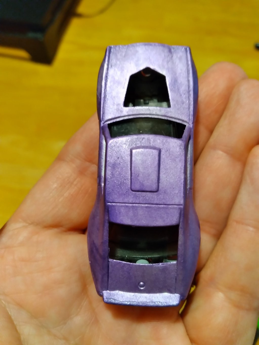

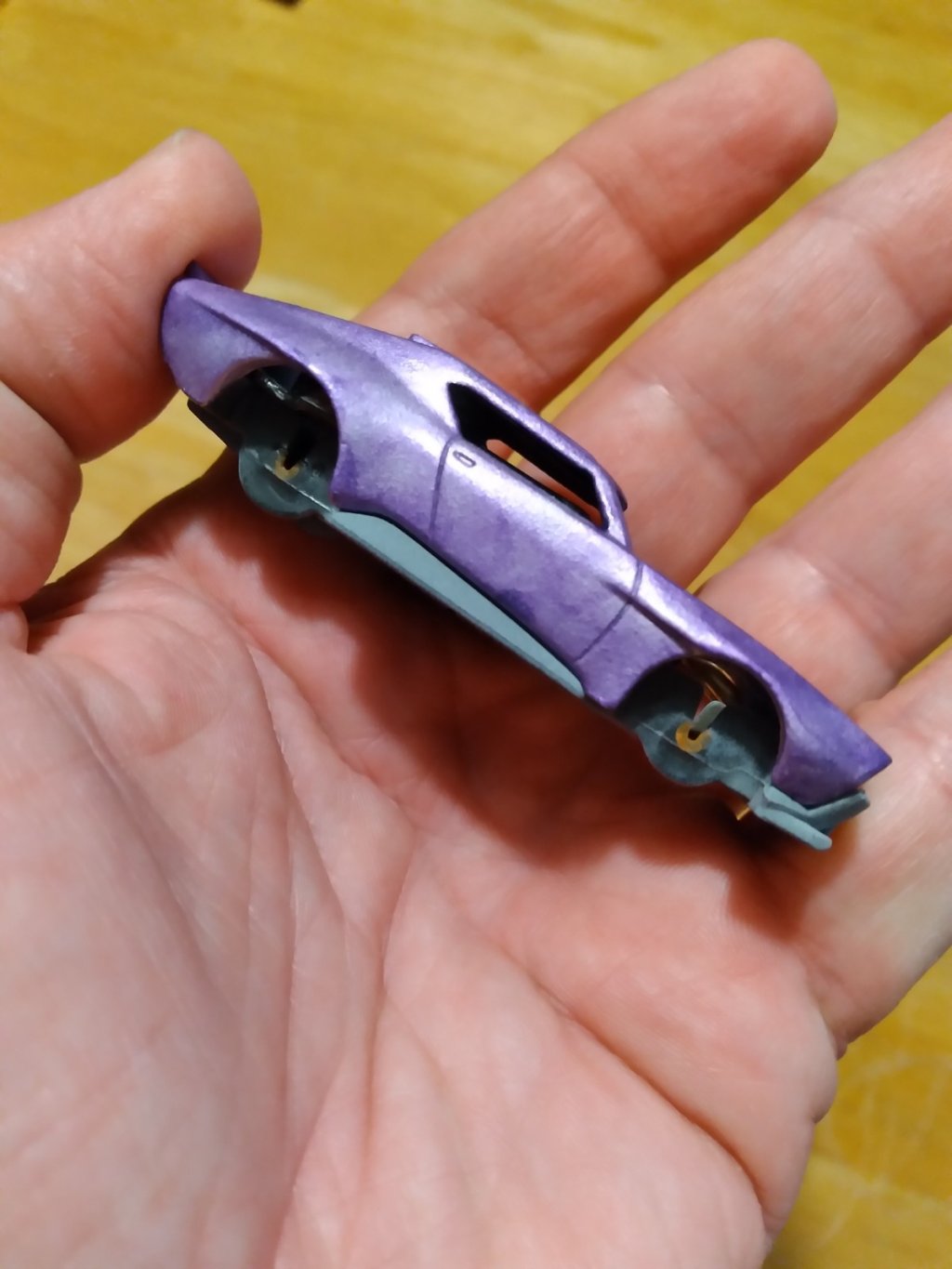

Guinea Pig #2 Muscle Bound Green stuff world candy ink amelthyst purple acrylic paint applied with make up sponge.  Initial attempt looks very splotchy even more so in person than in the pictures.  Not sure if it is the amount of paint or the way I applied it.  Not satisfied with this run, will have another go, this is with 2 coats, may look better with a few more coats.

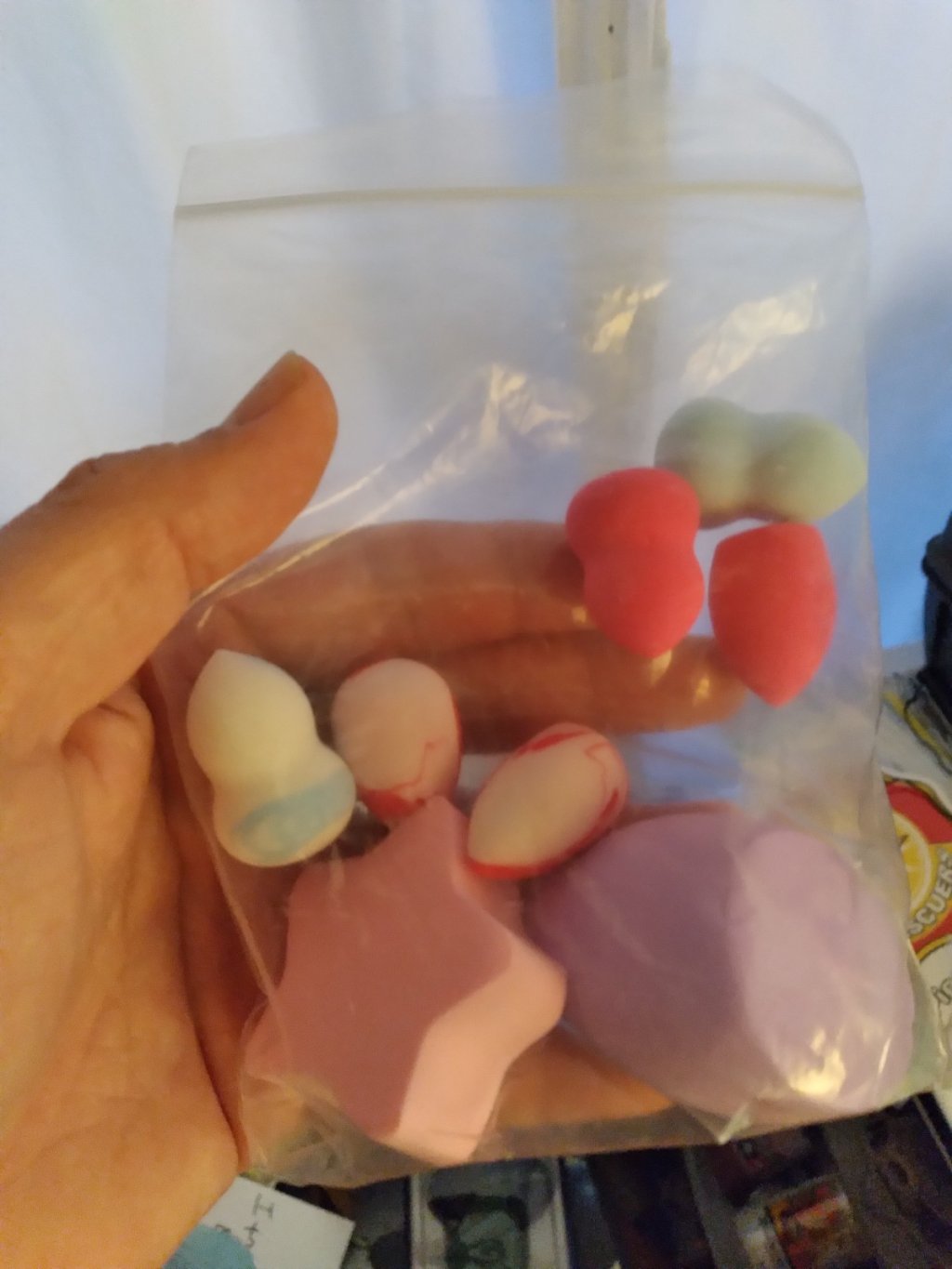

Tools: this is what the sponges look like, they are a dense foam and can be found at the dollar store, large one in a single pack, star shaped in 3 pack, and the small acorn shaped 4 to a pack.
