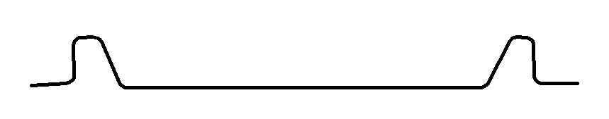

dr_dodge 9/30/23

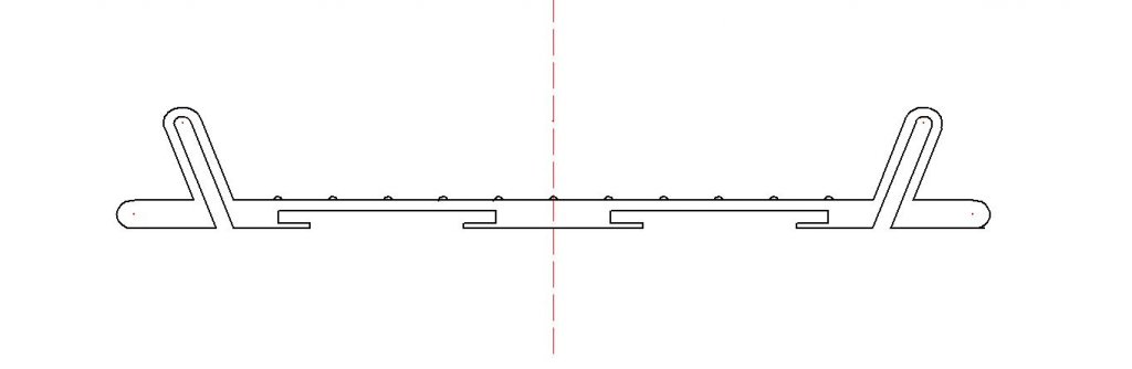

something more like this, to start?
extra sidewall, and a lip for screws
what would be the perfect race track profile?
drawn on delta cad
 Thicken the whole thing, and solid fill around the lower connector connection
outer edge could be drilled for screws
a second style could raise a center divider for 2 lane,
but all the connectors would be the same

redlinederby 10/2/23
Great designs, Doc! I'm very interested to see what they throw back at you. And props for including the Mattel-sized connector. And +1 for your option of a middle wall for a 2-lane option. Could even widen to offer 4-lane if it turns out to be an ask from people.
My expectation of material would be similar to that of Mattel orange track rather than the hard plastic BUT maybe the harder plastic is ultimately better for stability, dunno. If nothing, I'd think Mattel plastic would be the minimum thickness.
I'm sure a long, seamless roll is possible but I see more need for it as segments like the Crash sets. If this starts to become a thing, lets poll folks to see if we could find a common set of S/M/L/XL lengths. And whatever the maximum length is before the material starts waffling could be good and then people can just cut it themselves.
