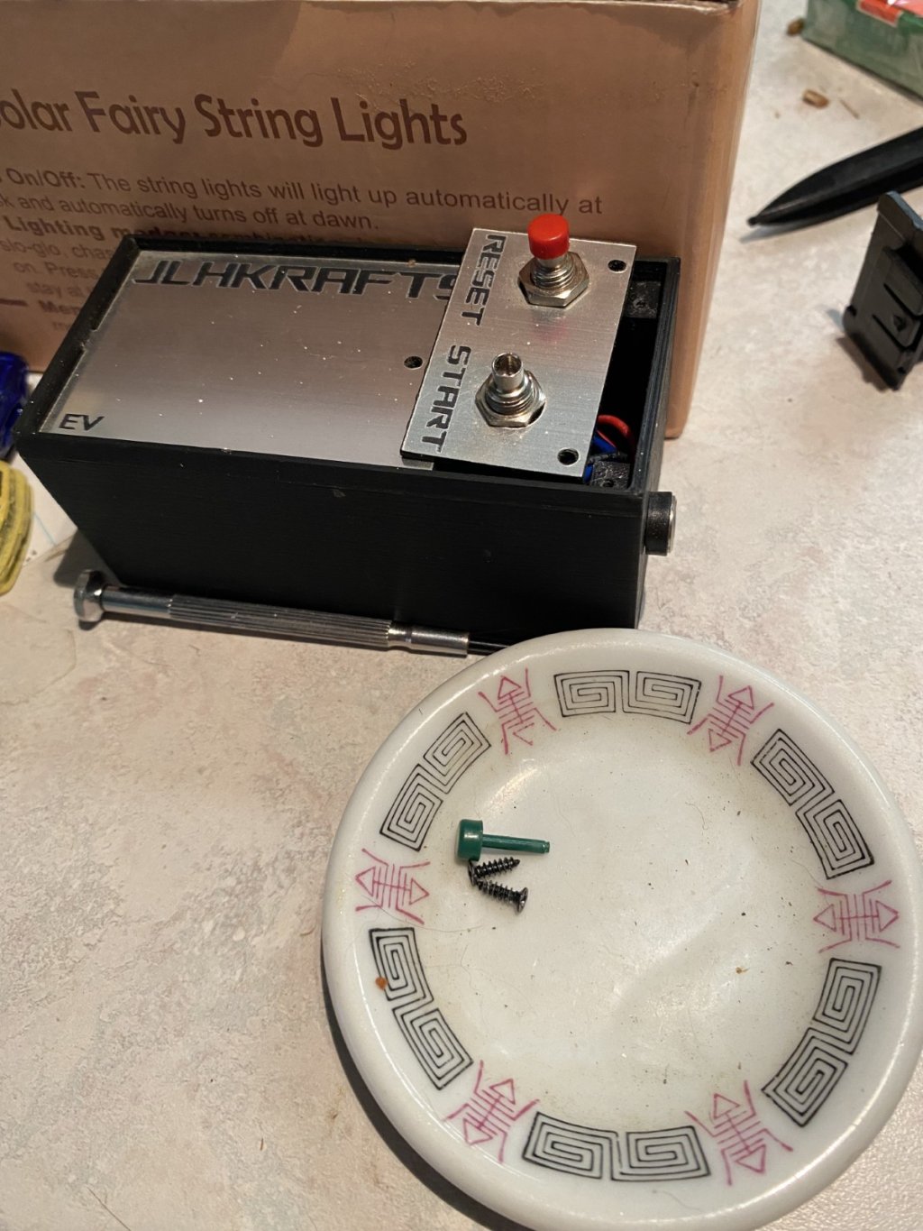

Getting ready for the Group B Rally Cars and Sardine Race. Was final testing of the addition to the track when the start button let go, We have a Radio Shack here but last time i was in the store it was pitiful for anything. So question is, is the button a Single phase? can I just tap wires and have gate close? If I can't get it going I will have to order a New one and JLH just got sold!

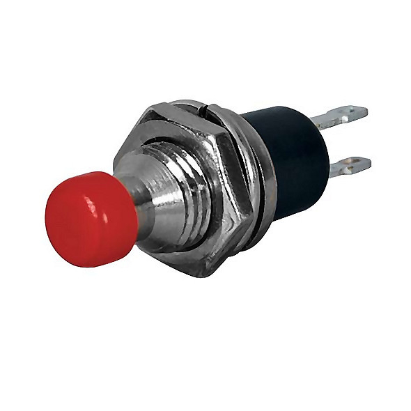

Those look like standard momentary push buttons. they make a connection when pushed down and when released the connection goes away

  • What you were looking for is called a momentary on switch. Not to be confused with the momentary off switch. These are basically 50 Cent switches - Ace has some of these marked up to $5 or more. But just be sure you are getting momentary ON. There are many options on Amazon as well — AbbyNormal
Not single phase... that is related to power. It is most likely a single pole push button switch. It is either a Normally Open (NO) or Normally Closed (NC) push button switch. They can either be maintained or momentary. You need to show the bottom connections and I can help you better. Normally there are two, three or more connection points. Most likely this will have two. You will also need a multimeter or continuity tester to determine the configuration. Everyone else is guessing unless they have that unit and have either tested that switch or have seen a schematic.
probably looks like this or similar on the base...
Amazon carries them and depending on where you live you can get them delivered tomorrow... they look similar to this...
www.amazon.com/Momentary-Switch-Prewired-Button-Normally/dp/B0F43GYWJ6

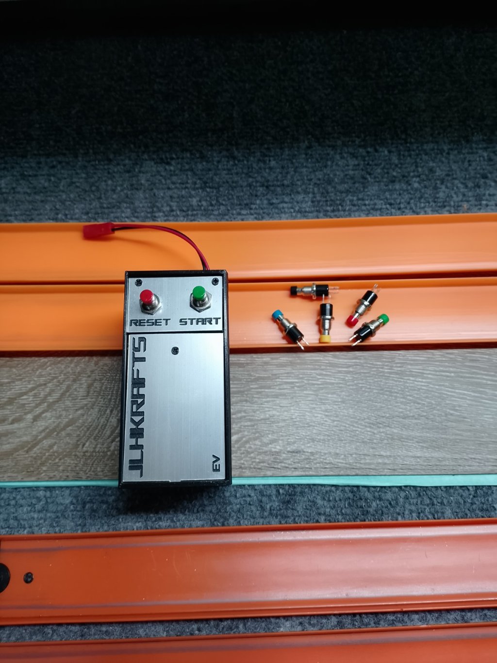

Wish I had checked the site earlier. I have the same box and extra buttons you need. I'd a sent it to for the price of a mainline
  • Hello Mate, I'll take it. Trade with some nice cars? Jim — Bent_Rod_Racing
  • Absolutely-- Let me get it ready — RC_Attucks
