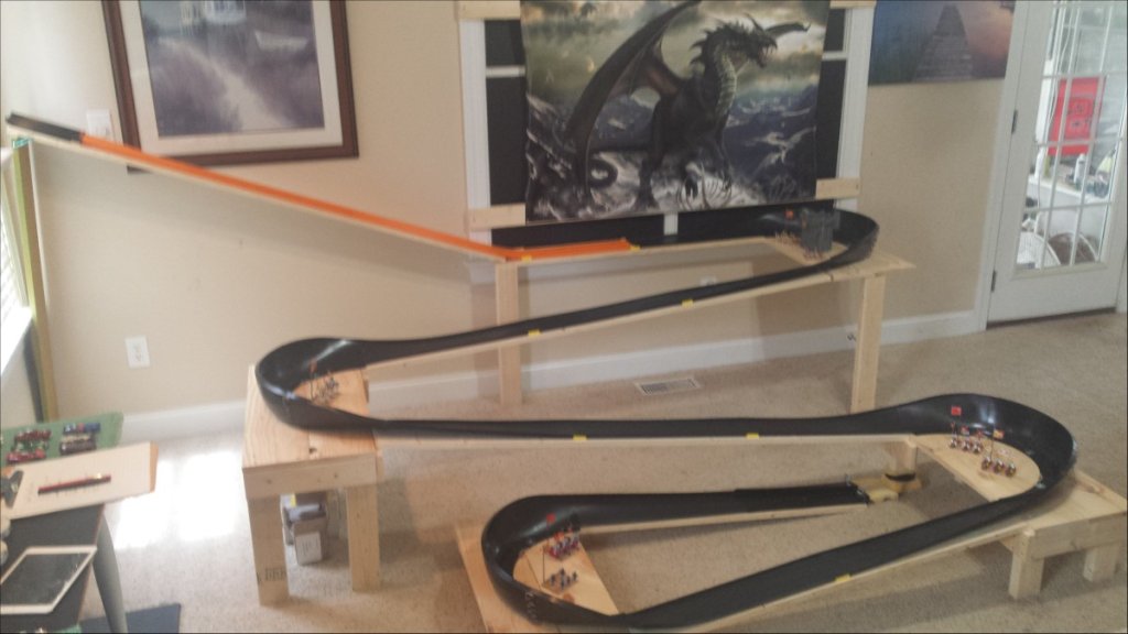

Tail of the Dragon...the  build journal has my measurements and notes as I go along with that Build...so check that one out.

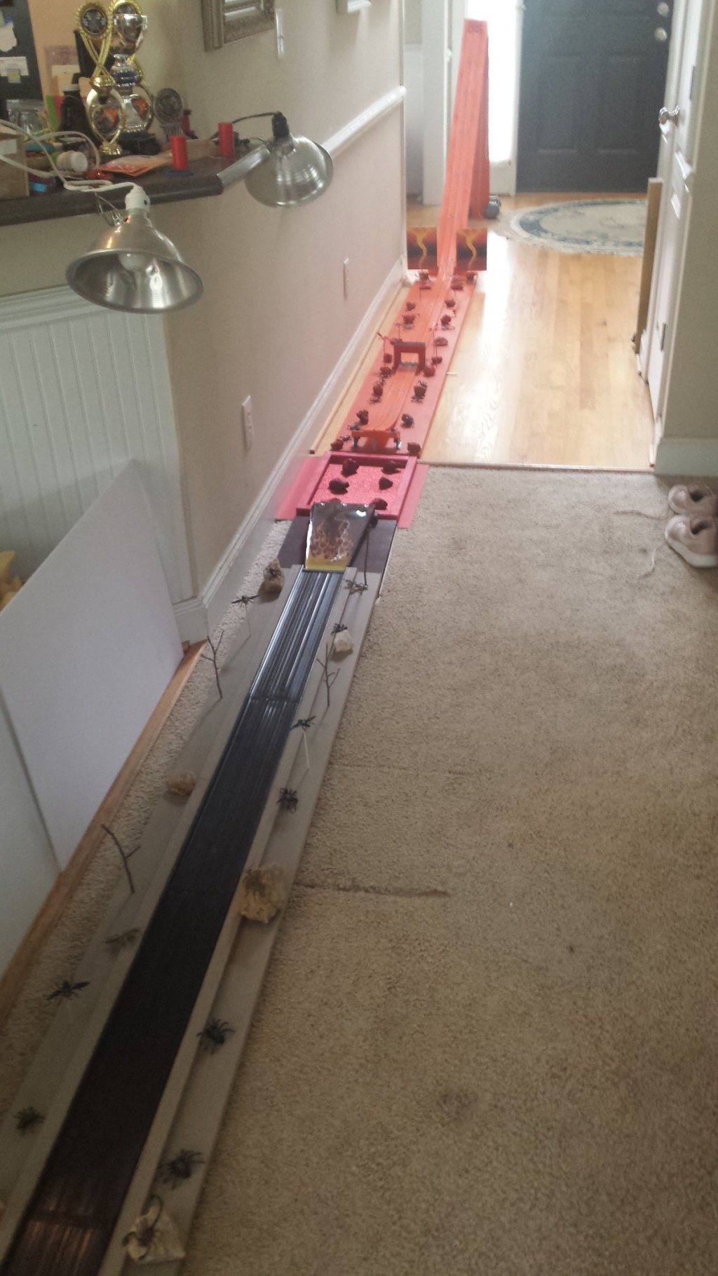

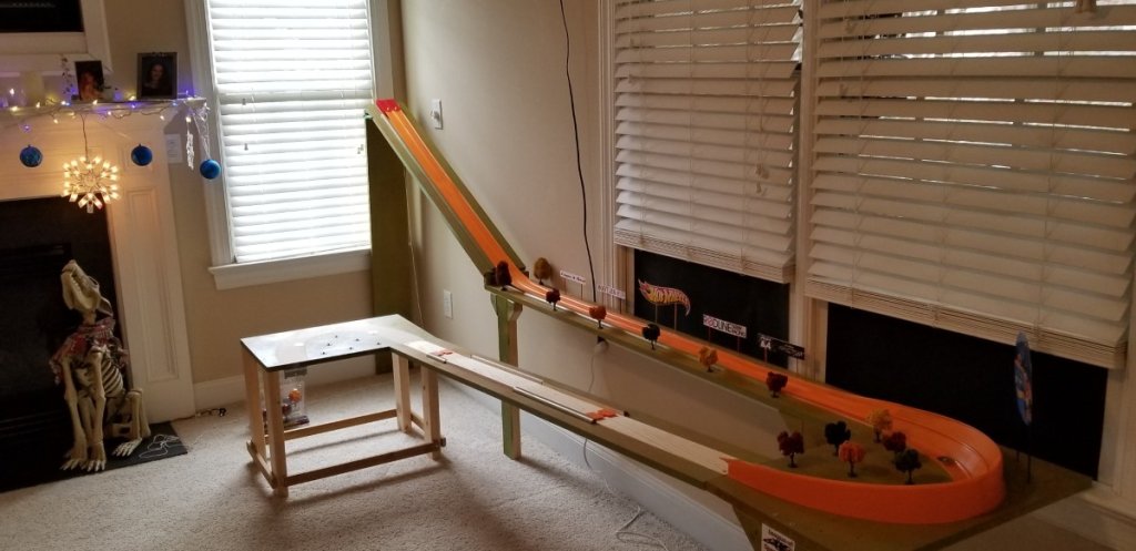

Some inspiration...
  • Beautiful! Great craftsmanship. — EcuWeeEcosse
  • Hi LoS, Marc D here. At the moment on youtube one is seeing many new build track designs. Unfortuneatly, many suffer from not being "dialed in" and the running results, for me fall short. To me, testing, adjusting angles in and out, wow, all make a huge difference to the result. Cheers — CutRock_R_Marc_D
