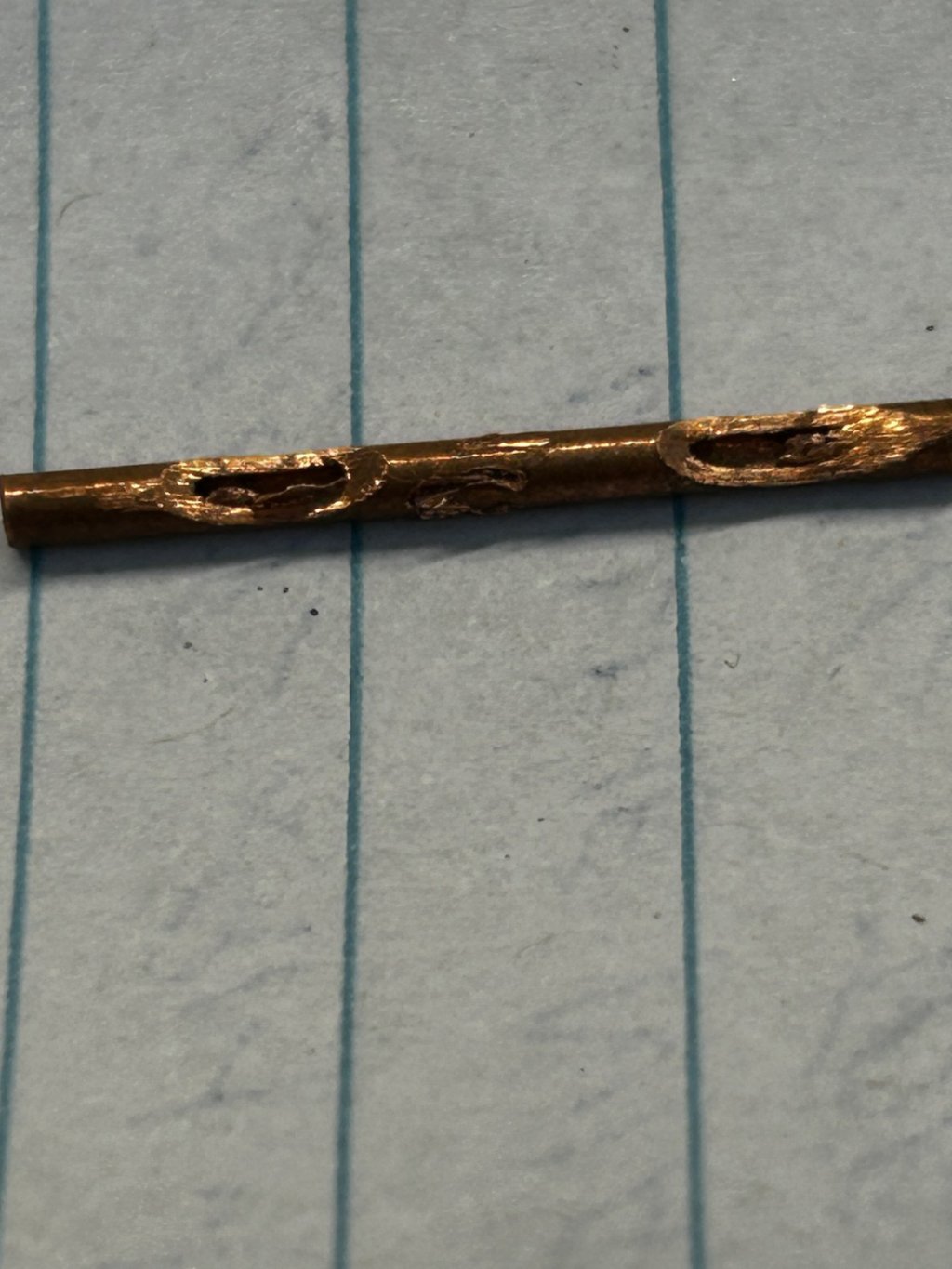

Use 1/64 (if memory serves me correctly) brass tubing. It will fit standard axles cut in half to allow for widening the stance. Cut the tubing to required length and using a dremel with drum sander cut two notches to create a space for glue (jb weld etc).
