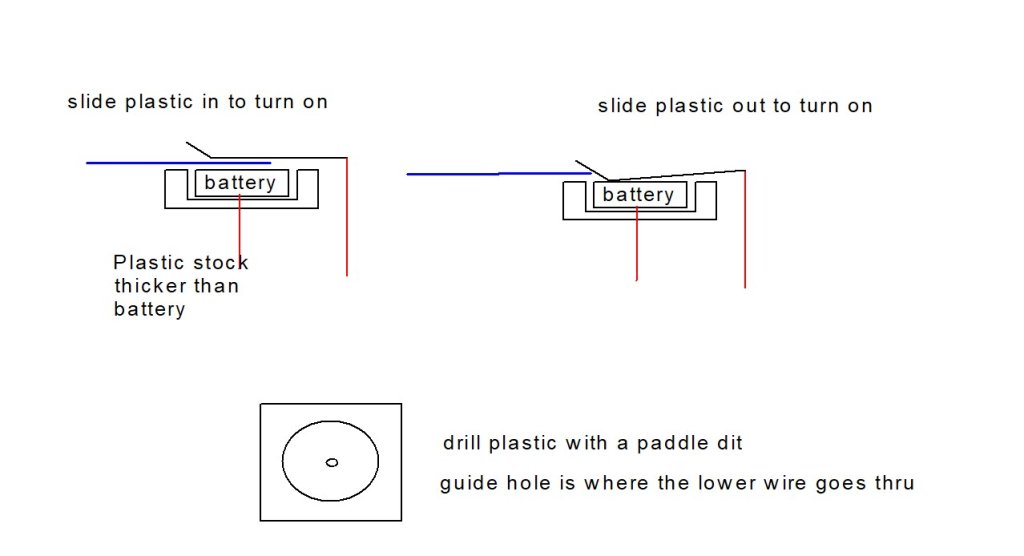

I also have been looking at lights
have done some experiments
if you use led's and a button battery,
this is what I was gonna do. use a wood paddle drill to make a recess in a piece of plastic thicker than the battery,
put wire thru the guide hole, wad stripped end of wire, solder to a lump bigger than the hole
bend flat stock as top contact
the switch is a piece of plastic inserted between upper contact and battery
diagram below
- clever... — Stoopid_Fish_Racing
- in theory, should be tough enough to handle a crash of two — dr_dodge
