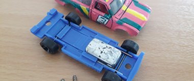

dr_dodge 3/28/23
My magic wand.  Variable temp from very low to smokin'
Melts the 158° allow nice, heats plastic for bending, and used on wood venier for making buildings
www.amazon.com/Walnut-Hollow-Versa-Temp-Temperature-Woodburning/dp/B005P1TRAS
  • I use my solder station with and old funky tip to remove and install wheel sets in plastic base cars. In and out in seconds. — Redline_Salvage_Inc
  • thats a good idea, I need to remember that. I have been using the wand to melt diecast into bodies to add weight — dr_dodge
