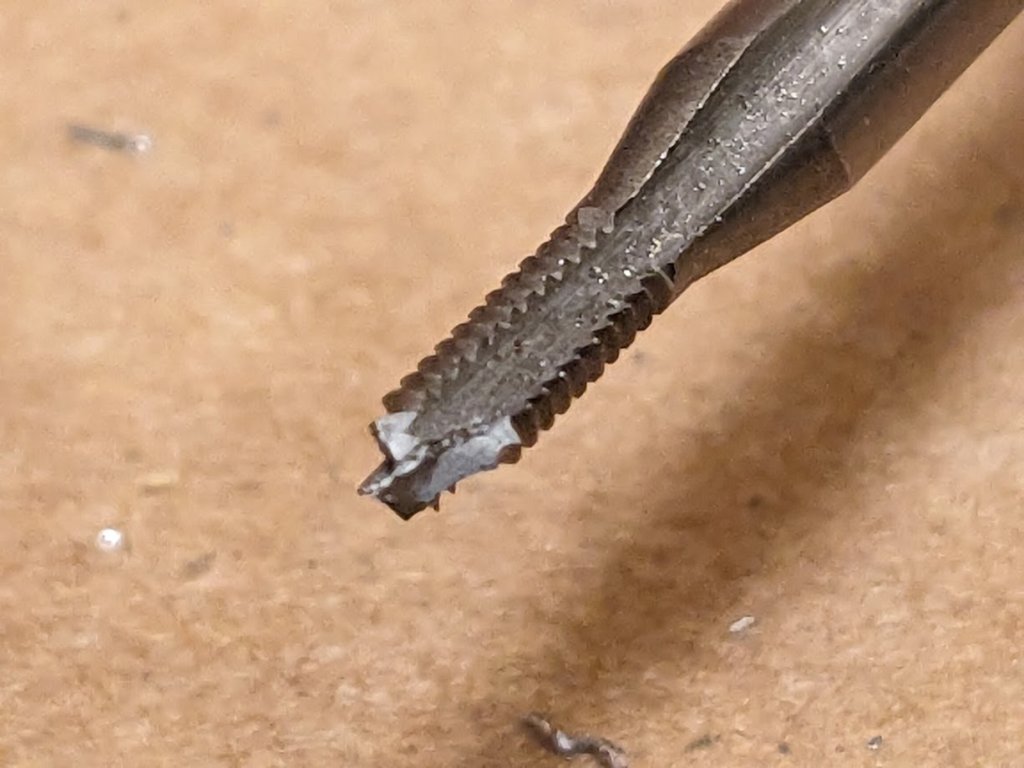

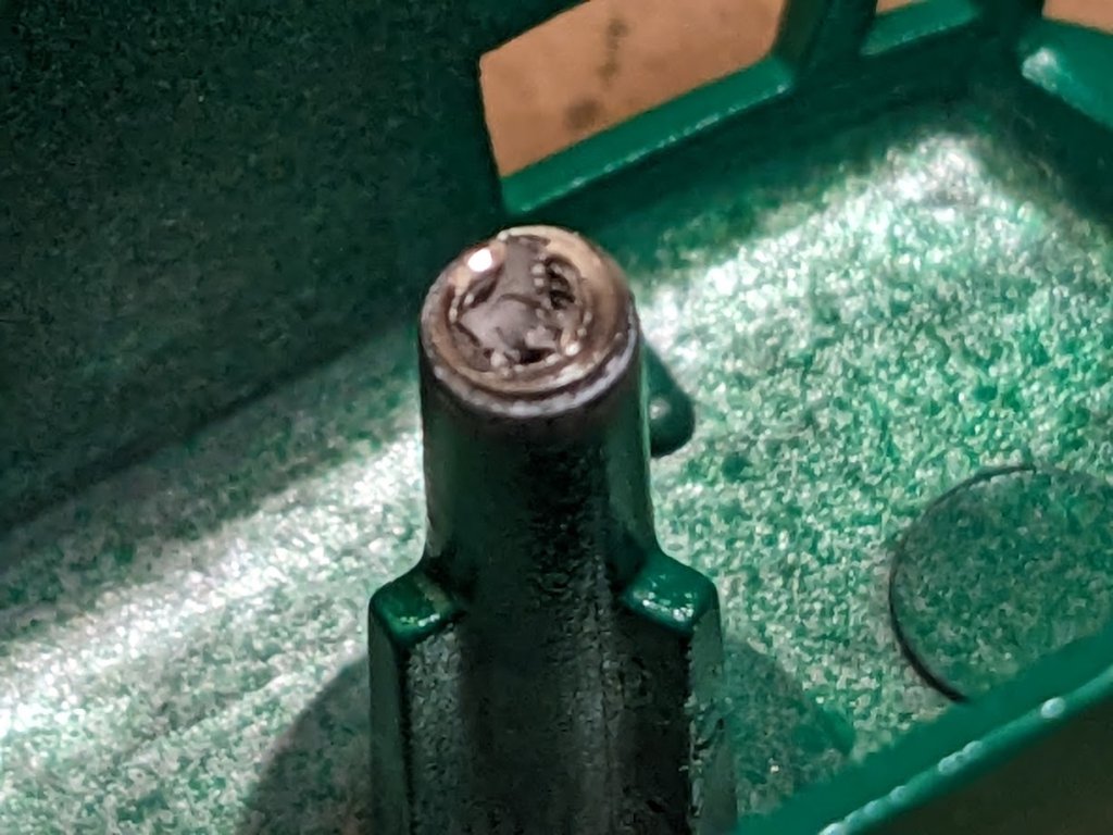

Anyone have advice for extracting a broken tap? I foolishly bought the #2-56 tap on Amazon that includes a #51 bit and the tap snapped on my second use. This is not my first time tapping, but the first time I've tapped something that wasn't a through-hole, and my first time tapping this small.
I've considered trying to send the #51 back through, not sure how that will go, but might give that a go. I've also considered snipping off about 2mm of the post to try to grab what's left of the tap and try to back it out that way. Thoughts?

saw the post around, grab cut piece of post/tap, attempt to remove by squeezing post stub with pliars, and unscrew

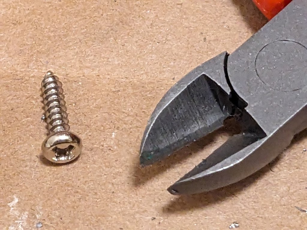

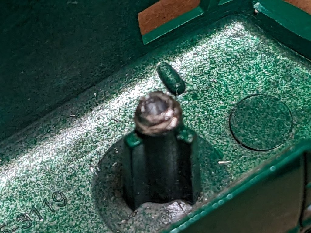

What I have done when this happens is cut down the post a little bit with side cutters to expose the broken piece of the tap enough to grab with vise grips and rotate the broken tap out of the post. Then use a spacer to put between the base and the now shorter post. It also necessitates the use of a longer screw to hold the car together.
