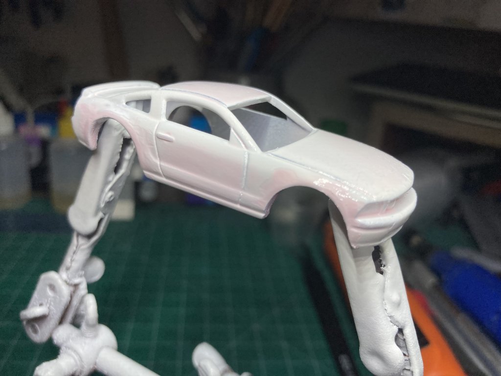

I've been at this hobby for over four years, but I was today years old when I realized that Hot Wheels Color Shifters will bleed into white paint. This is a maroon Mustang Color Shifter that I ground out the wheel wells and did a little sanding on top. It seems wherever I sanded is where the color is coming from. So, if you sand your Color Shifter, it's probably best to prime it before you paint it. I think I'll spray it red instead.
Had the same issue... Only certain paints though... 2X I think. I don't believe the Tamiya primer did... don't quote me on it though... I believe if you clearcoat it first it doesn't do it.

I've painted multiple color shifters and have not had any bleed issues, but I use a very aggressive white primer Base.
I am slowly moving to a acrylic water-based primer called AutoBorn Sealer
JBlotner42 4/1/26
put it in some paint striper first then paint, that's what I do.

I get bleed issues with a range of different plastic bodies. I've tried using an etch primer, silver basecoat, a black basecoat or a white base coat to try and act as a barrier. They look ok to start, then I put another colour over that and all of a sudden the original colour bleeds through again. Still haven't found an ideal solution. I've also tried a filler primer, to give a physical gap between the paint and still had options. I think if the plastic is coloured, it will always bleed through, but if the plastic is painted a colour it usually gets covered ok.
  • Fascinating. This was the first time I ever had a plastic body color bleed into my paint. I also usually don't sand or grind the plastic so that may be why. — FeralPatrick
