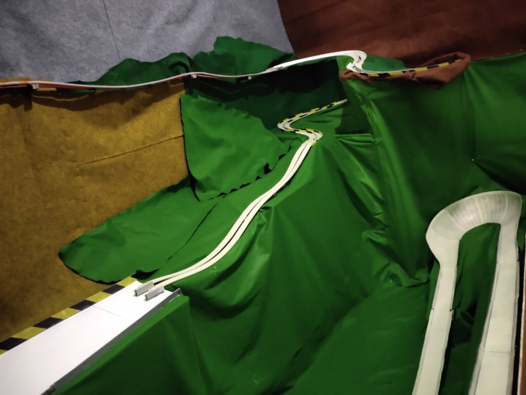

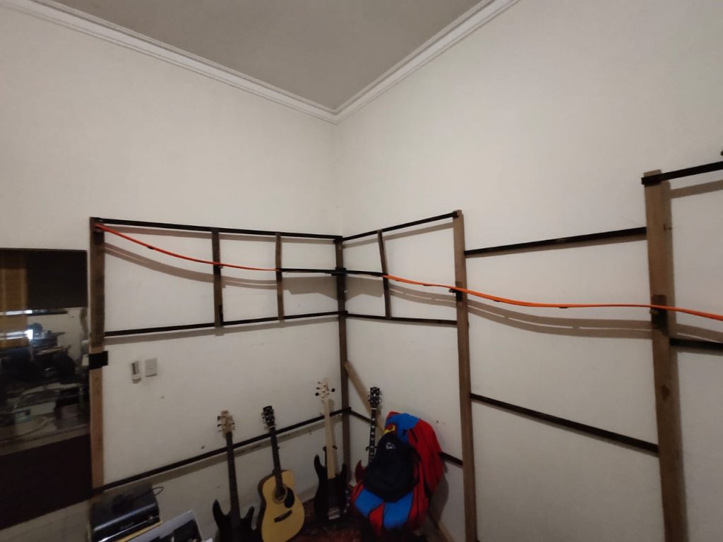

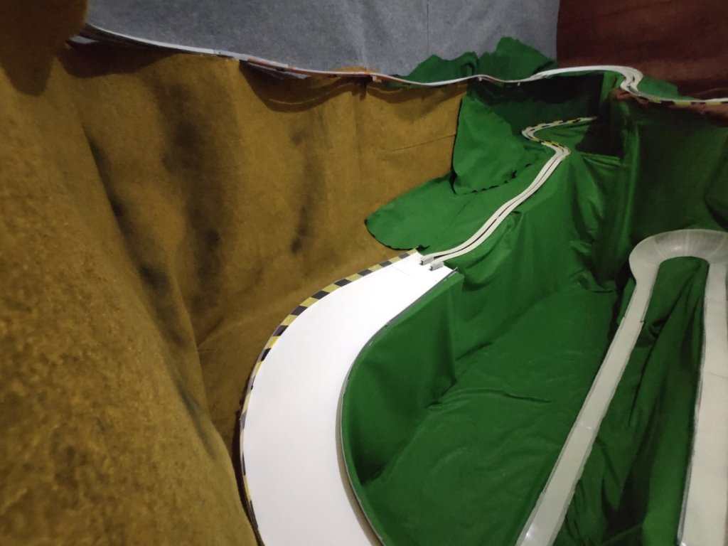

Hi Everyone,

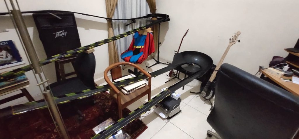

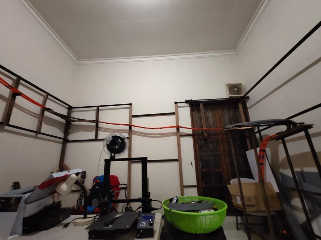

First of all, I'm glad finding this site and I'm so amazed that there are so many trackers contributing and sharing some of their tricks and tips for tracks building. Allow me to share my story building this tracks. On December 2020, I was so inspired by "you know who" the legend 3Dbotmaker content on YouTube. I started building using Curogated Plastic for the whole tracks.

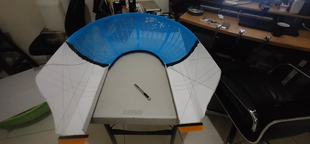

Then, I got stuck with the curves since I couldn't bend or make flexible turns. So, I had an idea to build it using this round shape found on my dinner table lol. My engineer mode was challenged and it was ok.
To be honest I wasn't that impressed by how it turned out, and i wished it could be more like car crash figure 8 kinda shape but it wasn't even that close lol.
So, I bought 3d printer. I studied drawing the curves using only Tutorial from YouTube using Sketchup. Then, the second problem occured. It took forever to create such smooth curves and it need to be designed part by part. I gave up easily and focused only making the track connectors only.
I didn't even think of making a 180 curve, the 90 turn already took me forever already. I gave up.Then, My Curoplastic straight lane started showing some problems also. The side lane angle seems to be miscalculated and make the cars slowed down.

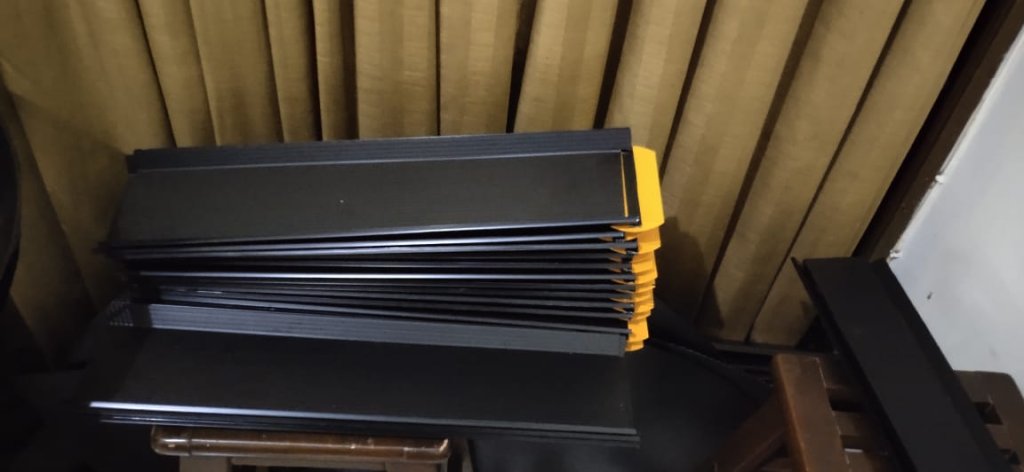

So I started using the orange tracks. To be honest, it was the best options for straight lane and the only thing I needed to focus was how to connect to custom turns. Thankfully my 3dprinter solved it. I could create any random turns and so my journey continue.
I then also Inspired by tyotoys in how diecast drift so smooth. So I had an idea to involve the drifting to my tracks. So this is my latest track so far.
www.youtube.com/watch?v=HUuK3hf76Yk
www.youtube.com/watch?v=Df-r5lGgdu8
To be continued (will discuss more about how to make turns from corruplast and car drift)

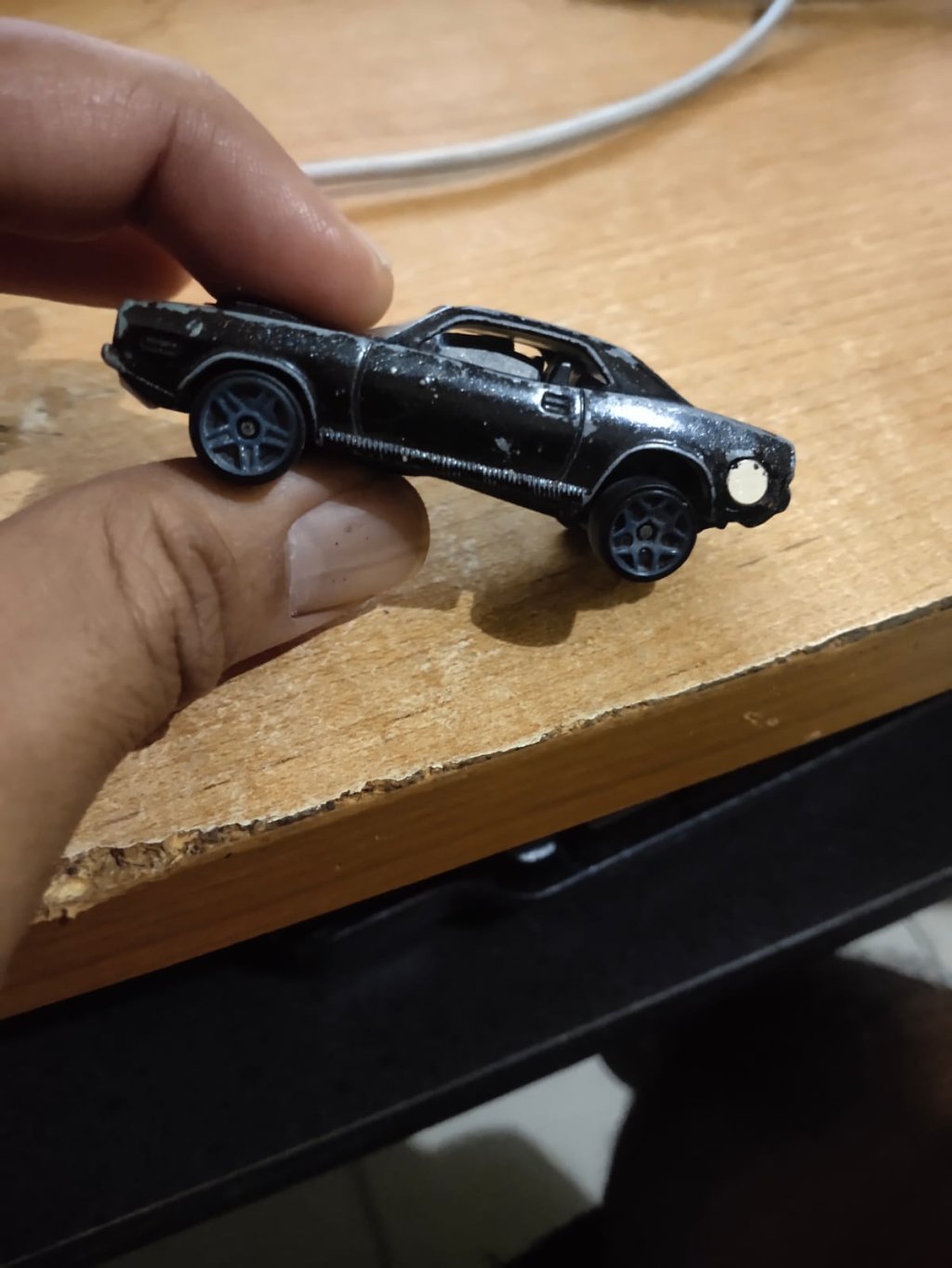

- Okay, so explain the magnets to me. Is there one at the end of the sectioned track, as well, so when the car passes that point, it kicks the rear end over into a slide? — SpyDude

- Correct, i will explain it in a bit. This may cause an issue to host a race? — setandiecast

- Lets make it then. Im curious wih all different mods with just 1 requirement, magnet at the left side rear only — setandiecast

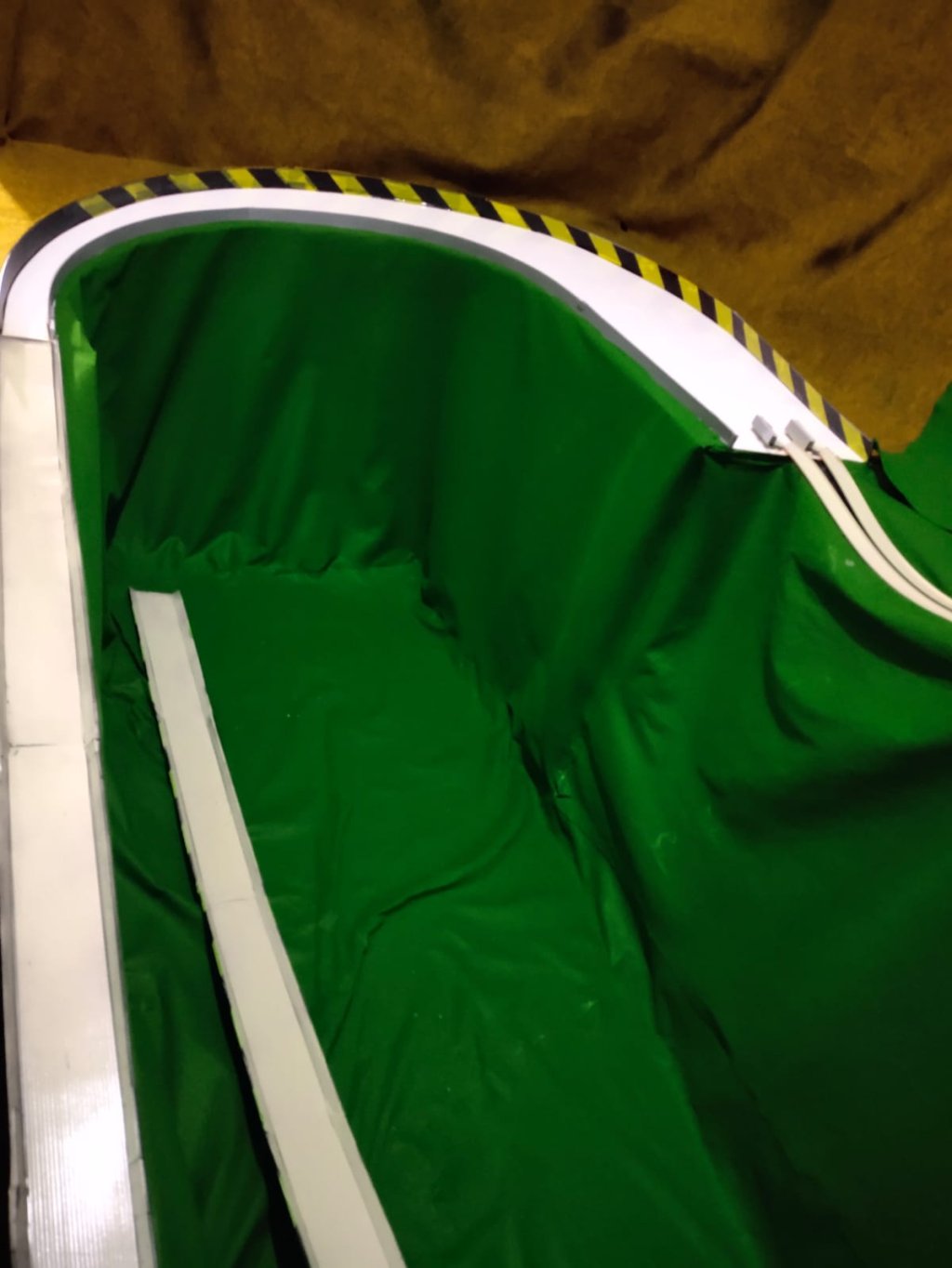

Detail for the Tracks:

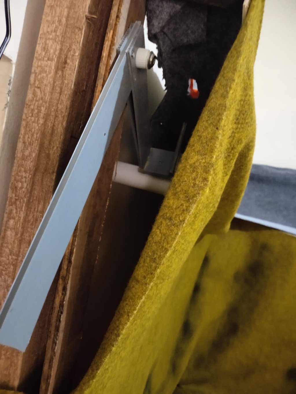

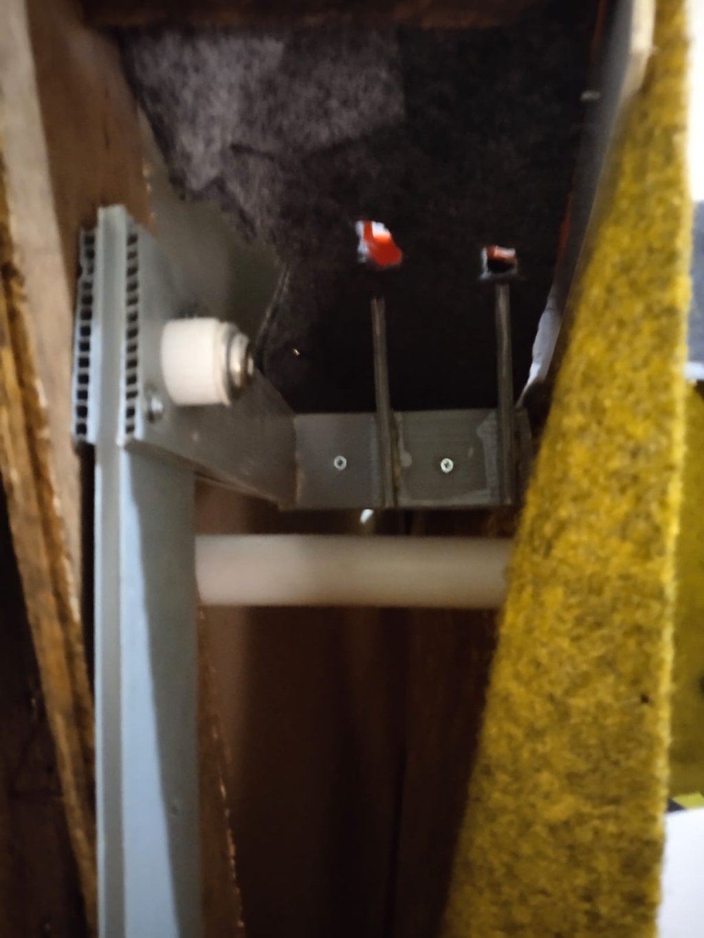

1.Starting Gate

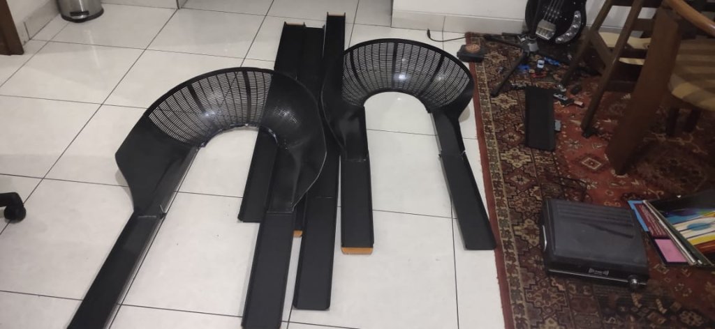

Mechanical Custom. I used Corruplast then create this L shape with the extention extention. Works ok so far.

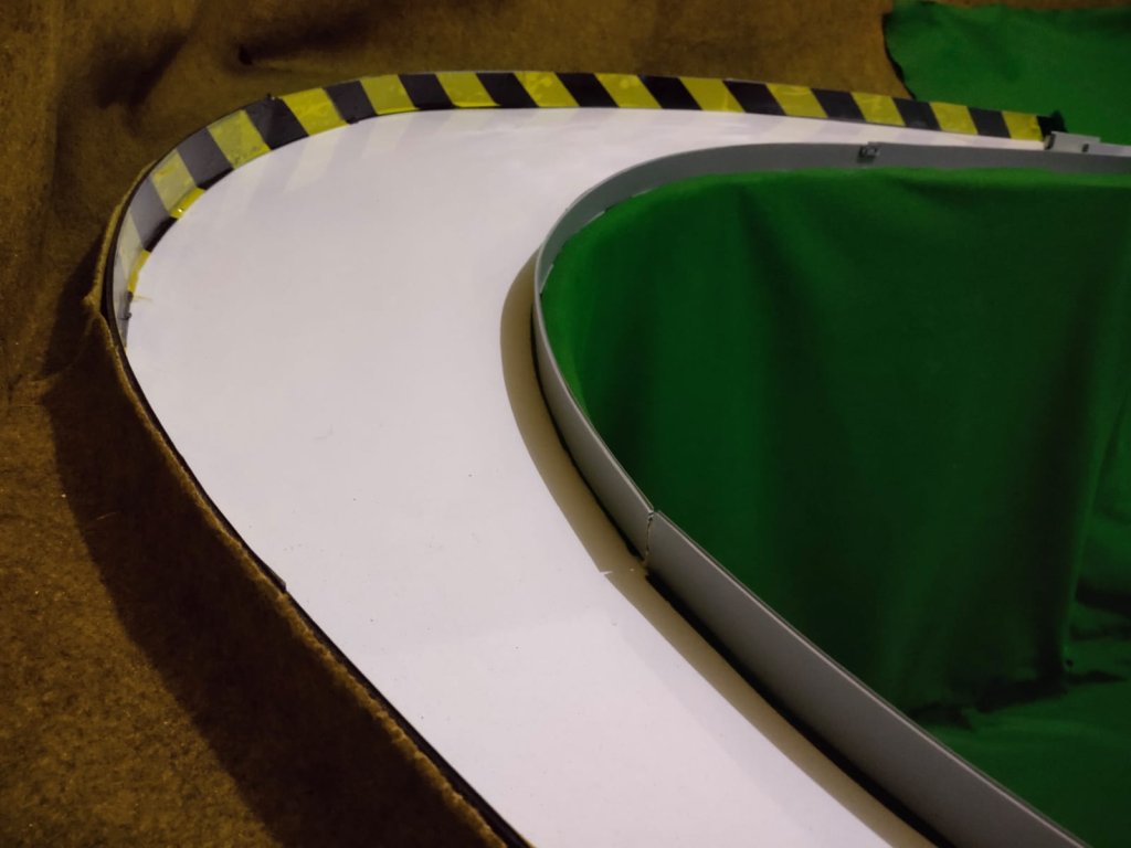

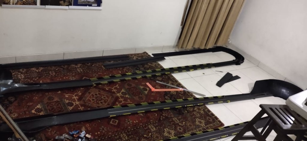

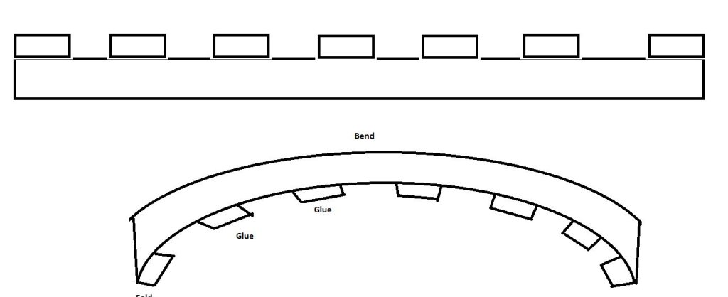

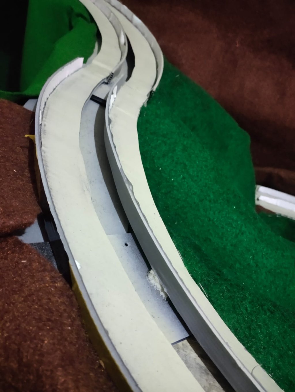

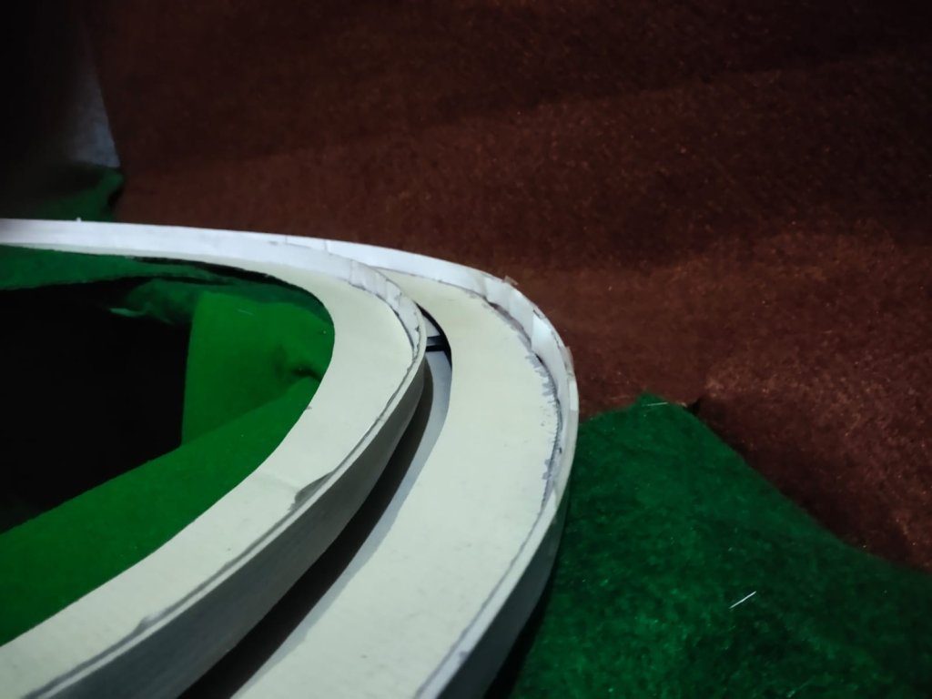

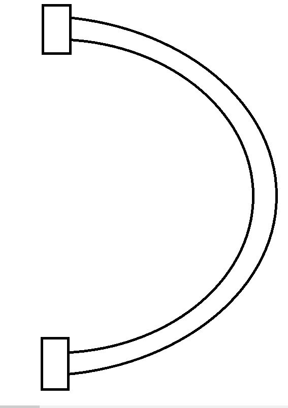

For the turns. I use also Corruplast but using one sided wall. It much better so any car will fit. For the wall/fence`, I create this bellow shape, fold the little rectangle then bend entire long rectangle. Glue the little rectangle at the bottom of the lane turns
This is how it looks from the bottom once you glued the wall/fence
To me it works well, I can create any random turns as the wall/fence will follow.

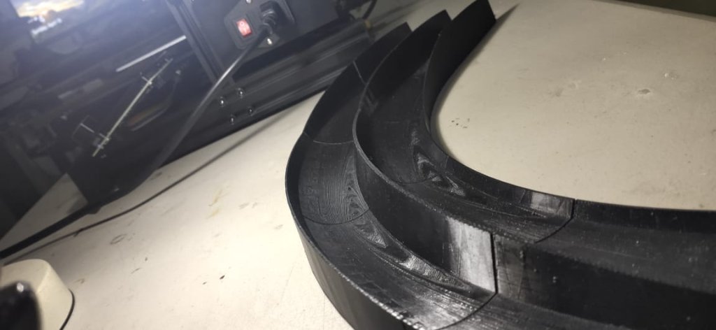

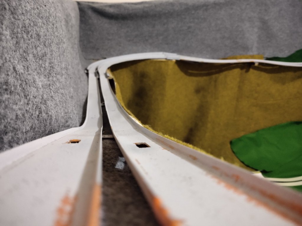

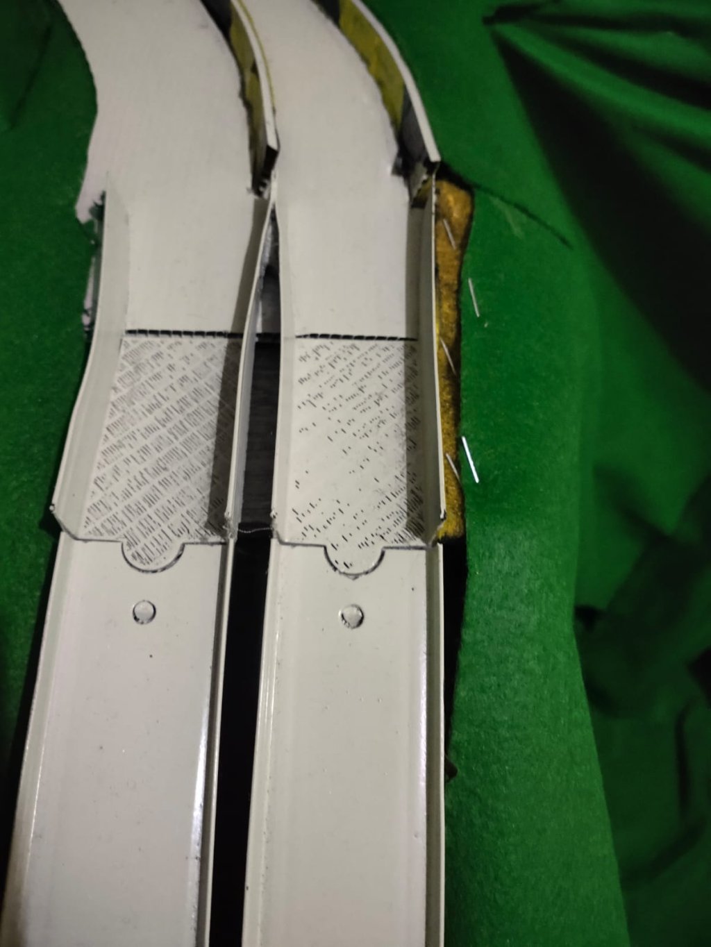

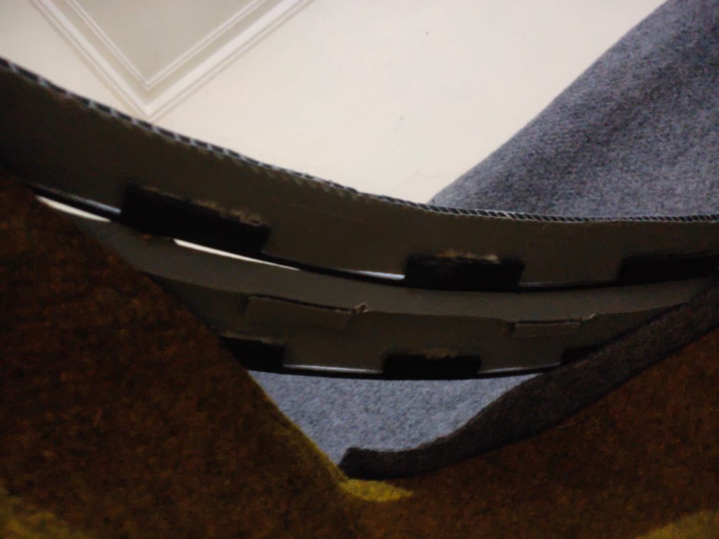

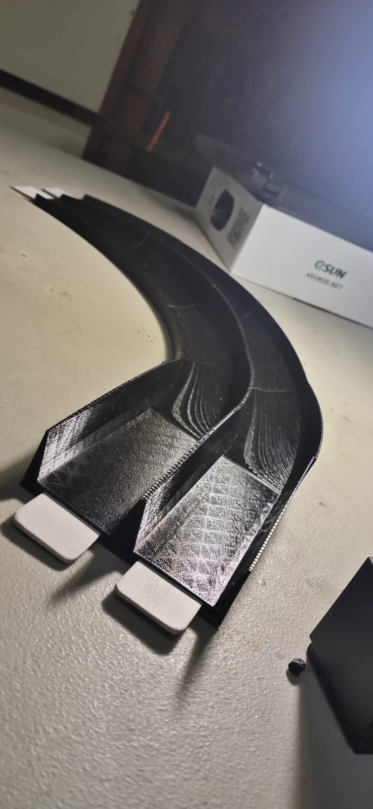

For the connector between orange and my corruplast turns. I used the 3d printer. I posted it in thingverse: www.thingiverse.com/thing:5024743 . For everyturns on my corruplast at the end and the begining i cut it this shape so it'll fit with the connector. This way the cars gets stabilized after the turns to go to straight lane.

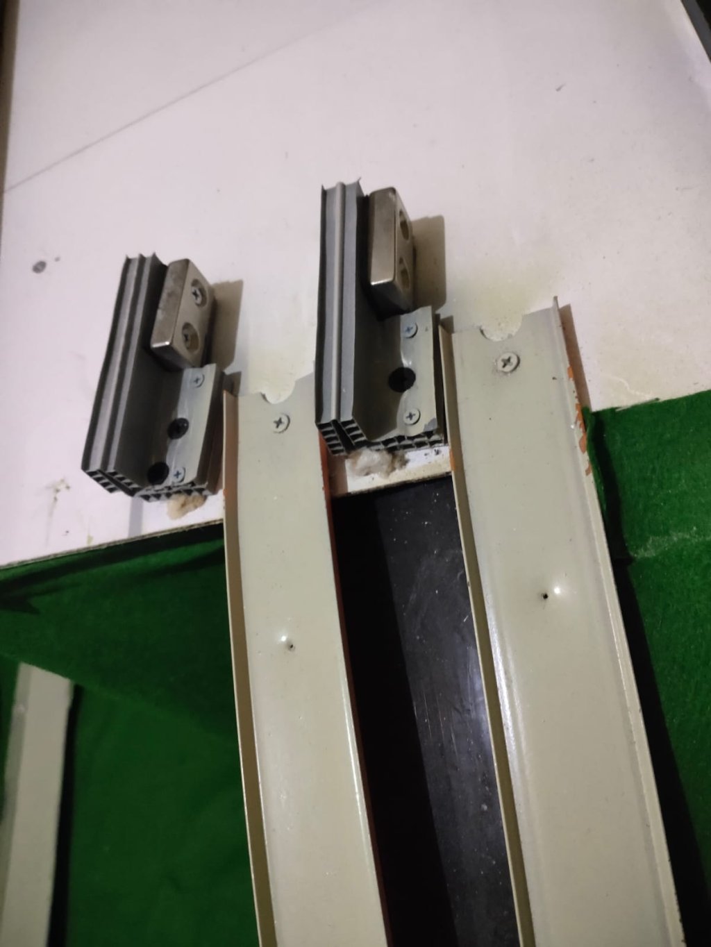

For the drift, I used magnet at the end of the orange tracks:

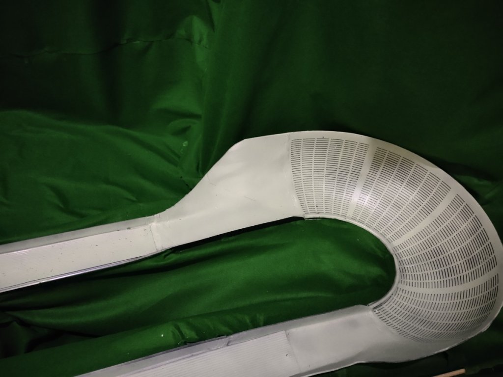

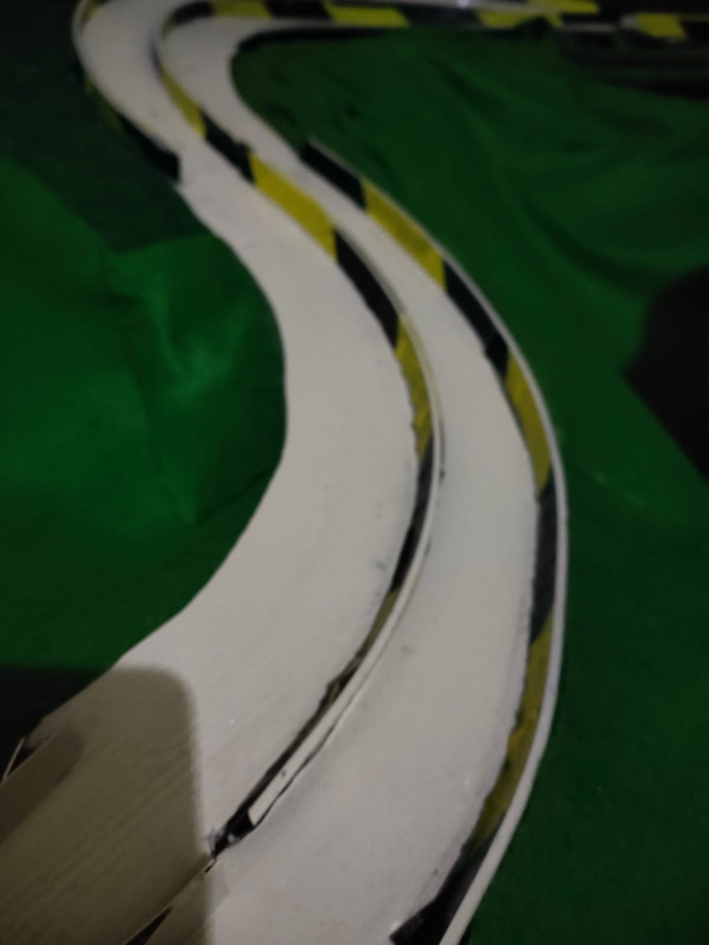

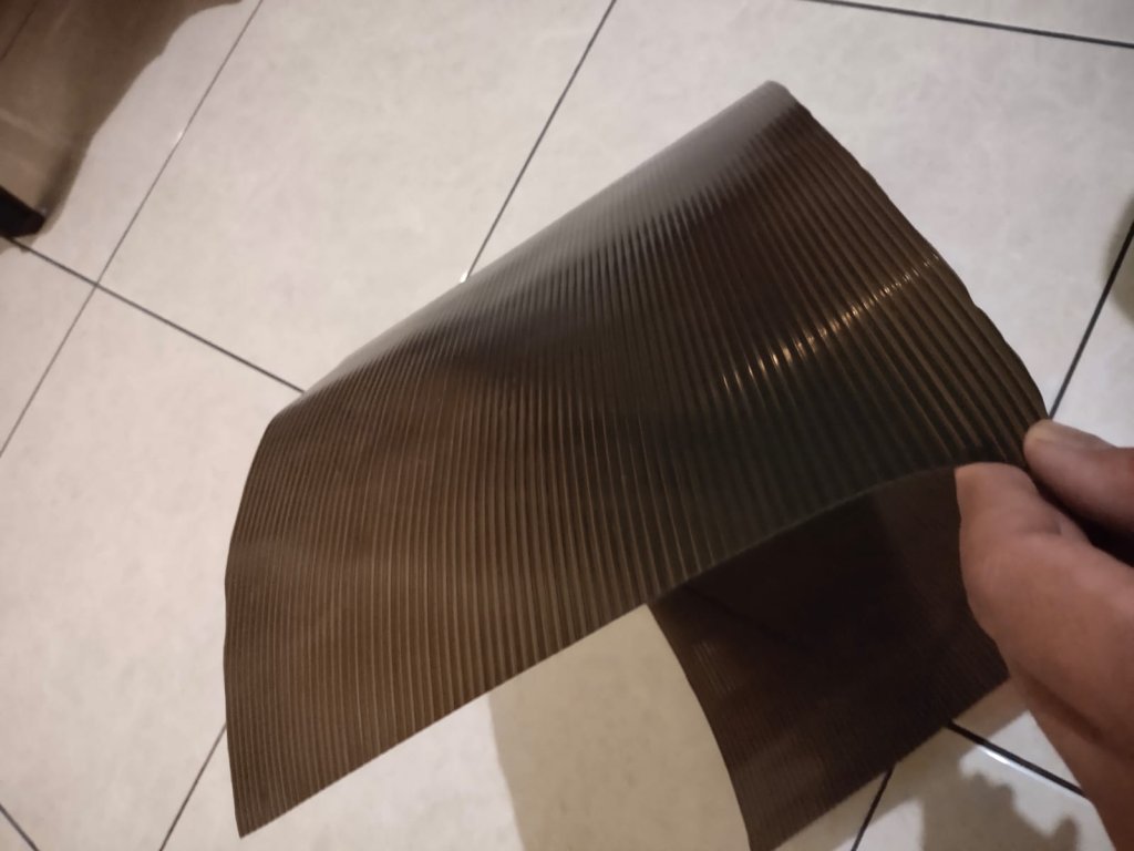

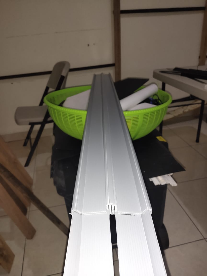

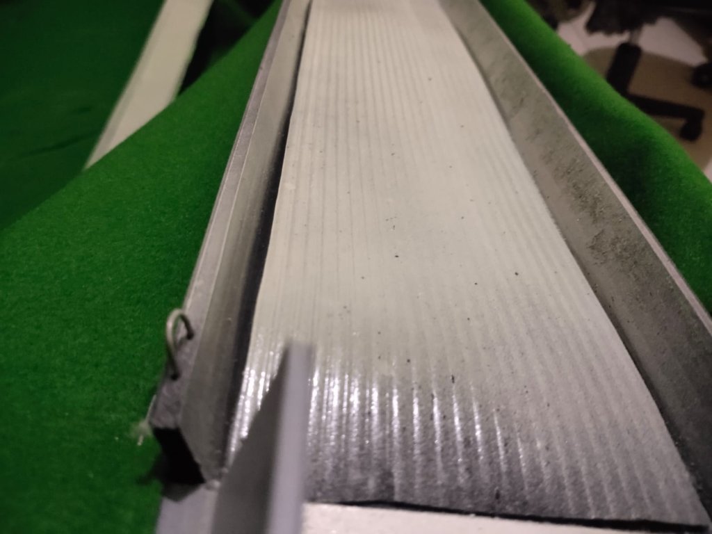

For the openlanes i used also Corruplast but on top of it I layered it with this type of plastic material so it will have straight grid and make the cars more stable on the straight lane.

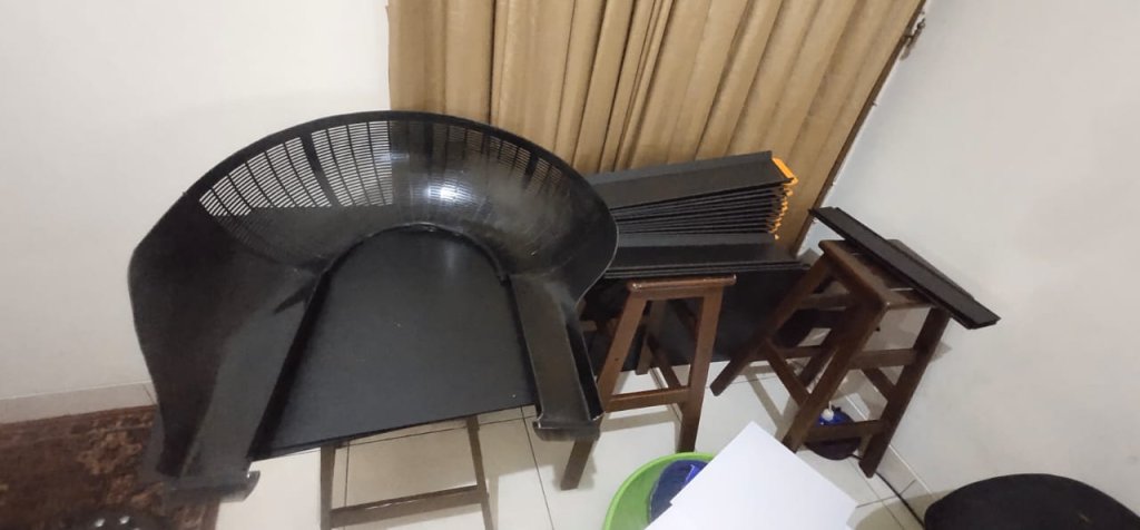

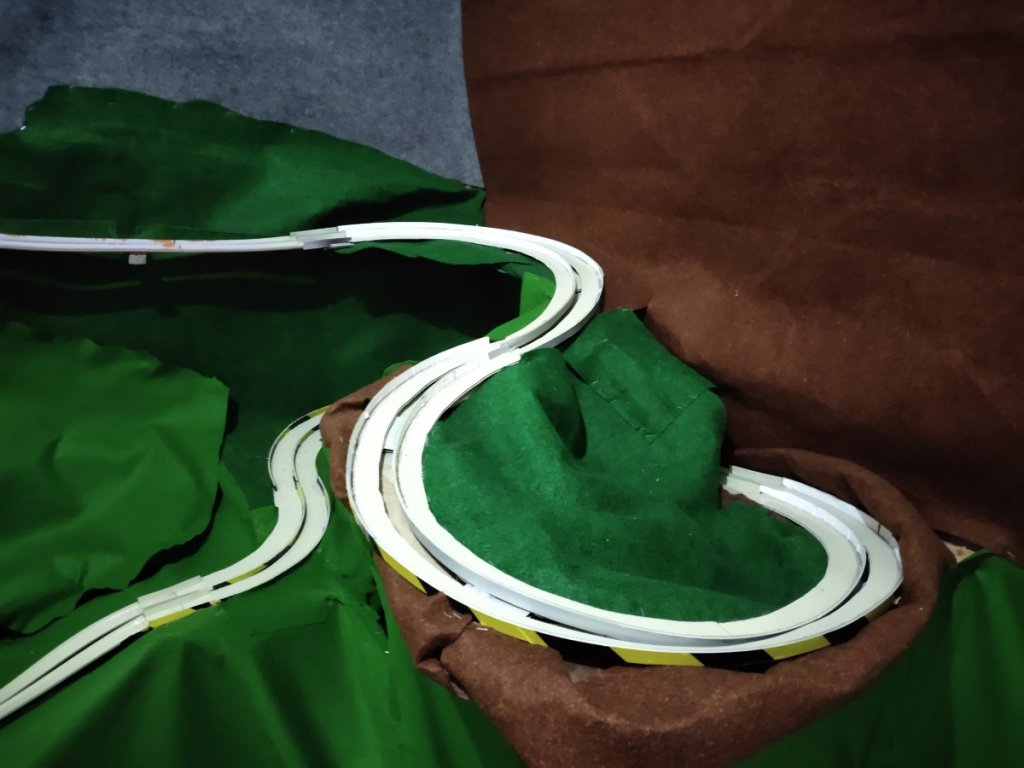

Last but not least, for my drift pad full scale, I used this thin whiteboard material ( wood ) and cut it into a C shape. I use the same tricks for the wall/fence like above. At first it wont be that slippery, but I used this crystal powder for 5cent and it works. The cars will drift randomly then you need to learn from SpyDude to modify the cars using some weight at the rear.
I guess that's all i can share for now. I haven't finished reading all the tutorial from this site and looking forward to improve my tracks definetely.
Oh for the salad bowl curve, I cut the bowl in half and glued it with PVC board and shape it using a heat gun.
