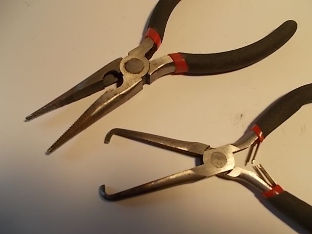

if you pry the axle anchors [prongs] back to remove the axles on metal or plastic bases, and if you want to re-swedge the prongs for new axles you might make a tool just for that... I heated the tips on a small pair of needlenose plyers with my torches, then with regular plyers I bent the tips 90*..,. I offset them because the underside of the base can have lumps and bumps, this let's me find a good spot under the base that will let me crush the prongs over the axle...
Diecast Cars, Hot Wheels, Matchbox
with metal bases you may need to pre-heat the tool's tip with a candle and hold it against the prong you want to crush for a minute, this keeps the heat away from the wheels, the heated tip will soften the metal and keep it from snapping off.
