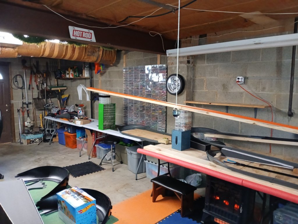

I changed it around again. I also wanted to show everyone that I am listening. This is all of my crash racers straights. Each straight is approximately 85 inches long. Just a simple 3 180° turns like I wanted in the original post. Thank you everyone for all of the advice. It really helped.

Added another 2x4 for a smoother start. I need to buy a couple more 2x4s so I can add one more turn

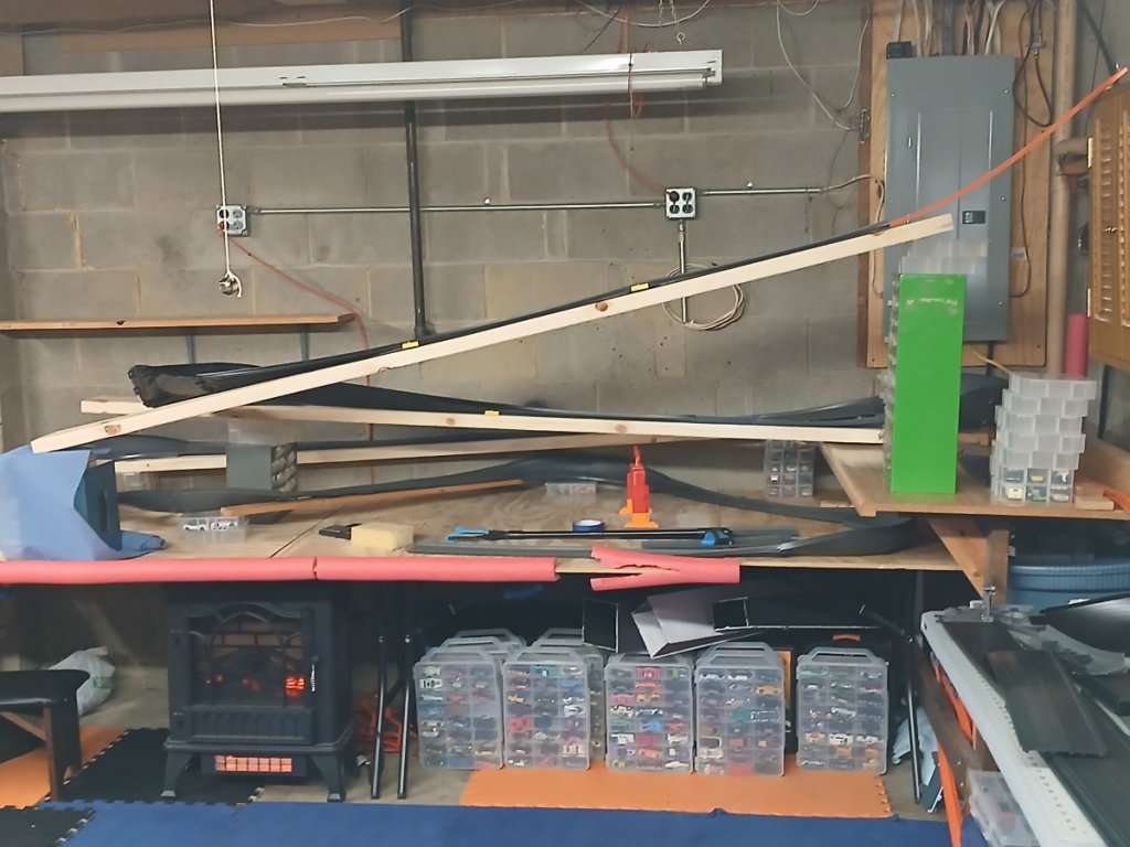

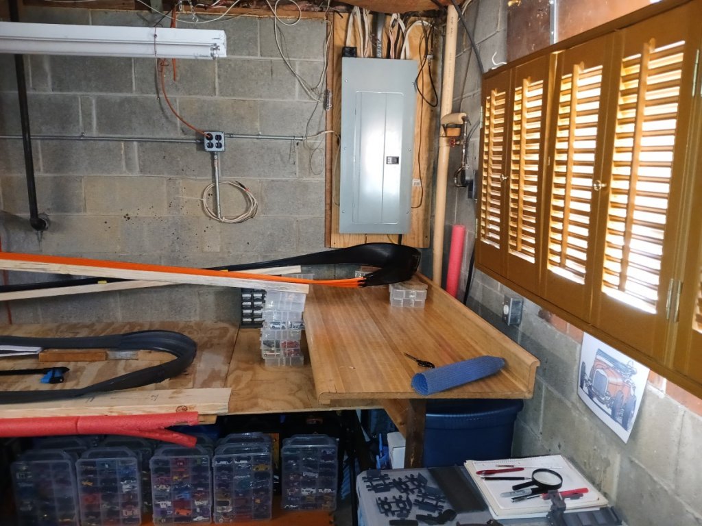

Got the 2x6s I bought 4 but, I am only using 3 at the moment. Just trying to get all of it dialed in before I commit to cutting any wood for supports.
I basically just have to get my angles just right now.

The beginning is way more than you need. If you just had the orange track the way it is and leveled off the rest of straight before first turn i think it would work really well. You just coming in to hot... I've built multiple tracks and never had it start like that.

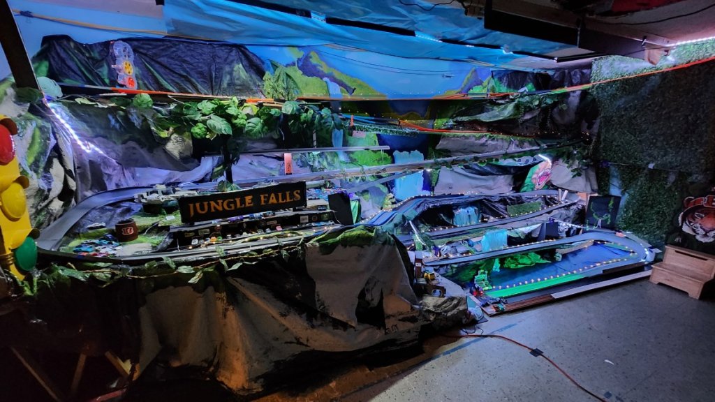

I built Jungle Falls Raceway. It's a long track, 112 feet long to be be exact.  My starting point is about 8 inches tall. Then it almost levels out completely before first turn. Gravity will do most of the work so try and decrease starting angle by a bunch.
As far as getting track to stay together I succure my trurns by screwing them down into support structure and if needed use a hot glue gun or double sided tape on bottom of track for extra strength.  My track is 7 feet tall at start and i have 7 levels. It works for most stock cars right out of blister pack. I will Gladly help with any questions you have. I enjoy building tracks and racing. I also enjoy being able to watch the cars in real timewithout it being a blur.. please feel free to reach out if  you need help. I will help any way i can.

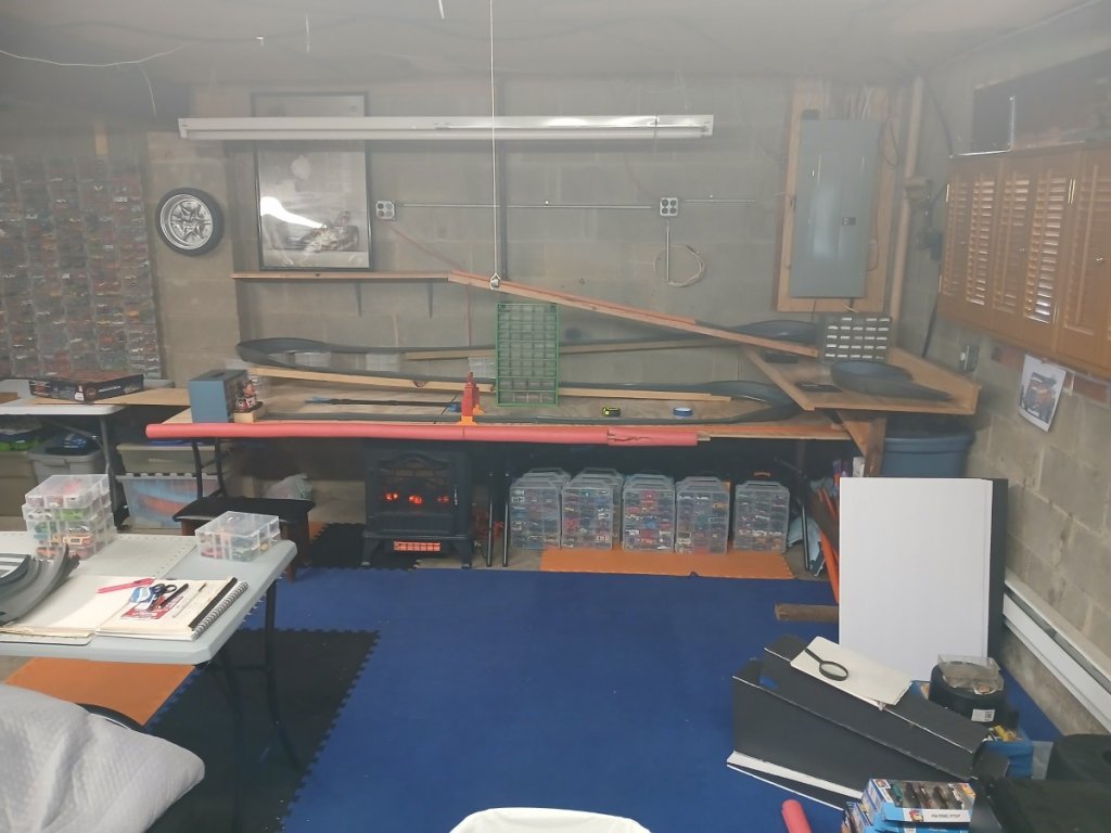

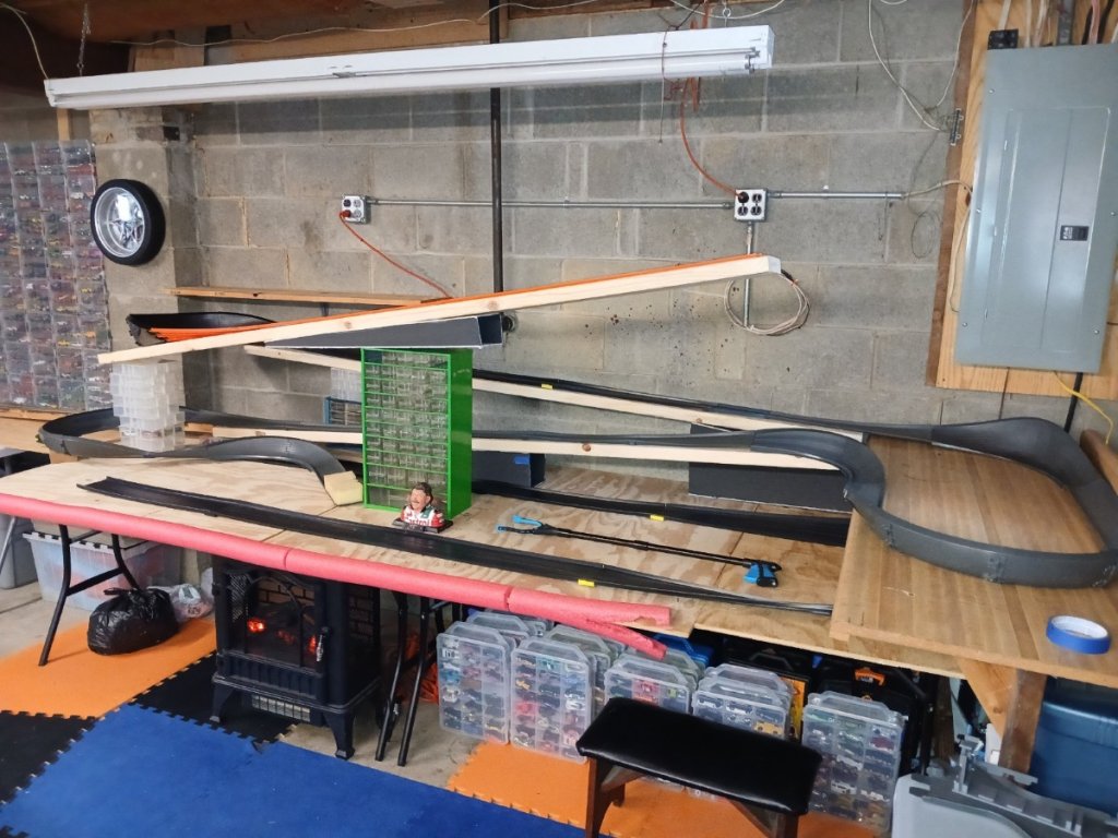

This is how I want to setup my track once I get all of the parts I ordered I will be able to drop the start section down and race RC cars.
I am getting confused though. Half the people giving me advice are saying start high and the other half say the start angle is too high. Well, I can confidently tell you the cars drivers commit suicide and jump the track if I don't have the start this high. I have tried all different weight classes and cars with varying centers of gravity and they all have the same results if the cars don't have a fast enough start. I don't expect the cars to make it all the way the way it is configured in the picture until I get the parts I ordered and even then I don't expect any Hot Wheels to make the last Fat Track turn.

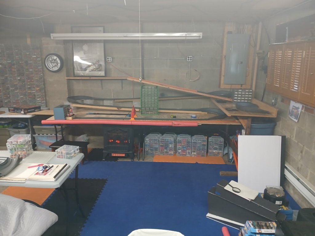

This is where I am at. I still feel like I can tweak it some more before cutting any wood for supports.
  • YEAH, Now we are talking! that looks great, and I bet the cars preform much smoother. — JBlotner42
  • They do but they still don't make it as far as I would like. Like I said I still have some tweaking to do ???? — thediecastninja
  • The ???? at the end is supposed to be a laughing emoji — thediecastninja
  • I think this is looking great. My one suggestion would be replacing that first curve with a 2 lane curve. Then placing one orange track piece, even if its just an 8-10 inch length, right after the curve so that the cars keep their speed and stability leading in to the open track. — ChaseFamilyRacing
