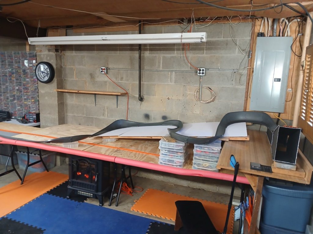

Hello everyone. I am new so, if this is in the wrong place feel free to delete or move this. If deleted please direct me to the correct place. I am super frustrated. I am following all the information I am finding about setting up a simple three level track and it just isn't working right for me no matter what I do. I have every large manufacturer part imaginable and either the cars fly off the track from the tiniest bump far too often or they flip onto their backs. I can't keep the tracks together even with tape. I get to have fun for about five mins tops. I have been working on this for almost five years and I am just ready to give up. Please help me

Welcome Ninja, Wow, I count six 180's, show us more pictures. We got builders here and some of them have 3D printers. These guys are smart.

Welcome.... and hold on to your seat, these guys that build and race tracks will chime in... Your in the best place I have read threads like yours and the results of their builds worked out.. Sorry im not a roadie yet but read alot on this topic. I like the layout..
With just one photo it looks like you have (from start to finishline) Crash Racers Nascar (Figure 8) to Regular Crash Racers to Sizzler FatTrack.
The quick fix would be switch places of your Nascar CR curves and your Regular CR curves. If it were me, i would take out the Sizzlers all together and delete 1 Nascar Curve to make an extra long finish straight. Your drops look so fast that any casting with decent speed is gonna fly.
I know space is always a factor, but longer straights with less of an angle, 5-7 degree tops, and less 180's will improve your cars staying on the track.

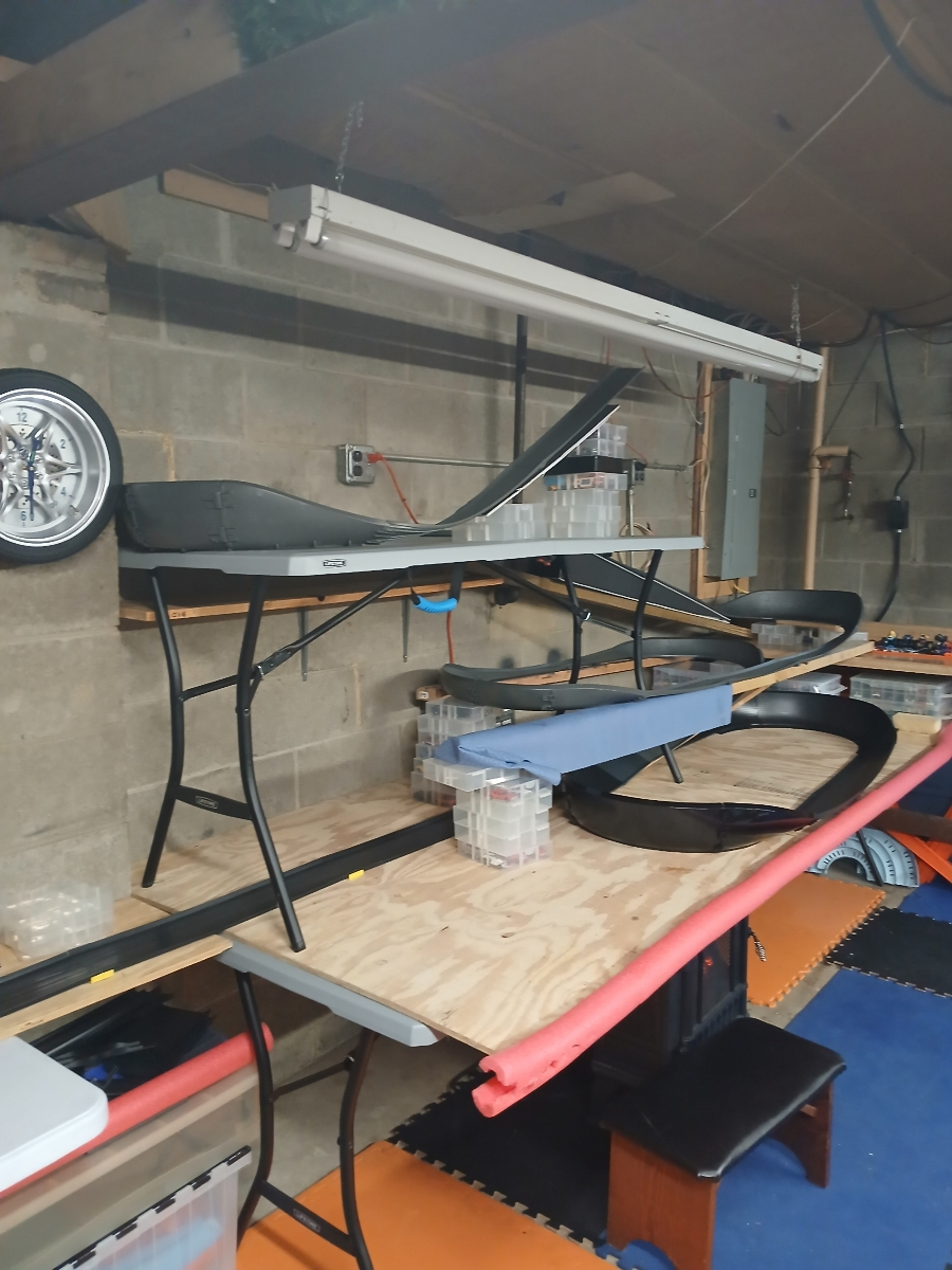

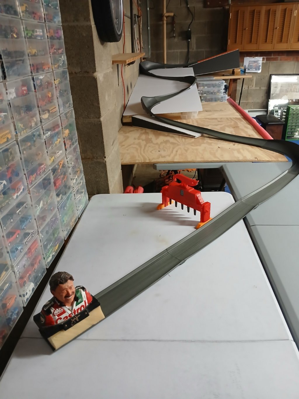

I changed it around. It is still not good enough but much better. I'll shoot some videos this weekend. Thanks again for all the help.

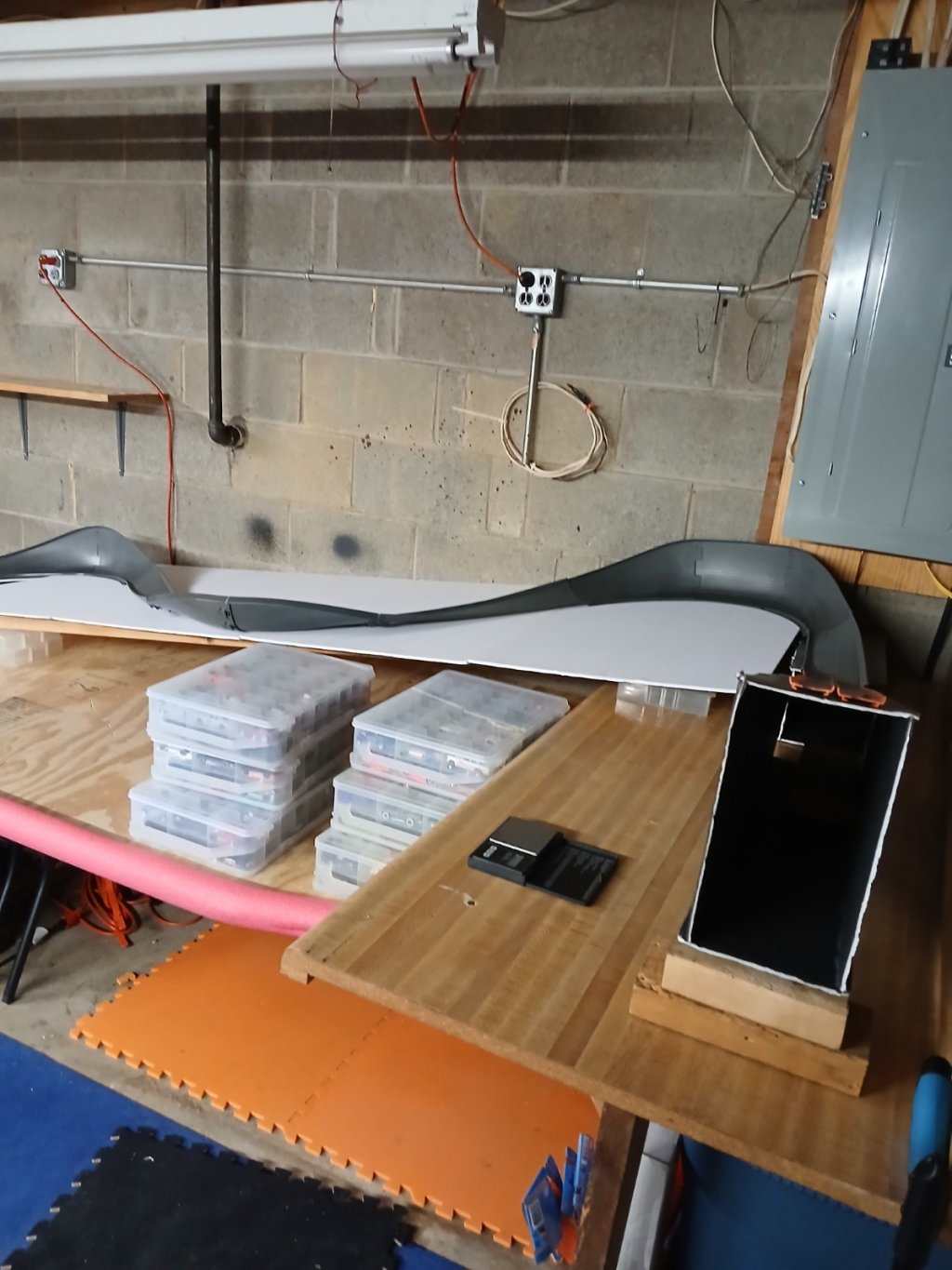

Final configuration for tonight. I am much happier now. Will shoot some videos later this evening.
- I like it! — JBlotner42
- Cant wait to see the video of the new design running cars.. Main thing is you are happy with it and enjoy the hobby your way. That is what its all about... — Desert_Rat_Racing

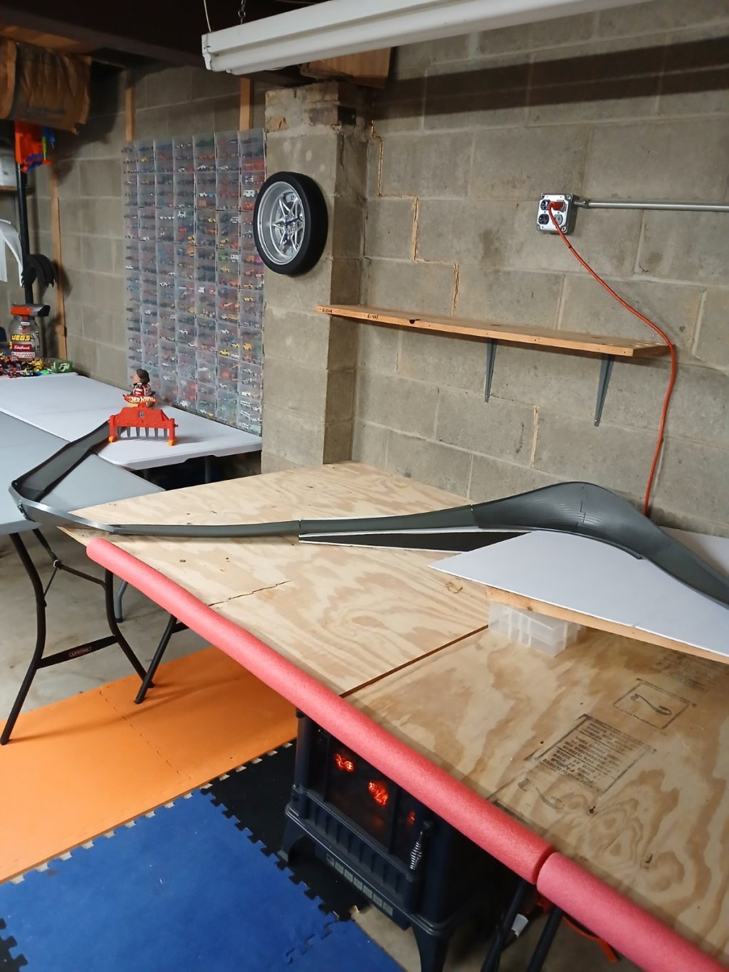

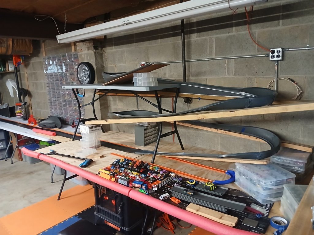

- I took all the high banked turns out. Still not happy. Waiting for my friend to get off work to do the videos as it is kind of a two person job. — thediecastninja
- good luck! — dr_dodge
- This looks hairy! — LordSyosset
