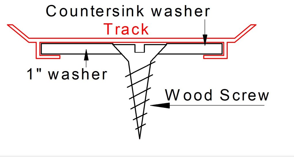

This is what I do, use a 1" washer that slides into the orange track.
#8 1/2 inch long screws, use a countersink bit to make a slight bevel, or the head of the screw will push the center of the track up
to set the screw, take a short piece of orange track, make a hole in the road surface.
Slide the washer in the track under the hole, screw in the screw, and use the track to make sure its down, but can slide so you can install the real track.  also, you can slide the washers into the track,
not attach them, and their weight stabilizes the track from moving.

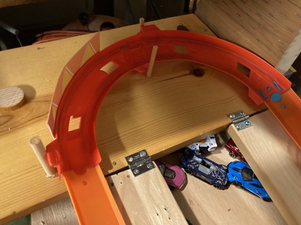

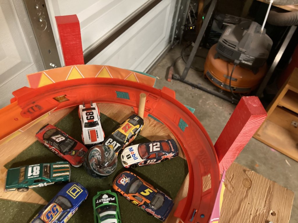

I'm a little lazy and I like to be able to easily make changes to the track if needed. But Idefinetly want the track locked in place to increase speeds and consistency. I use wood dowels and or pieces of scrap wood to brace or lock a track down. A little hot glue and the wood bits hold the track in place. Some rough shots below.
