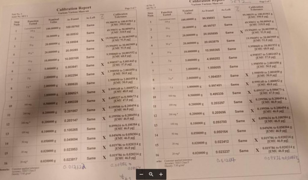

So, as some of you know, I do calibration for a living.
Well, while surfing the daeth star (amazon) I found something pretty cool

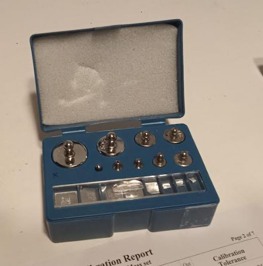

A mass set for $11, very similar to our everyday mass sets
100 grams to 10 mg

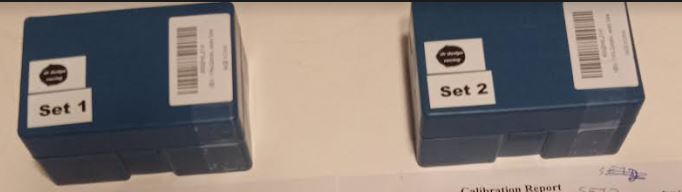

so, for measurement purposes, I bought 2

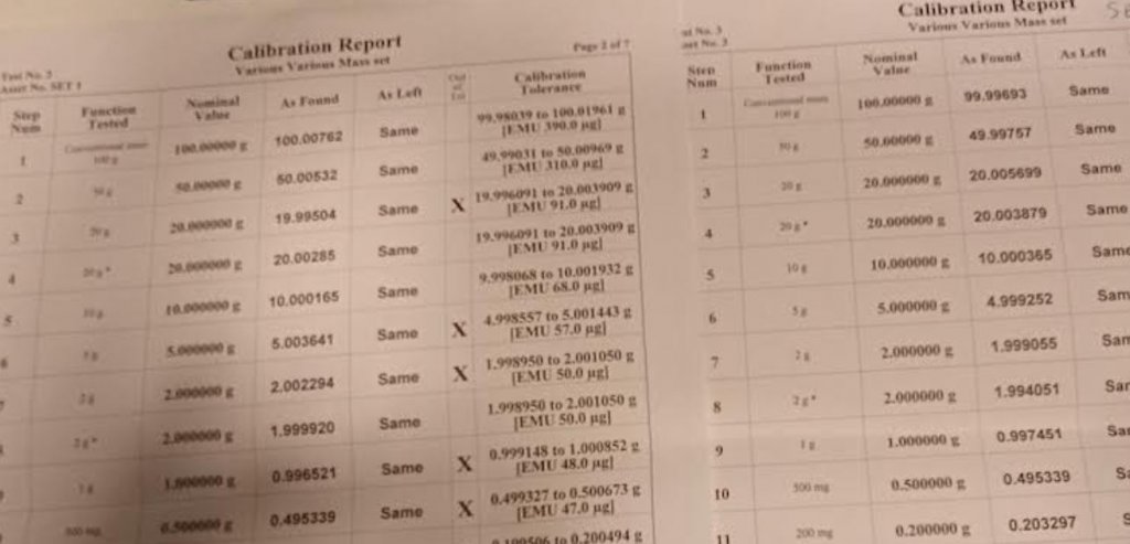

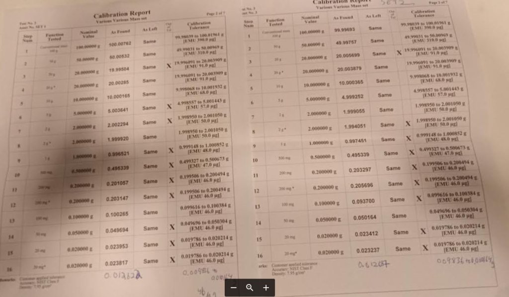

So, we shot numbers on them as a Class F
a little adjusting would dial them in nicely
I plan to do another panel on cal'g you scale, and how to get an extra digit of resolution on a scale later
the main masses you would use for scaling cars are only a few mg from passing
also, we always take as found data without cleaning, so these masses are truly open the box and run them (EMI is basicly the uncertainty of the value recorded about 50 micro grams)
Both mass sets lined up pretty well
not a bad deal for $11. I'll use my scale at home to dial these in.
