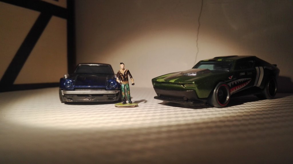

So, I've started modding these 2 guys, first time I'm doing it for speed.
Opened up both, charged them with putty clay and some nuts to add weight, and they became slower! What am I doing wrong here? The axels are free, nothing touching them, and I use a stock chevelle that I know it's pretty fast but they cant pass him...

They were both new out of the blister... I guess coned wheels aren't that good, but what was strange was they got slower than stock.

The wheels on the camo car (sorry can't remember the name) are very inconsistent speed wise.
- Thr Muscle bound was fast when I took it out of the blister. One of my fastest stock cars. Just added putty clay wherever I could and some nuts. Haven't started sanding axels and wheels, I have several wheels that I've farmed on my Custom years, and I dont have any dry lube. Im thinking of using wd40... Will it work? — Tracanas_DCRPT

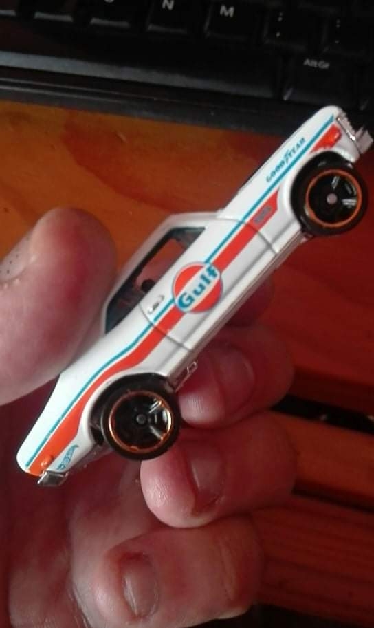

Btw, this is the chevelle that's been unbeatable on my track, it's stock.
