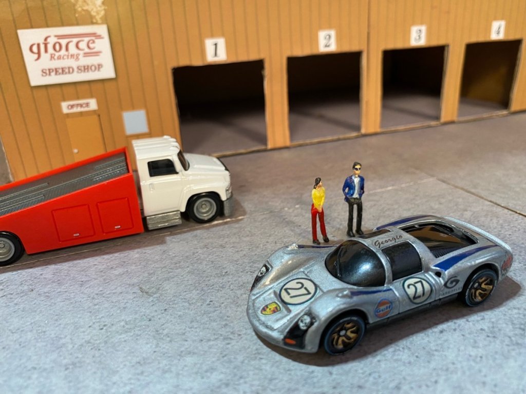

Sometimes  I strip it off, but I sometimes like to keep the headlights or other details, so I'll use masking fluid and paint over the existing paint. Here's an example. I then add a few coats of clear coat to help keep it intact and give it that "just waxed" gloss! :)

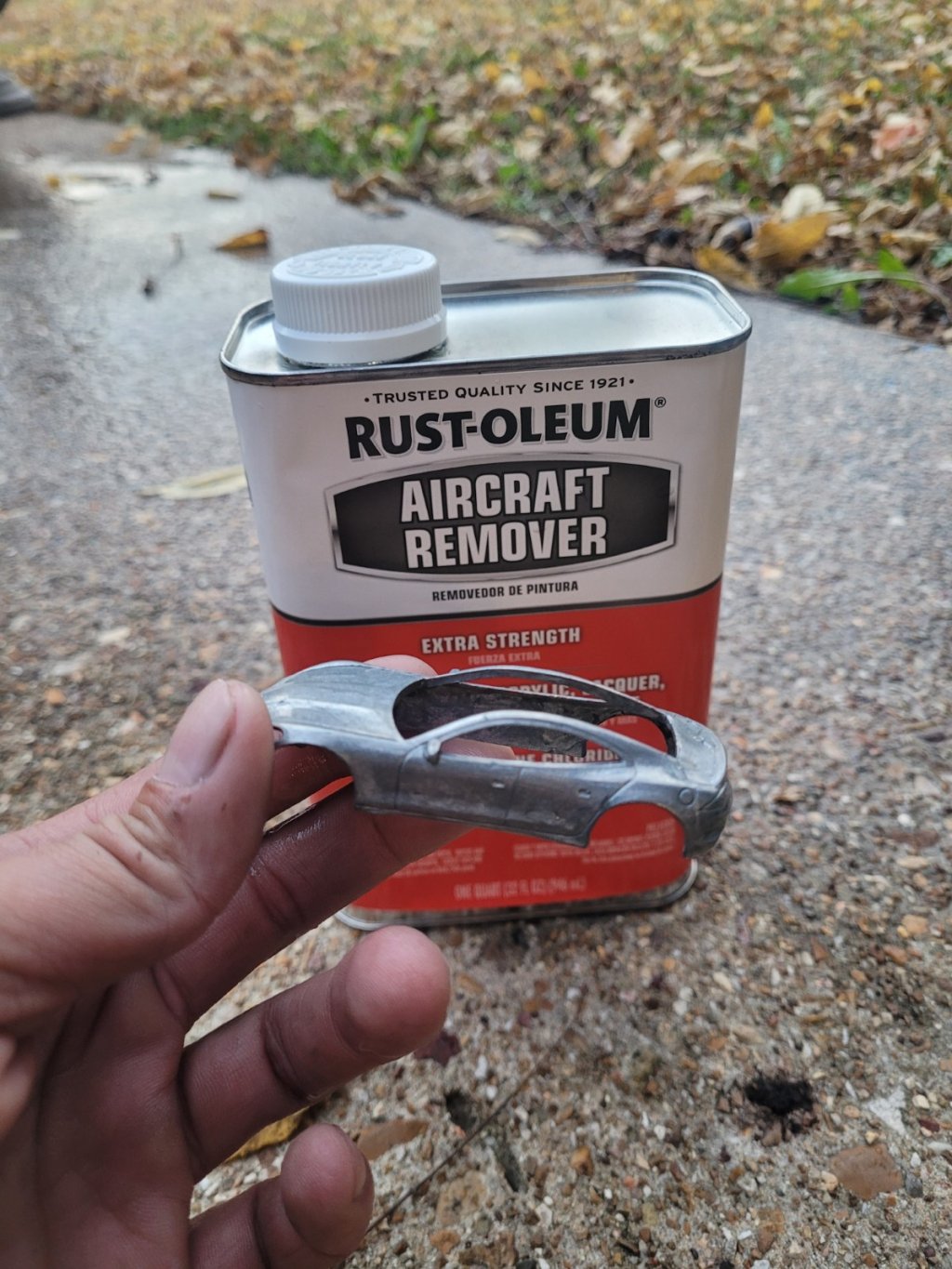

I use this to remove paint. It takes at least 20 minutes to remove paint. I  hope this helps.
  • That’s what I use now. I’ve watched hundreds of diecast restoration and customization videos on YouTube. Danny’s Diecast Disasters and many like him are great for showing what to do and even give you ideas that you wouldn’t have thought of. — Billys_Midway_Racing
  • Thank you both! — LONE_WOLF_RACING
