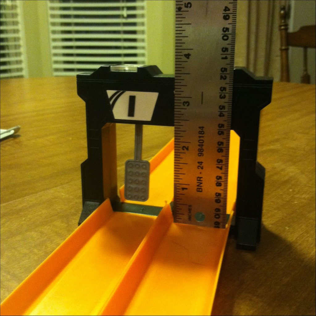

Another bonus about this finish line is the clearance height is about 2 ¼ inches so this gate is well suited for any tall stocks or modded cars. You'll definitely want this for your next Heavy Hauler tournament.

I got mine yesterday...it seems cool! The only thing I have to say is that the 'paddles' don't really swing all the way up, so the clearance might not be that much more than others.

Yeah, the paddles could be a weak point but I'm not sure they're a point of worry...only time will tell. I slammed a ton of cars through mine already in tests and nothing seemed like a problem. Lets just say I trust the Maxx more than the old Mattel V-Drop I was using...that thing was pretty beat up. I got 2 more Maxx Traxxx just yesterday, so I'm stocked.
