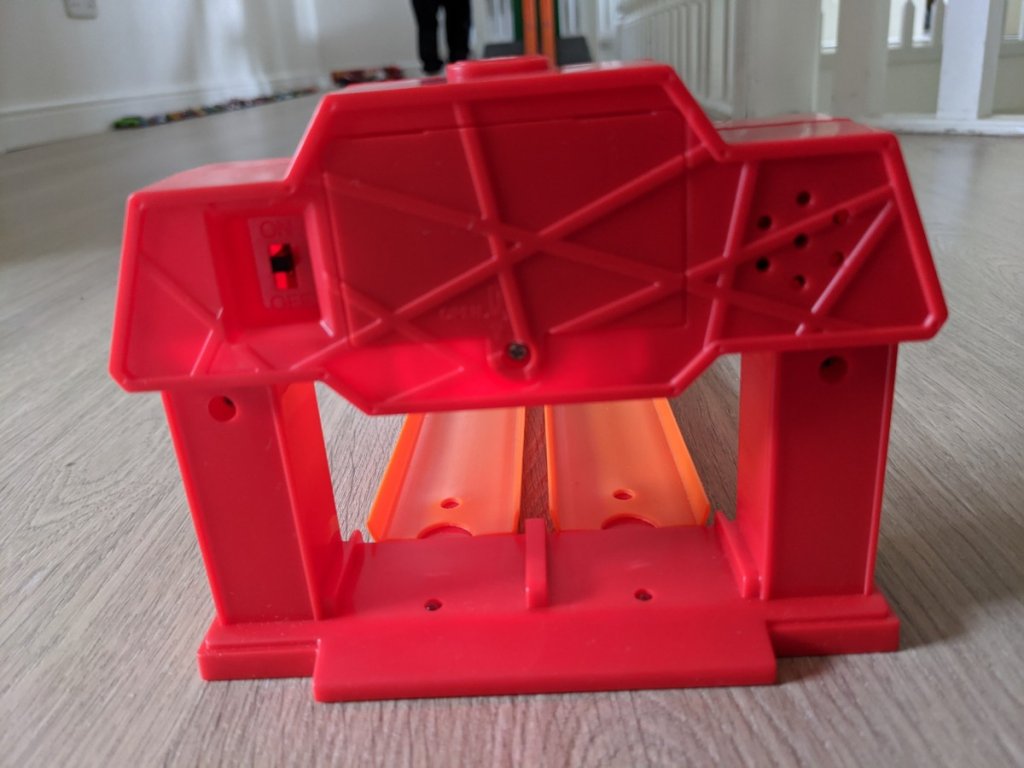

Finish Line
Obviously its just another cheap Hot Wheels imitation with two start gates, a few feet of track, two loops and some generic junk cars. What I was interested in was the finish line.
What you get is a 2-lane battery operated finish line with LEDs to indicate the winning lane and a timer. It is not connected to the start gates in any way. You press the button on the top and it emits a countdown of three short beeps followed by a longer beep. The timer starts on the longer beep, the idea being that you manually release the cars at that time. It then plays some mildly annoying generic F1 style engine noises until the cars cross the finish line, breaking the white light beam in the center of each lane. The first car to break a beam stops the timer, giving you the time of the winning car (to tenths of a second only) and a red LED to indicate which lane won. It also then plays some cheering crowd and camera flash noises. You can't connect track after the finish line - there is just a plastic ramp on the other side.
Now obviously there are issues with this set up. Times will be influenced by variations in the manual release of the cars, which needs to be coordinated manually with the beeps, so it is of no real use for comparing times across multiple runs. Timing to tenths is limiting on drag runs that may only last 2 seconds. And the sound effects are a bit childish and could grate after a while. The inability to connect track after the gate is also a bummer.
However, it does in theory give you a cheap finish gate that will tell you the winning lane even in close finishes. The tabs are compatible with orange track (Teamsterz uses little triangular raised notches to secure its track pieces to corresponding triangular holes in the track pieces but any orange track will just slide over these). The countdown beeps actually add a bit of drama, and the engine noises are mostly drowned out by the swish of the cars going down the track.
Of greater concern is that occasionally it simply fails to register a car breaking a beam and I can't immediately work out why that is. The car must be breaking the beam as it passes through and the material the car is made of shouldn't affect that. A car might fail to trigger the gate one time but trigger it the next, so I am at a bit of a loss to explain it. However, it only happens maybe one out of 30 runs and seemingly only with certain cars.

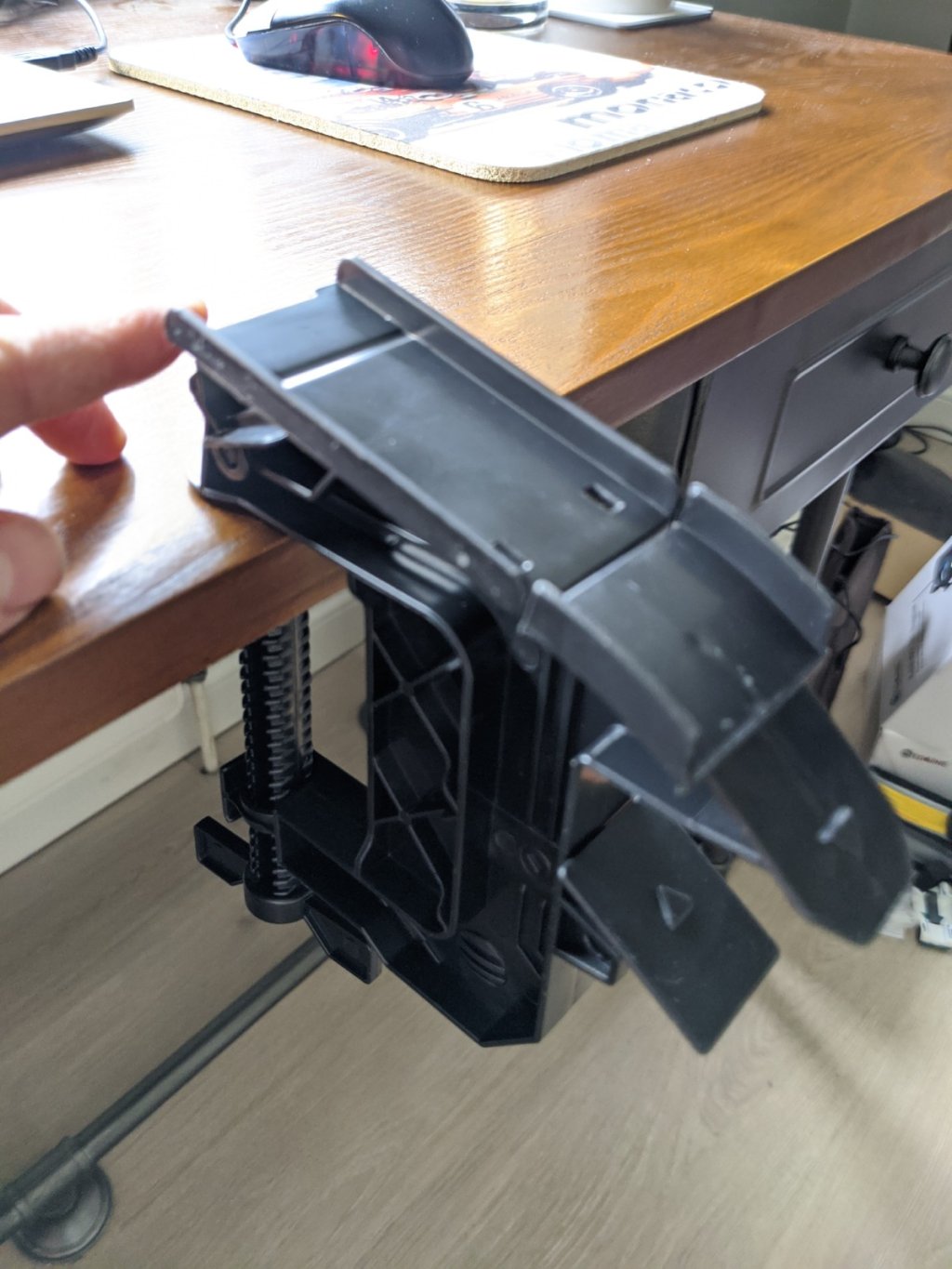

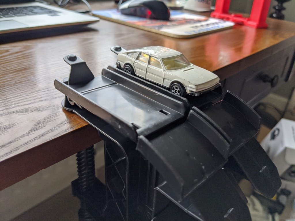

As a bonus you also get an interesting design of start gate ramp in the set, albeit, annoyingly, two individual gates rather than a dual gate. It may be that you could engineer a bar to link the two release levers so that they released simultaneously.

I also prefer the method of dropping the cars this set uses to the yellow HW 4 car launch I currently have. The latter tends to "bounce" the front of some cars as the cam rotates unsettling them on launch, the Teamsterz one makes for better launches. Being a G-clamp makes it easier to attach to thick furniture as well, the HW one doesn't attach nicely to the top surfaces of my IKEA "Billy" bookcases.

Great review, thanks for sharing. Sounds like your typical retail finish line that is better than nothing but far from what we really want. However...what I find most interesting about this set is the fact that it's a sensor finish line, which I find amazing. Typically your retail cheap-o lines are just paddle finishers with LEDs that makes it "electronic" but this is legit. If nothing else, it could be a base from which to build on and mod if you have the notion and the knowledge.
Another good point from what I can see is that it's bottom half is very thin and low profile. One downside of sensor lines (even 3DBM's) is that the bottom sensor bar is rather high off the ground so the track goes up, which probably doesn't impact things much but just feels like it can. Here, the bump seems rather minimal, which is nice.
I mean, even if you bought new guts for it to get better sensors and whatnot, at least you have the structure to build upon, which is sometimes half the battle when building your own.
What's the clearence at the end? Looks kind if low.
