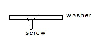

you'll need spacers to screw the washers to a board
  • This is a really elegant solution. I can see how to install this on my own track bed, pretty easy. I only need a flat screw, a small washer for spacing, and then the 1 inch washer above that. Thank you. — StarCorps
  • Though - I did hear you say 'counter sunk' on the washers. I don't quite understand, as they are supposed to protrude? — StarCorps

dr_dodge 6/27/23
washer, and countersink head screw
1" washers,  take track with you, make sure the screw doesn't push the track up, and the washers are tight in the slot
