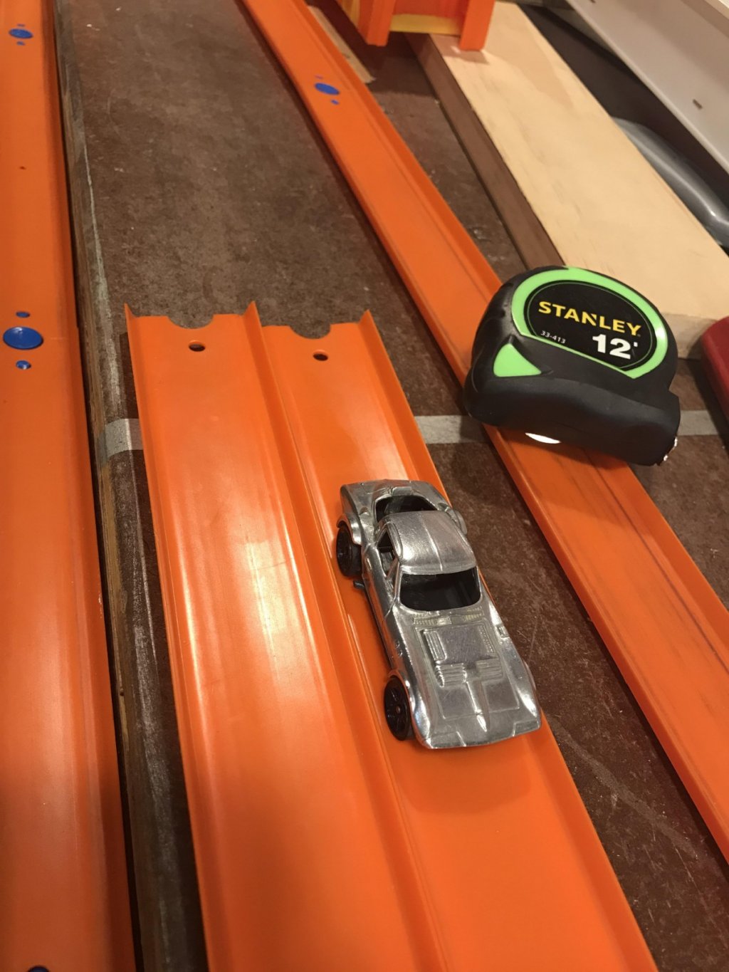

I'm having a problem getting my orange track to sit straight and level. I'm trying to make both lanes equal and fair but cars just randomly fall off. I think it's because the track is twisting to the outside. I'm in the process of rebuilding from scratch so I'm asking; What do you use to hold down your orange track and keep it level?
I've gotten suggestions of velcro and plaster washers but neither sounds like a secure way to hold the track. What do you recommend?

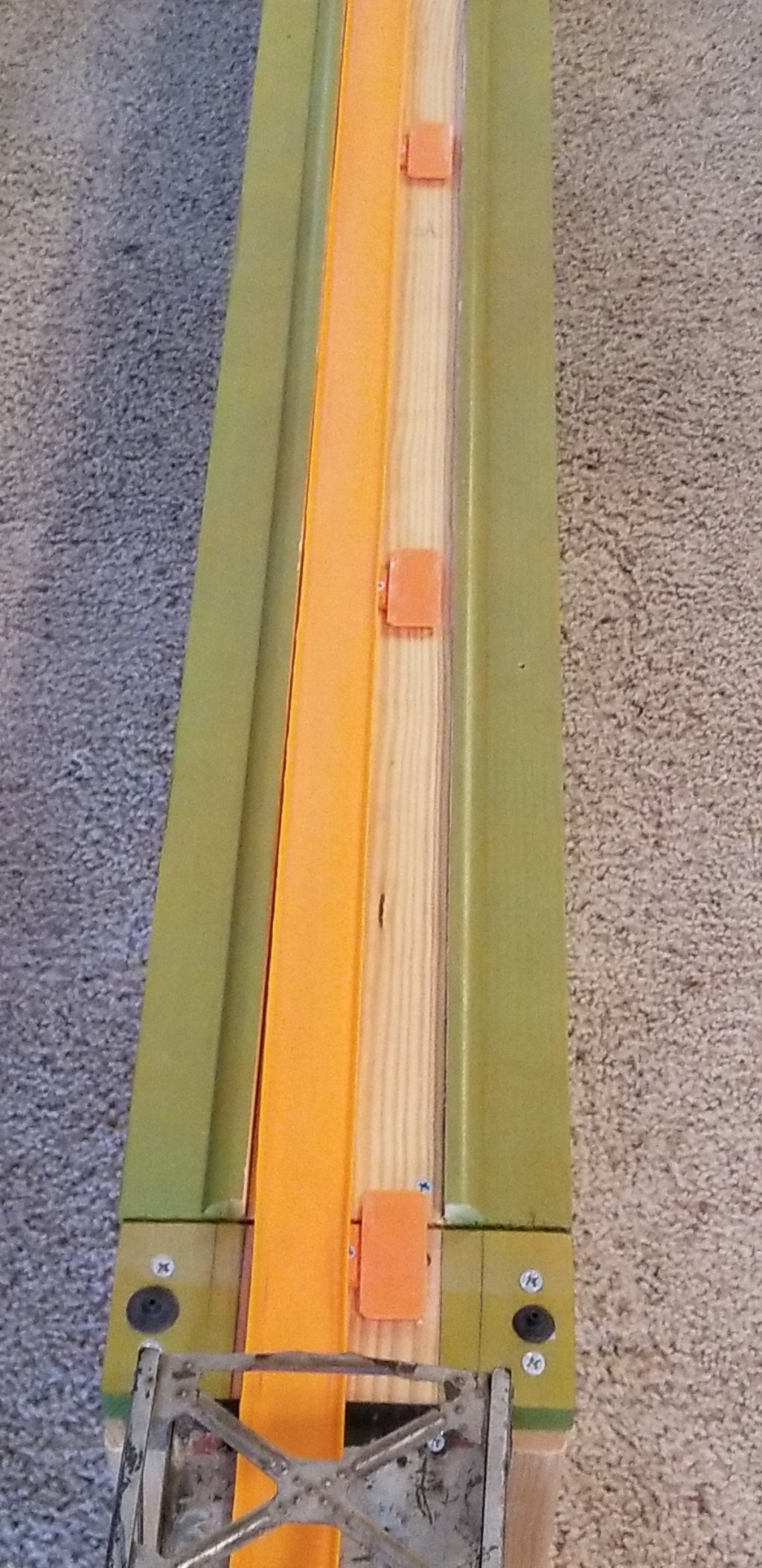

I've not tried popsicle sticks or washers tho they would likely work great. I bought some of 3DBotmakers track joiners and screwed them to the boards that make up my track and ita been solid since.

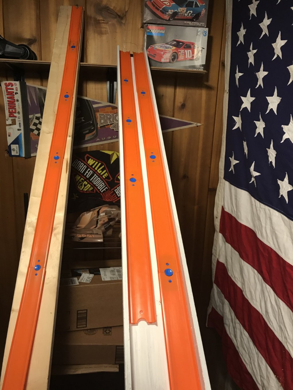

On the right is the mockup with sidewalls

...and Bootleg Run uses 3D'S dual lane connectors
- Hey do you notice the cars bouncing/jumping over the connectors or did you have to route out a hole to recess them like I did? — Mattman213

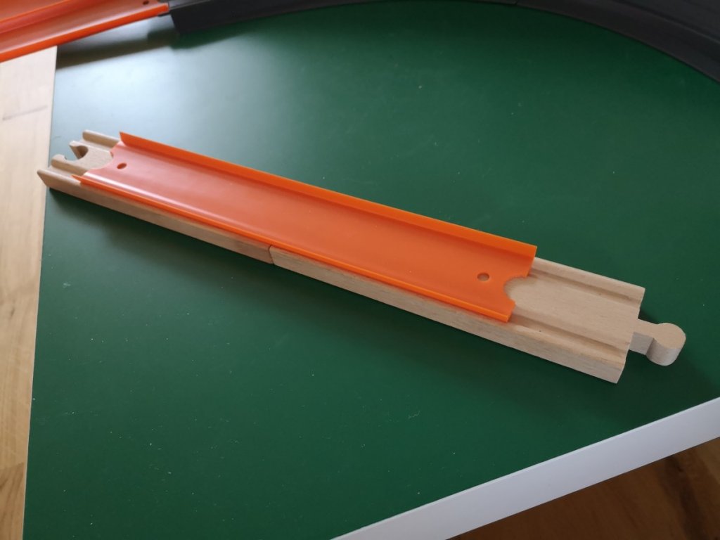

Not sure if it would prevent twisting but I recently discovered that orange track sits quite nicely in the "rails" (i.e. grooves) of classic wooden toy railway track. It just has a mm or two of movement side to side. Only problem is there isn't room for the orange track connectors without it raising up slightly.
