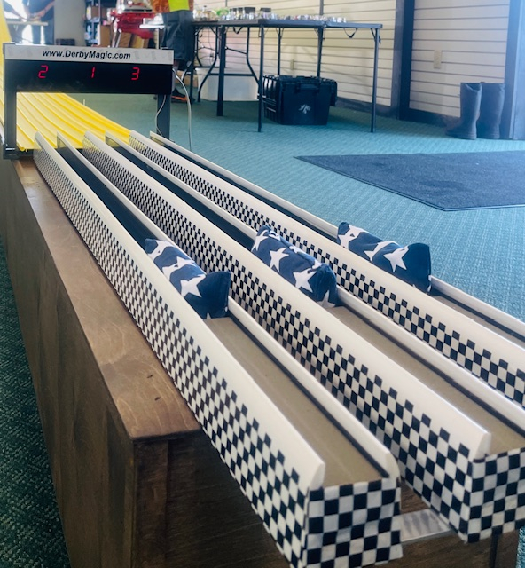

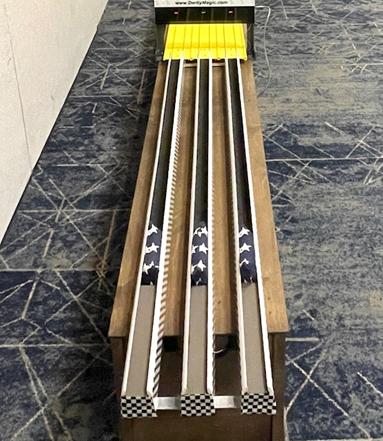

Here are a couple photos of the stop lanes I use on the Buckeye Mountain Raceway. It's basically three enclosed woooden lanes that are slightly wider than the track lane width. I screwed cheap PVC baseboard moulding onto the sides of the wooden lanes for the side rails. The bottom and sides are lined with self adhesive velcro (the soft "loop" part) and grey foam blocks are on the ends of the lane. The bags with the stars are simply cornhole bags cut down and resewn. There are counter sunk screws that hold the lanes to the track.
It works really well, cars simply plop to a drama-free stop no matter how fast or heavy they are.
