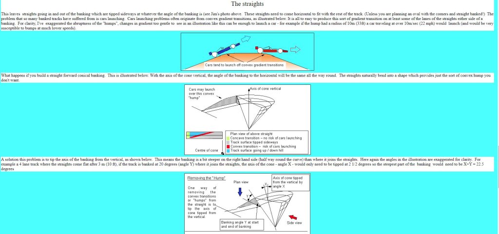

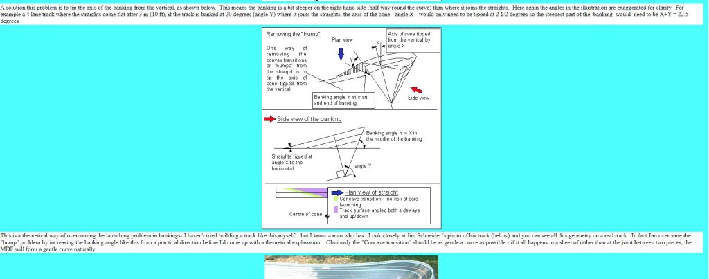

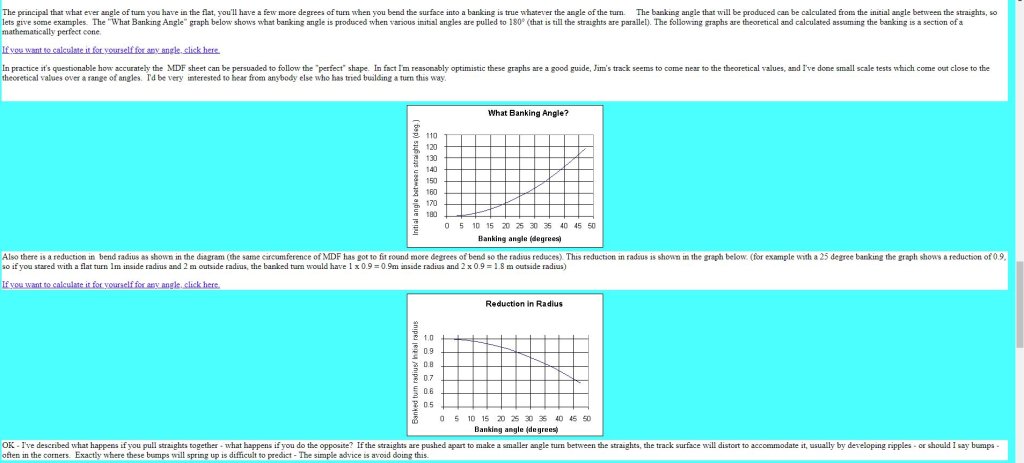

I am into slot cars also, and thought this may be useful
the site is here, and they talk about scratch built track, and the tech to make a fast track
www.slotcarracing.org.uk/trackbuild/bking.htm
they are using MDE for the tracks. has anyone used MDE?
the interesting part is about the transitions (into/out of curves)
think banked drift corner.
I thought that all y'all printing tracks may find the info useful
