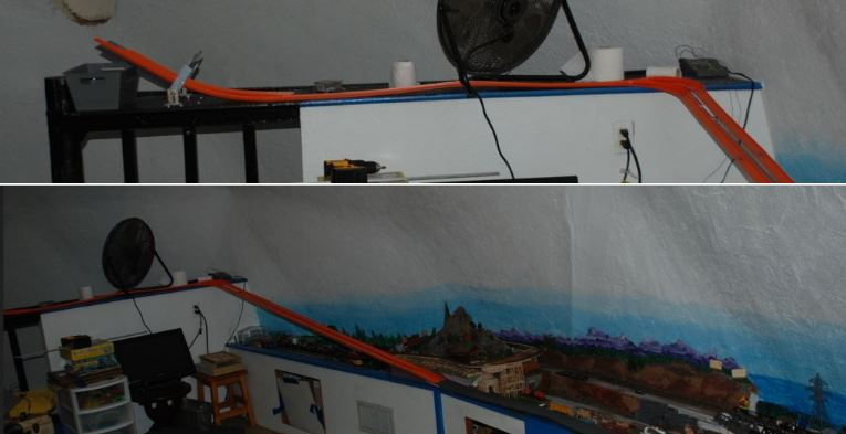

The orange track is like the "barrel" of a rifle. get the bullet/car moving straight with some inertia, then let them go
My Jamestown bypass, made to simulate the hiway around the "backside of town" (my HO train set) uses cheap orange, into some short crash track, and then onto the back of flooring material, which is all level.
The launch, then hump, then curve at the beginning is designed to slow fast cars for the corner, and stop slow cars before the corner.
this makes sorting good potential cars easy,
I have a bunch of vids in the thread, you can see it progress

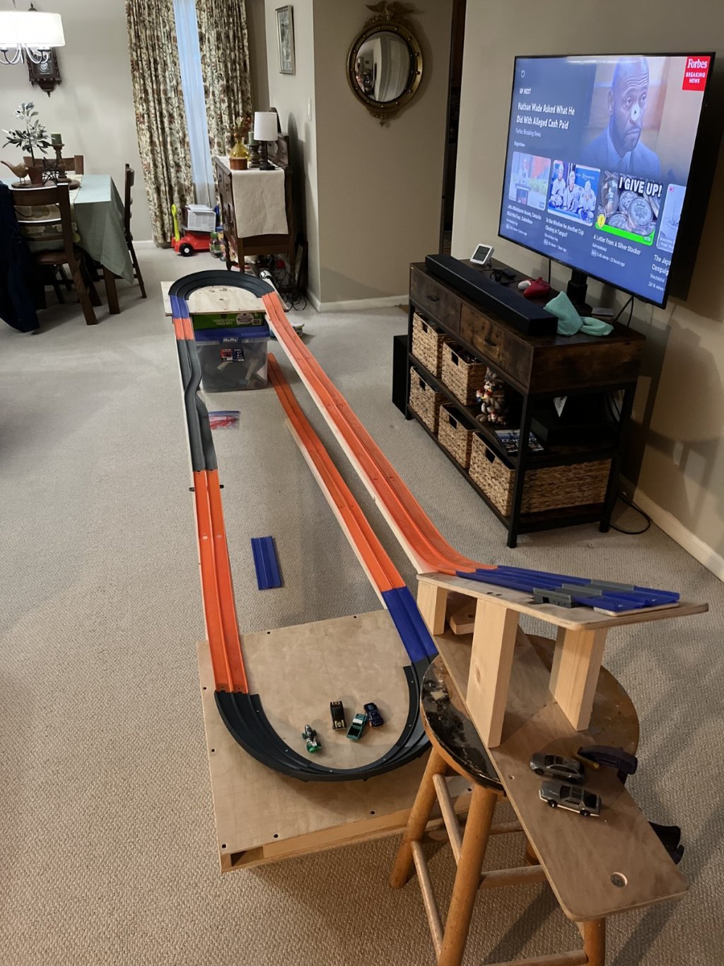

"If they are divided lanes you either need two that are opposite so each car gets an inside lane or some sort of cross over turn to negate the inside lane advantage"
That's the way I have my track set up. I have the turns stacked on each other to save room. The cars come down a 12' stretch into a 180, 10' through the crossover, another 10' two lane 180 and into the crash racers track. When it's dialed in, it's a fast track. The cars seem to accelerate out of the turns. If I can keep the cars from flying off during the crossover, it's a real fun track.

I have 10' of divided track and two open Crash Racers before the first turn, Idea is to have Seperated lanes to build speed without banging. then open and come what may.
