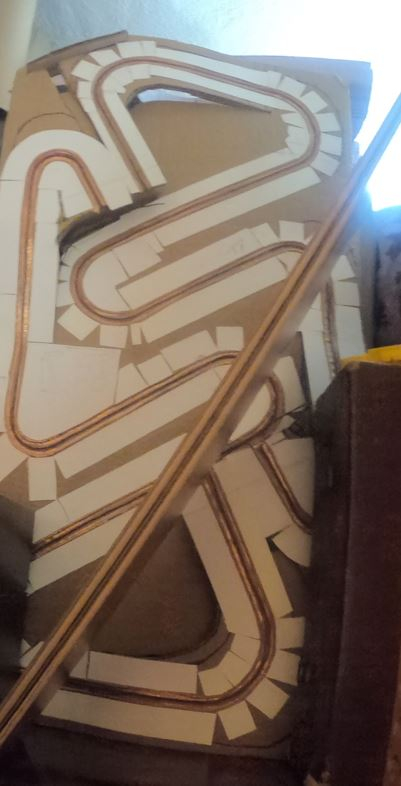

I have experiments in making an "indurtrial paper mache" slot car tracks

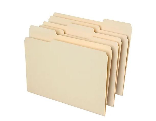

I use minilla folders
you can make an amazingly flat, smooth surface
You use something flat to work in and build it top first, and layer up the back
use straight glue, NO Water!  even to the point of a cleaned dry brush
water causes warping
track below is totally cardboard, folders and high quality thick printer paper
(cars run the flats but I can't get my hiils flat enough for the slot cars,
but hot wheels cars zoom down the hills just fine
