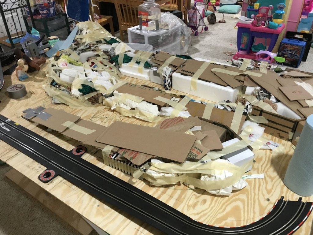

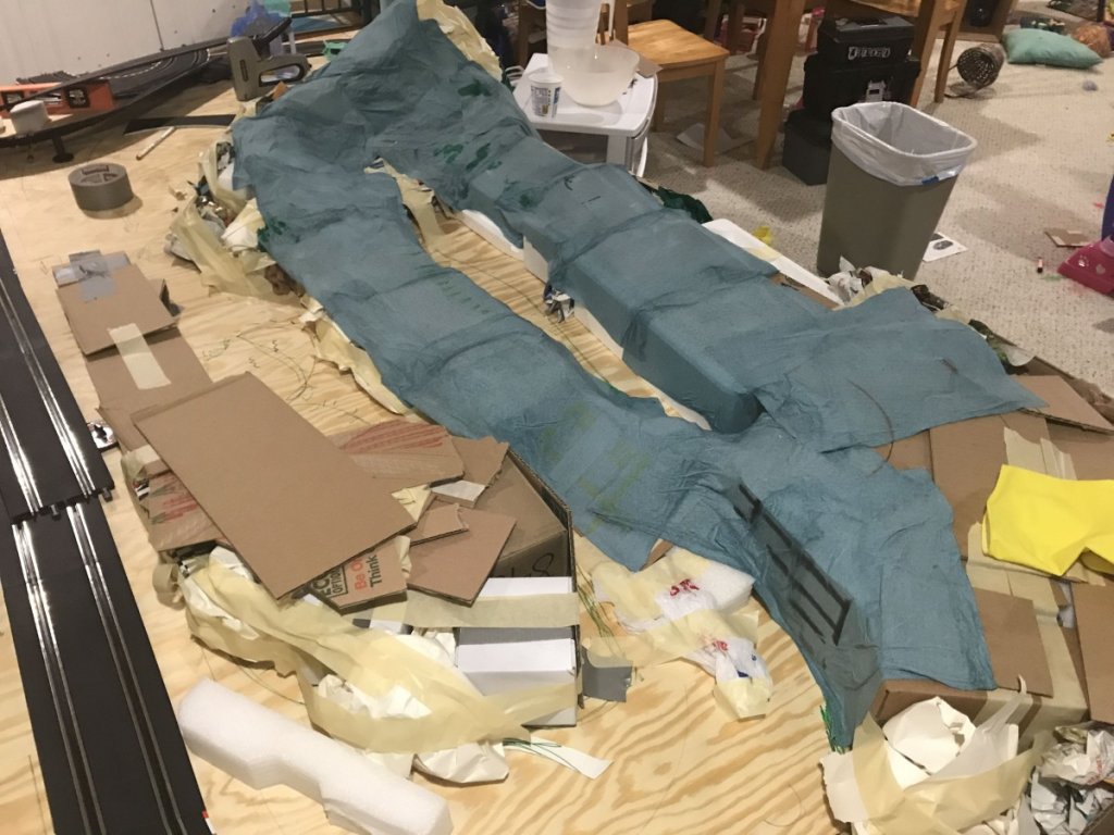

I started with trash. Quite literally...I raided the recycle bin for cardboard, styrofoam, and grocery bags to build up the regions where I wanted hills, mountains, and raised sections of track. You know that scene from Close Encounters...it felt like that.

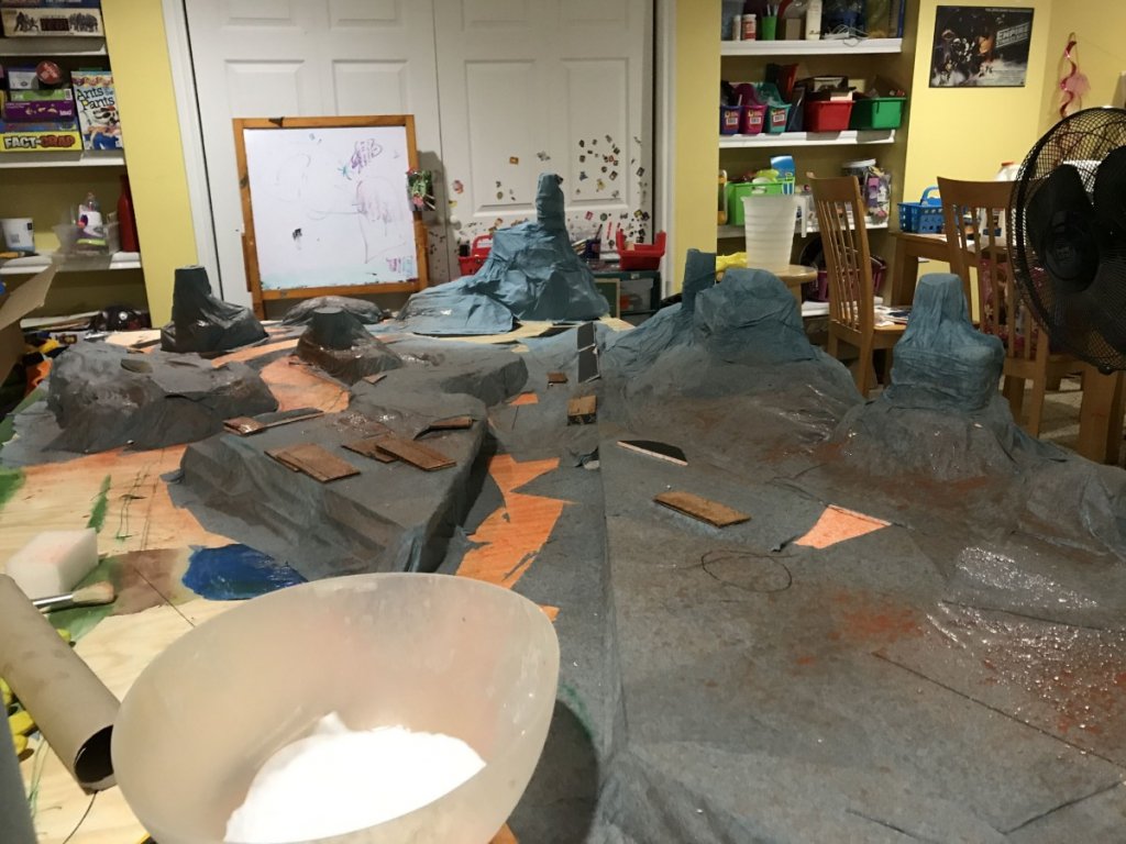

Then it's all water and glue. Next, I took a bowl of water and mixed in plain old white glue until it felt like thick water...almost paint-like consistency. You don't need it very thick, the Blue Towels will hold it well. Just get yourself some dish washing gloves to save your skin.
I dip a towel into the bowl and get it all soaked in, then run it through my fingers to get the excess off. Then just drape the towel over your base and form as you want. No need to hurry either.
I also found that a single layer is often enough for most scenery. Double up here and there where you need some extra support but otherwise the towel is very sturdy once it dries and hardens. It holds the shape great, at which point you can start painting.

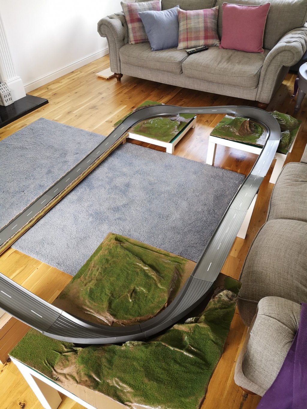

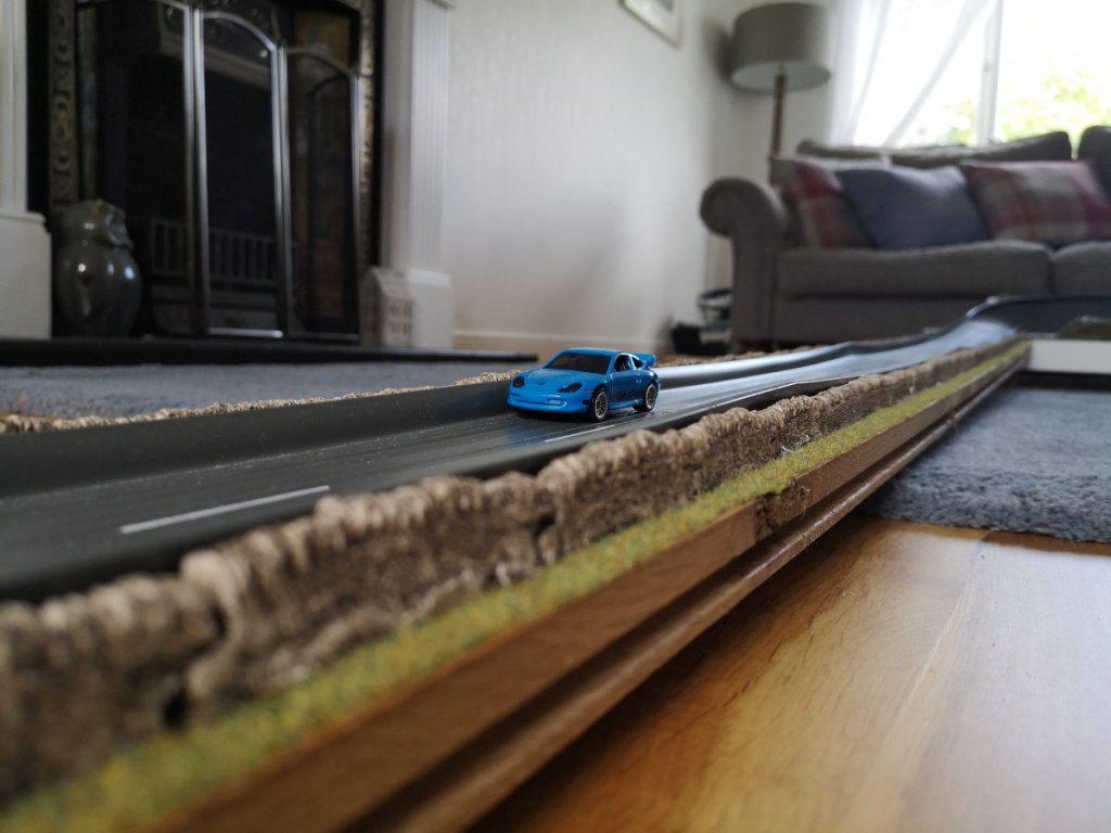

I've never done any modelling or dioramas before but, encouraged by redlinederby's post at the top of this thread, I've had a go, and am quite pleased with the results.

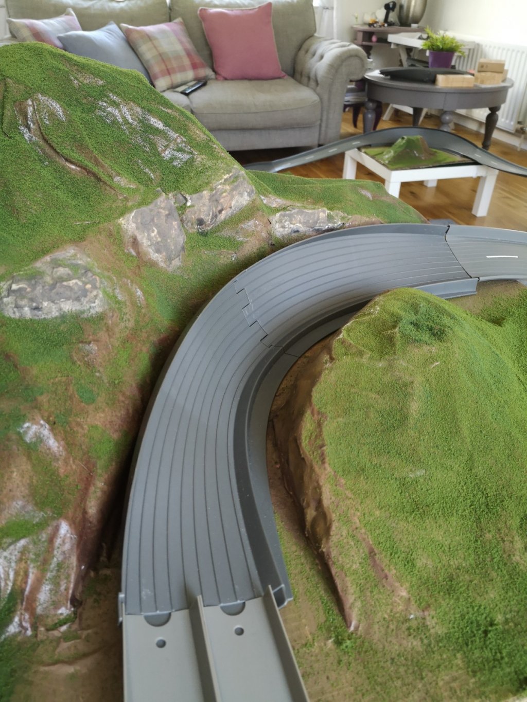

As I am a beginner I got a Woodland Scenics mountain diorama kit (which contains some plaster and rock moulds and other bits and pieces), an extra bag of grass (!) and some earthy coloured brown paint. The structure is just a double layer cardboard base, a couple of cardboard walls, and balls of newspaper. I used sheets of A4 paper dunked in a 50/50 pva glue and water mix. The modelling "grass" which i think is ground up, dyed foam (you spray pva/water and sprinkle it on) adds a lot to the realism.
Only problem I had is that the cardboard bases have curled slightly as things have dried (despite laying two sheets with the corrugation at 90 degrees) so if I was doing it again i'd use something stiffer as a base, but cardboard was all i had available during lockdown.

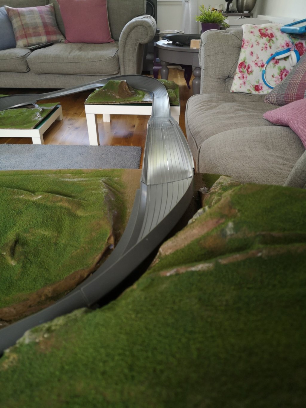

Also found some model railway drystone walls on ebay which go together like jigsaw pieces. Glued onto a plank they act as track guides and are perfect for that British country road vibe! Used a Woodland Scenics road striping pen (and some careful measuring) to add a UK style centreline too.
The piece de la resistance is the mountain top car park. Same techniques plus some fine wet and dry sandpaper for the tarmac.
Only problem is I have no idea how I'm going to store all these scenery boards when the track is down! I've somewhat undermined my easy to put away ethos!
- thats really cool. Good track, Great Scenery. — madmax
- Try putting the 50/50 PVA/Water mix on the bottom of the cardboard. It should help to straighten it out. I've made flock(grass) from sawdust. Mix it with water & paint, let dry, then sift through it. Your track looks good. The scenery makes it pop. — Blipside
