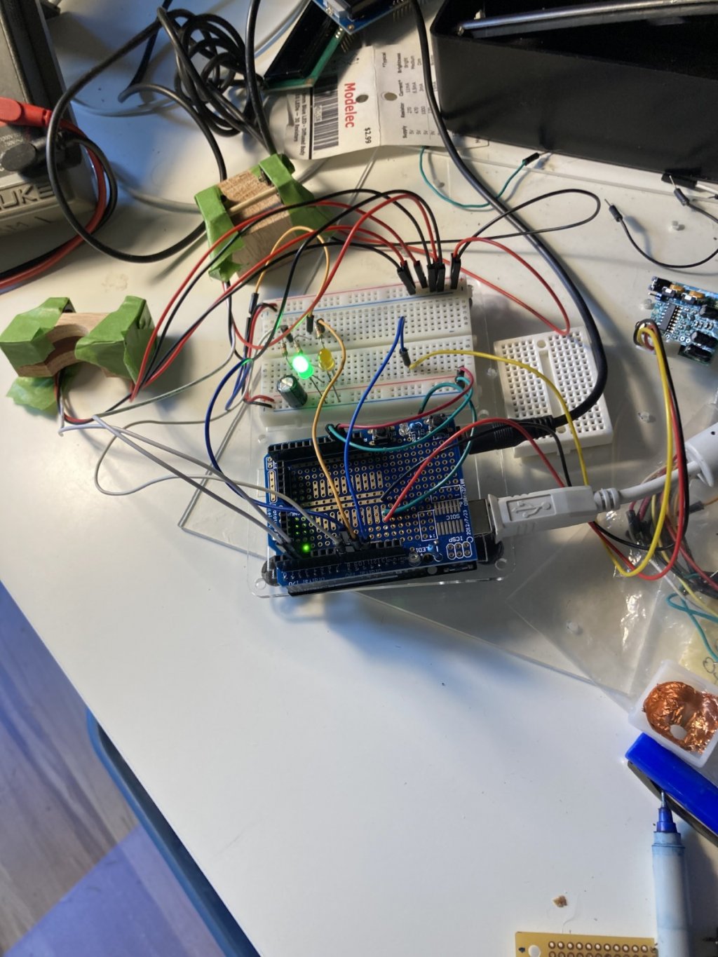

Well moments ago I finally got my prototype track timer working. Two IR beam sensors, a few LEDs, and a motion sensor. I should have the display on Monday of next week. This mainly for being able to time my cars before and after modding. The motion sensor is to reset the timer for another run. Sort of a touch less restart. Still need to adjust the final time format and I want to calculate the speed in 1/64 scale as well.
Next up is packaging all this up neatly.

I love designing start and timer systems with arduino's now. Was very daunting to begin with, but once you get to understand why/how certain things work, it makes it much easier to understand.
To cut down on my wires, my Echo City setup runs two arduinos - one for the start gate and one for the timer - I now have it all down to one arduino and the timer resets when the start button is pressed again to save needing another sensor input. I used two arduinos originally cause I ran out of inputs with the start lights, screen, servo, buttons etc. Now it's a much more efficient setup and all testing worked great.
- Keeping this pretty simple as it’s just for me to get lap times for cars after modding. Each of the trip sensors will be on 8ft of multi conductor for flexibility. Also plan to use a quick disconnect so I can break it down and pack it away as needed. We are limited in space so my test track will need to fit on a 4ft x 2ft piece of plywoood. — AbbyNormal

Well at this point everything looks to be working. Now comes a bunch of soldering and some profanity as I connect long cables to the sensors and package parts of it into a plastic enclosure. Then to obtain and setup a small track. Like many projecs in the past, I've moved on from visions of elegance and beauty to just making the damn thing work.
Yes there was profanity and some minor tool tossing but everything is mostly worked out. The unit is packaged in a box and the display is working. Final step is connecting the sensors via 8ft cables. I still need to rig up some sort of mount for each gate.

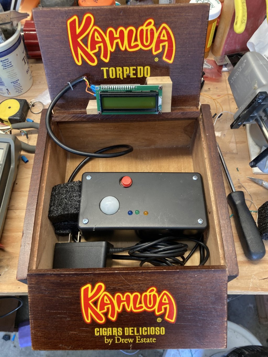

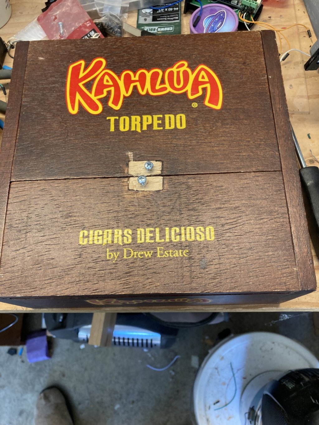

Well sometimes it all works out in the end no matter how many 'surprises' there were in the project. I was able to repurpose a cigar box into my new portable timing system. The End.
- Nice work!!! — Dutch_Clutch_Racing
- My wife said - Becareful where you open that because it looks like a bomb — AbbyNormal
- very nice — dr_dodge
