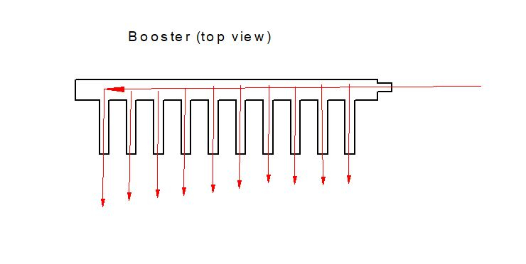

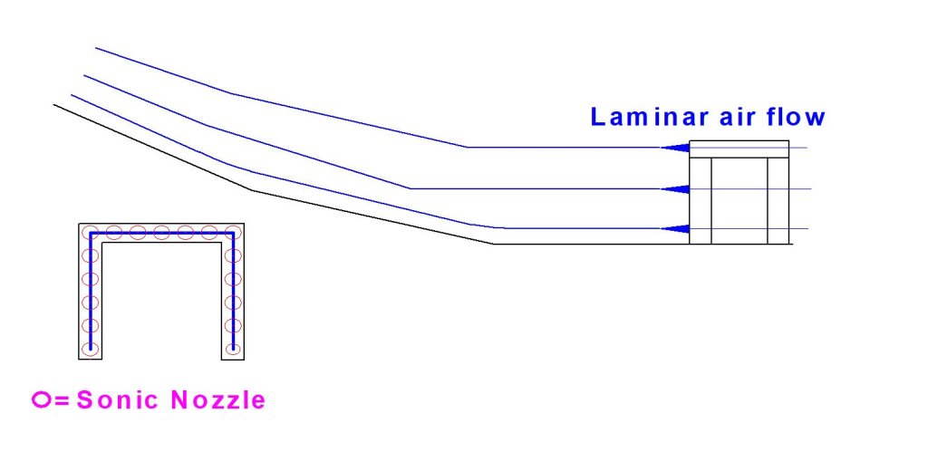

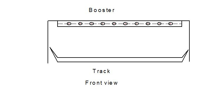

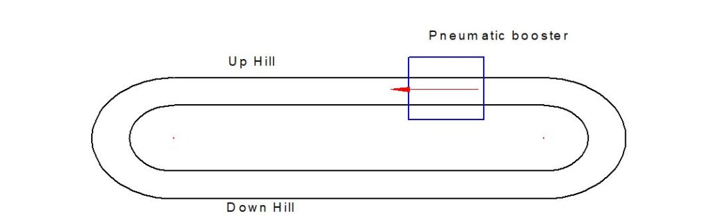

Inducing the airflow around the cars vs blowing the cars
the air around the track is what moves the air under it
the gate has a bunch of tubes, that send air above sonic velocity
flow is (generally) controlled by the pressure at that point
flow against a surface tends to want to stay there
under (I think) 15°
man, wish I knew an engineer...lol
I have been toying with this idea for a while
send the cars aound, 5 laps, bump the pressure, and count how many laps you survive
diags below,
I see a couple of issues with using air as a booster.
First up is if the car isn't in the centre of the track and facing straight, then you will likely end up just blowing the cars sideways and possibly spinning. The other would be the required airflow to boost the cars uphill that distance would require a massive volume of air and be insanely loud - think of a bunch of leaf blowers running at once.

- you, good sir, never cease to amaze me, I look at lots of vids every night, and never saw those. (still my rookie year, and finding this place) that's unbelievably more cool than that giant monster art thing. (and for the record, I think a laminar booster may work) it doesn't blow the cars, just the air around, nascar cars have a tall flat ass, limit it to nascar like builds, and (like nascar) a max height spoiler on a big "slingin' oval/trioval — dr_dodge

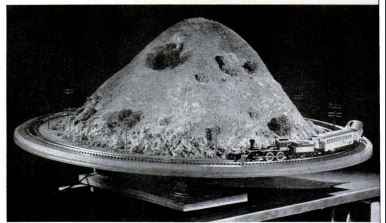

spin the track? just brain storming,
www.americanflyerdisplays.org/promotional/PopSci-Rotating%20Layout.pdf
