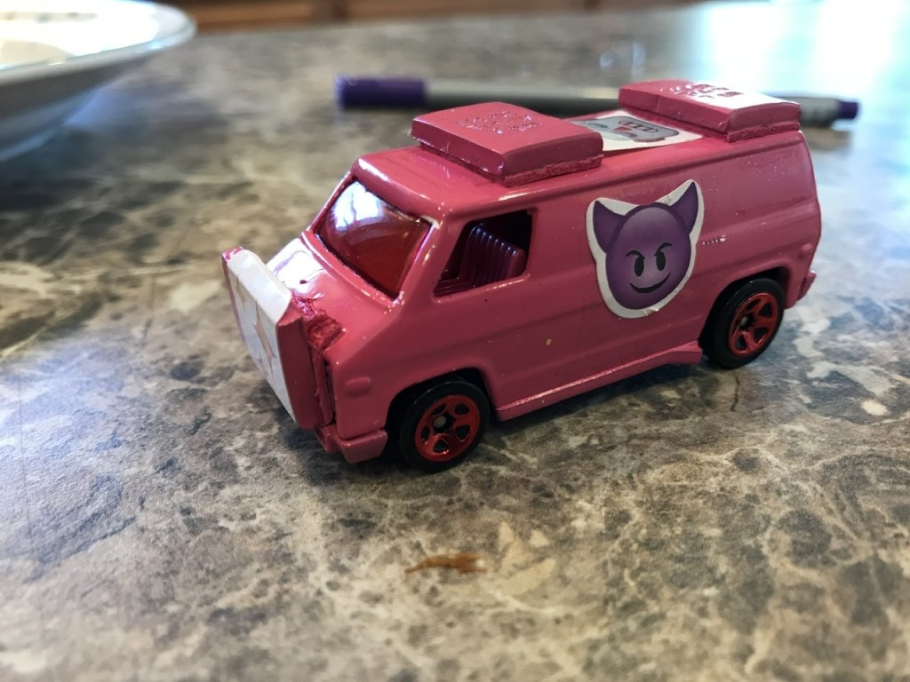

I just wrap the wheels with masking tape and then spray paint. Works well enough if you're careful and liberal with the tape.
I just did it for the upcoming Pink race.

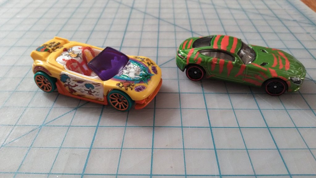

I find when doing a custom paint job on a stock, it's easier/safer to keep it simple and work with the existing paint job. On the left here, is one I did for Indiana Diecast Racing. I hand-painted a coat of white enamel down where I wanted to do the decals and added some quick-and-dirty detail paint too (because sometimes I don't know when to stop). You could obviously hand-paint more than I did, but you get the idea. Decals are also your friend.
On the right is just detail painting over the existing paint job. It's a lot of stress going that close to the windows and wheels, but if you have a fine brush and a steady hand, you'll do great!
Also, you can remove existing tampos with acetone nail polish remover on a cotton swab. Here's one I'm currently modding for Pinks for the Cure:
Nice thing is, I was able to remove the ones I didn't want (on the side, used to say "Spring 2020") and leave the ones I liked.

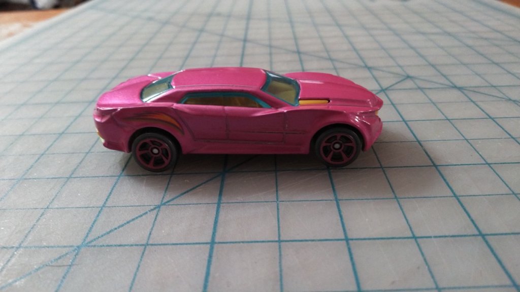

pupulesurfer 9/20/20
Masked off the windows and wheels. Seems to have gone very well considering it was my first go at it!
Thanks again all! Disassembling will be the next attempt as that seems way easier than what I just tried lol!
  • Nice work. Looks good. — Chaos_Canyon
  • Thanks! — pupulesurfer
  • This car came in yesterday, and I gotta say, it's impressive how good it looks for having been painted without cracking it open. Way to go! — GenX_VintageRacing
  • Thanks! Glad you like it! Now I just hope it runs...the rear driver side tire likes to be finicky! — pupulesurfer
  • Gorgeous!! — G_ForceRacing
