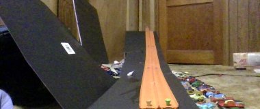

This build will be an Open Track design using Sizzler Fat Track, it will use some of the design techniques of Bootleg Run and will be set-up in the same location as well, the new 3D Botmaker Fat Track Start gate will be used and 3 single lanes will feed 3 cars into the Open Track section known as the Tail of the Dragon, where the cars will negotiate 4 180 deg turns that stage down to a Bottleneck Finish. I base most of my names and track back stories on places in my home state of North Carolina, this track is no different...the influence for this track is a road the Lady of Speed and I have run in her '96 300ZX during one of our visits to Z DayZ....the place...Deals Gap, NC....the road...Tail of the Dragon.

This video will give some hint at the possibilities that lie ahead for Tail of the Dragon, as the only momentum is the Drop off the 6 Lane Raceway and the rest is flat Fat Track on the floor and the cars lose momentum by the foot, it's also 3 wide racing as well....Tail of the Dragon will stage down 4 times, I believe I'm on the right track....for the track.
