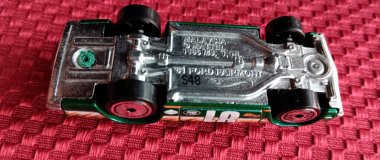

dr_dodge 5/3/23
this is one of my weight experiment cars
(I am testing heavy vs light)
it weighs a not very massive 28 g, but is very fast
it's an autoworld HO slot cat body on a diecast bottom
