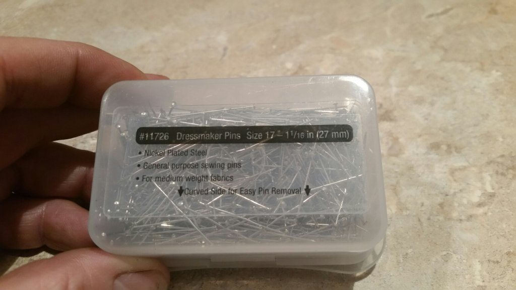

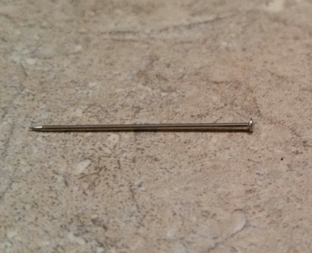

Okay guys, if you are up for a little experimenting! I've been messing around a little with these sewing pins as axles. A #17 pin is .73mm as opposed to .8mm the an fte axle is...so, the fit on the wheel is a little looser than I really like. But, having a loss fit on the wheel automatically gIves you some negative camber...which works out pretty nicely. Oh, and they are nickel-plated!
The canary yellow 'Speedy' Bywayman square body Chevy that I ran in the Muscle Truck race had these pins for axles. It was not the quickest, but, it held it's own pretty well.
I think I bought that box of pins in Walmart for around (or less, I forget) $5...and you get about a ba-gillion pins (okay, like 500)...so, from a cost standpoint, they are WAY cheaper than buying donar cars for the axles.

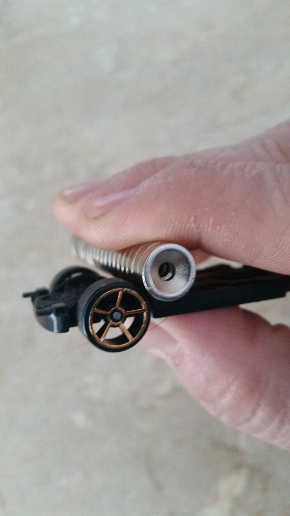

I'd say two (2) are used for one axel utilizing an axel tube....that would be my guess?

Just a question regarding this thread... where would one find axle tubes. I live in a small town in Canada and my options for buying hot wheels and donor cars are limited. But if you guys are having success with the sewing pins, it may be an option for me if I can get my hands on the axle tubes. Thx for the help
Hobby stores sell the copper tubing...see you at CC Rider's place this month.

This is what you are looking for...

I tried the hat pins as axles a long time ago and while they were the right size, my issue was getting proper ends on them...the part that stops the wheel from flying off. My pins didn't have the nice ends that yours do...guess I need to find some that do. Are you using them with tubes then?
I'd love to find a way to take those pins and add an end to them so I can just avoid tubes all together. There's gotta be some way...bead of solder maybe? One of those teeny tiny washers against the wheel then something on the outside...hmmmm
Brian, there is a fella on youtube; Poochefmarowbe is his channel. He has a tutorial on using bead craft crimp tubes on HW axles and also the piano wire axles. The correct size is 1.5 mm. They are a gentle press fit but can also be glued on for racing. They can be purchased at WM, Michael's, Joann's etc... They are like $1.99 for 50 pcs. I do not have any experience using them in any races here but would like to fiddle with it at some point.
