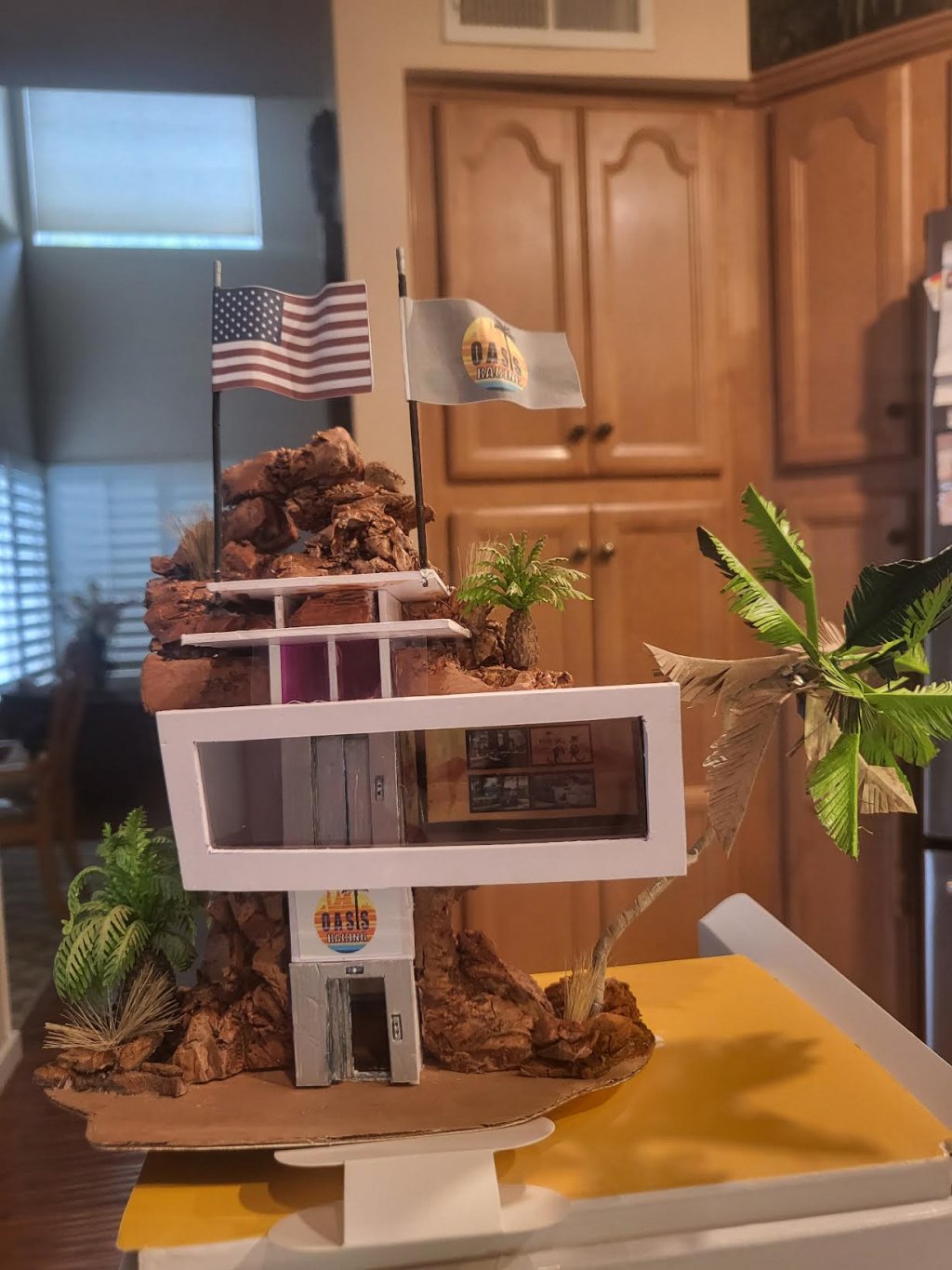

I prefer the insulation pink foam board. Here is my announcer's booth using it with acrylic paint. Thunder Mesa Studio is a huge inspiration along with Black Magic Craft and Wylock's Armory, this guy is a wizard with just cardboard. I am also building my city and other buildings with coffee sticks etc. Great Ideas.
- I have a whole collection of plastic stir stick, and my daughter worked at starbucks, and I bought a case of the wood ones, and use all of it — dr_dodge
- very nice work! — dr_dodge
- also, love the palm trees — dr_dodge
- I like that. Thanks you! — ManiacMotorsports
